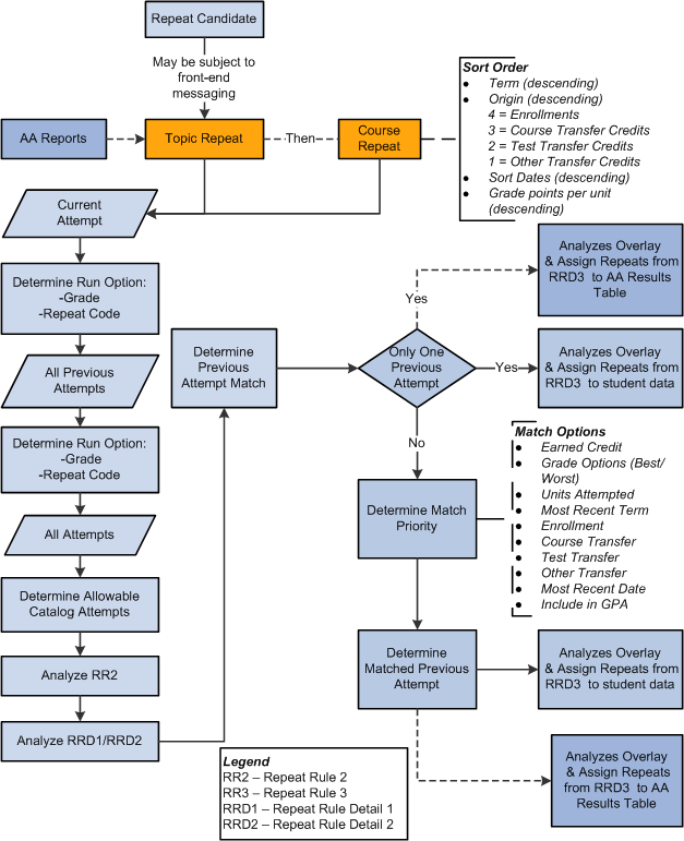

Image: Repeat Engine logic
This diagram explains the Repeat Engine logic:
Repeat Engine logic
