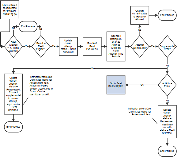

Image: Resit Eligibility Evaluation
This diagram outlines the resit eligibility evaluation process.

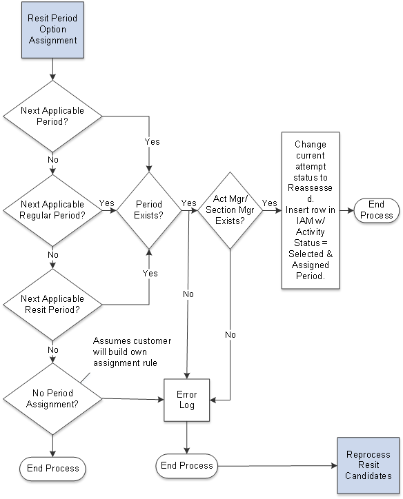

Image: Exam Period Assignment
This diagram outlines the exam period assignment process.
