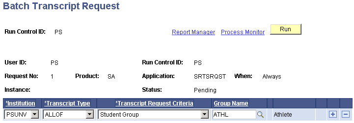

Access the Batch Transcript Request page ((Records and Enrollment > Transcripts > Batch Transcripts > Batch Transcript Request).
Image: Batch Transcript Request page
This example illustrates the fields and controls on the Batch Transcript Request page. You can find definitions for the fields and controls later on this page.

Institution
Select the institution for which the transcript type is associated. Add rows as necessary. When you run the process, the system creates a transcript request number for each row within the process instance. Institution values are defined on the Academic Institution Table page.
Transcript Type
Select the transcript type. Be sure you select a transcript type with the correct detail organization that you want to appear on the transcripts. You can organize by academic career or chronology. Academic advising reports can include both an advising report and a regular transcript. When transcript types have the Advising Report check box or the Special Advising Report check box selected on the Basic Data page, the transcript includes an audit of academic requirement groups. Transcript type values are defined on the Transcript Type - Basic Data page.
If you select an advising transcript type, the Use Stored What-If, Database Report, and As of Date fields become available for entry.

Transcript Request Criteria
Select batch processing criteria and further describe the group. Select one of these values:
Academic Level: If you select this option, the Career, Term, and Level fields become available for entry. The values in all three of these fields intersect to form a single criterion set.
Advisor: If you select this option, the Advisor field becomes available for entry.
Career/Program/Plan: If you select this option, the Career, Acad Program (academic program), and Acad Plan (academic plan) fields become available for entry.
Student Group: If you select this option, the Group Name field becomes available for entry.
Career
Creates transcript requests for all students within the academic career you specify. Academic career values are defined on the Academic Career Table page. This field is required.
Creates transcript requests for all students within the academic career and academic program that you specify. Academic program values are defined in the Academic Program Table component.
Creates transcript requests for all students within the academic career, academic program, and academic plan that you specify. Academic plan values are defined on the Academic Plan Table page.
Term
Creates transcript requests for all students that are term activated in the academic career and academic level as of the term you specify. Term values are defined on the Term Table page. This field is required.
Academic Level
Creates transcript requests for all students within the academic career and academic level as of the term you specify. Academic level values are defined on the Academic Level Table page. This field is required.
Advisor
Creates transcript requests for all active students who are assigned to this advisor on the Student Advisor page. This field is required.
Group Name
Creates transcript requests for all students who are active within the group that you specify. Student group names are defined on the Student Group Table page and assigned to students on the Student Groups page.
Click the Run button to run this request. When you click the OK button, an Application Engine process scans the database and creates transcript requests for the students who match your selection criteria. When the Run Status for SRTSRQST process is Success, you can generate the transcripts on the Transcript Generation page. Be sure to click the Message Log link on the Process Detail page to note the system-generated transcript request numbers. You need these numbers to generate transcripts on the Transcript Generation page and to print transcripts on the Transcript Print page.
