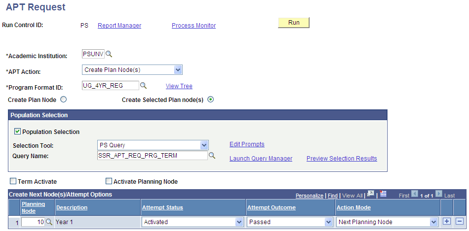

Access the APT Request page (Records and Enrollment > Program Enrollment > APT Request).
Image: APT Request page
This example illustrates the fields and controls on the APT Request page. You can find definitions for the fields and controls later on this page.
APT (Academic Progress Tracker) Request page

APT Action
These actions determine how the APT Request process (SSR_APT_REQ) builds a new APT instance or interacts with an existing instance. Select an action:
  • Create Instance: Builds a new APT Instance by creating a header record (SSR_APT_HDR) containing the keys and other high level data for the instance. This action emulates the processing that occurs as a result of an Admissions program activation or from the Student Program/Plan component. This action updates the student program/plan stack with the instance number.
  • Create Ins and Plan Node Attempt: Creates a new instance and builds on the first planning node attempt, along with any child program format tree nodes as well as any other items for which the Automatically Move to APT check box is selected on the Enrollment Category page. This action updates the student program/plan stack with the instance number.
    See Setting Up Enrollment Categories for Program Requirements
  • Create Plan Node(s): Builds out the next planning node or specified planning node of the program, depending on whether the Create Plan Node or Create Selected Plan Node(s) option is selected (see documentation later in this section). The process creates the planning node item and attempt along with any items (for that node) for which the Automatically Move to APT check box is selected on the Enrollment Category page. The next node is the next node in the student’s program after the current or maximum node in APT. For example, if the program planning nodes are defined as years, node 100 (year 1), 200 (year 2), 300 (year 3) and the maximum node in APT is currently 200, the next node is year 3 (300). When you select this action, the Create Next Node/Attempt Options grid becomes available.

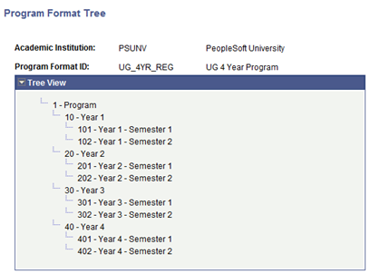

  • Activate Planning Node: Sets the Attempt Status field (on the APT Items page) to Activated for the items representing the planning node and child program format tree nodes. For example, with a program format like this:
    Image: Program Format example for APT (Academic Progress Tracker)
    This example illustrates the fields and controls on the Program Format example for APT (Academic Progress Tracker). You can find definitions for the fields and controls later on this page.
    where Year is the Planning Node, this action would activate the Year and both of its child Semester items. Activation occurs on the current planning node in APT: that is, the maximum sequenced planning node with an attempt status equal to null.
Program Format ID
This field prompts against the Program Format Table for the selected institution. Use the View Tree link to view the Program Format definition. The value that is selected here serves as a high level control for the run control. Only students (identified by the population selection or entered manually) in programs with a matching program format ID are considered for processing.
Create Plan Node
When this option is selected, the APT request process sequentially identifies which planning node should be created for a student. For example, if the student's program format has four planning nodes, 10, 20, 30 and 40 and the action is Create Ins and Plan Node Attempt, the process creates the lowest planning node ID, 10.
This option is selected by default.
If this option is selected, the user must identify which plan node (within a Program Format) should be created for the run. This allows planning nodes to be created in a user defined order when necessary.

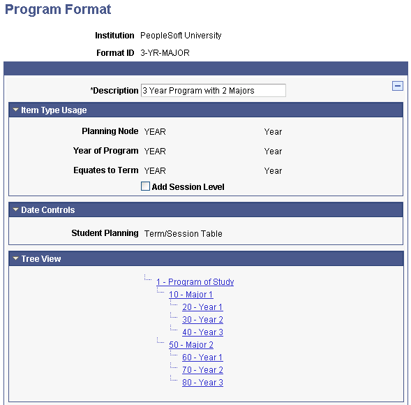

For example, you could define a Program Format where it is necessary to create and activate multiple planning nodes at the same time. Refer to the following example.
Image: Program Format example Create Selected Plan Node(s)
This example shows a dual major program format, where planning nodes (years) are defined under each major:
The Create Selected Plan Node(s) option can be used to identify, create and activate each year for each major. To activate the student in Year 1 for both Majors, Node IDs 20 and 60 would be specified.
Population Selection
The Population Selection group box is a standard group box that appears on run control pages when the Population Selection process is available or required for the transaction. Selection tools are available based on the selection tools that your institution selected in the setup of the Population Selection process for the application process and on your user security. Fields in the group box appear based on the selection tool that you select. The fields behave the same way from within the group box on all run control pages and application processes. If your institution uses a specific delivered selection tool to identify IDs for a specific transaction, you must use it.
Field or Control
Definition
Selection Tool
Select External File or PS Query.
Query Name
The following queries are delivered as samples:
  • SSR_APT_REQ_SAMPLE (prompts on Institution only).
  • SSR_APT_REQ_PRG_TERM (prompts on Institution, Academic Career, AIR Program item ID and APT Cohort Term)
When you create queries for use with APT Request, you must use the bind record SSR_APT_PROG_VW.

Manual Selection
Field or Control
Definition
Academic Career
Enter a valid academic career for the institution/student combination.
Student Career Nbr
Prompts against a view of the student’s program stack for the selected ID/Academic Career.
Academic Program
Enter a valid academic program value for the student.
APT Instance
If the APT Action is Create Instance or Create Instance and Plan Node Attempt, this field is not displayed and defaults to 0. For other actions (where the process acts on an existing instance) the APT instance number attached to the selected Student Career Number will default.
Activating Terms and Planning Nodes
Field or Control
Definition
Term Activate
When this check box is selected, the process term activates (that is, creates student term/STDNT_CAR_TERM rows) for all terms within the planning node. This check box is available for all APT actions except Create Instance.
When this check box is selected, the process activates the planning node (and any child program format tree nodes) as they are created. This check box is available when the APT Action is Create Ins and Plan Node Attempt or Create Plan Node(s).
Create Next Node(s)/Attempt Options
When the APT Action is Create Plan Node(s), the Create Next Node(s)/Attempt Options grid becomes available (as in the page example above).
Field or Control
Definition
Planning Node
Available only when the Create Selected Plan Node option has been selected. Select a planning node from the prompt values for the Program Format. The value that you select here is used in one of two ways, depending on the value selected in the Action Mode field (see below). The value represents either the node ID of the planning node to be created in this run or it represents the student(s) current planning node and the process should create the next planning node in the sequence.
Attempt Status
The value that you select here is the Attempt Status of the current planning node for the students being processed. The values are: Activated, Completed, and Finalized. Only students with the attempt status that you select are processed.
Attempt Outcome
The value that you select here is the Attempt Outcome of the current Planning node for the students being processed. The values are: Passed and Not Passed. Only students with the attempt outcome that you select are processed.
Action Mode
Determines whether the process should create a specified planning node or the next planning node or a new attempt against the current planning node. The values are:
  • Create Plan Node: This value is available only when the Run Control mode is Create Selected Plan Node. You must enter a value in the Planning Node field. The process creates this planning node if it does not already exist in the student’s APT instance.
  • Next Planning Node: Builds out the next planning node, including any child program format tree nodes and items for which the Automatically Move to APT check box is selected on the Enrollment Category page.
    • If the Run Control mode is Create Plan Node, this process uses the student’s current (that is, maximum) planning node to determine the next planning node in sequence for the student.
    • If the Run Control mode is Create Selected Plan Node, you must enter a value in the Planning Node field. The process uses this value to determine the next planning node.
  • New Attempt: Creates a new attempt against the current planning node, if that planning node has been flagged as Eligible for Retake in the student’s APT instance. When this is true, the process creates a new attempt against the planning node and also creates new attempts against any program format tree nodes flagged as Eligible for Retake.
    • If the Run Control mode is Create Plan Node, the process creates a new attempt against the student’s current (that is, maximum) planning node.
    • If the Run Control mode is Create Selected Plan Node, you must enter a value in the Planning Node field. The process creates a new attempt against this planning node if it exists in the student’s APT instance.
