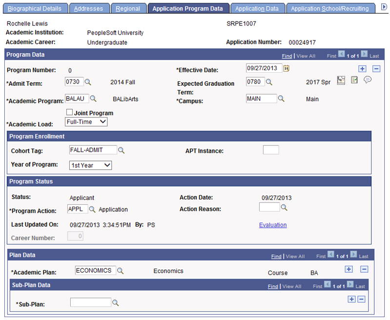

Access the Application Program Data page (Student Admissions > Application Entry > Add Application > Application Program Data).
Image: Application Program Data page example for Program Enrollment
This example illustrates the fields and controls on the Application Program Data page for Program Enrollment. You can find definitions for the fields and controls later on this page.
Field or Control
Definition
Cohort Tag
This field appears only if the Enable Program Enrollment check box is selected on the Academic Institution 9 page. This value is obtained in the application process and indicates the point within a term (typically a session) that the applicant is expected to enroll.
APT Instance
Note: The rules governing the generation of the instance at the admission stage and the process to generate the instance are planned for the future.
Year of Program
This value is obtained in the application process and indicates the student’s start point in a program of study, for example, a student could apply as a second year student.

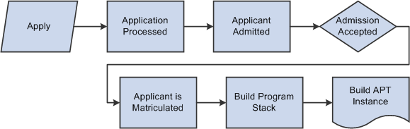

Creating an APT Instance from Admissions
Image: Creation of an APT Instance
Creation of an APT Instance:
Creation of an APT (Academic Progress Tracker) Instance
When the matriculation process creates the Student Records program stack, if a student is in a program/plan/sub-plan combination that is mapped to an AIR program, an API (SSR_APT.API) is called. The API creates an APT instance for the student, linking that instance to the program created by the matriculation process.

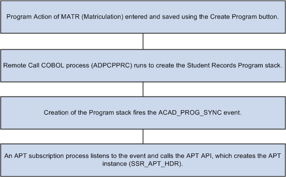

APT Instance Creation from Admissions Application Maintenance Component
An APT instance can be created directly from the Admissions Application Maintenance component when a user creates the student program using the matriculation (MATR) action.
Image: APT Instance Creation from Admissions Application Maintenance Component
The following diagram provides an overview of the processing that takes place:
gv_APTInstance CreationFromAdmissionsAppMaintComponent_lssr

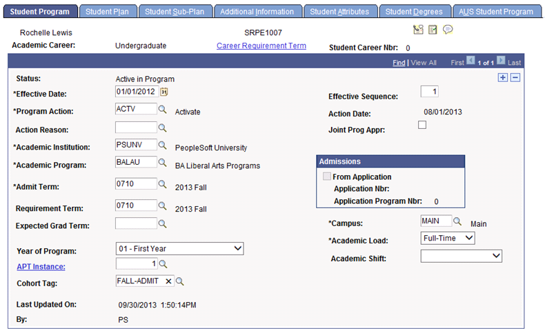

Access the Student Program page (Records and Enrollment > Career and Program Information > Student Program/Plan > Student Program ).
Image: Student Program page example for Program Enrollment
This example illustrates the fields and controls on the Student Program page for Program Enrollment. You can find definitions for the fields and controls later on this page.
Field or Control
Definition
Year of Program
This value is gathered in the application process and indicates the student’s start point in a program of study: for example, a student could apply as a second year student. The value is copied from the Admissions program stack by the matriculation process.
APT Instance
This field is populated with number of the APT Instance. This could be generated during the Admissions activation/matriculation process, the APT Request process or from this component (see “Adding a New Program” below).
Click the APT Instance link to access the Academic Progress Tracker component. From that component, click the Student Career Nbr link to return to the Student Program page.
