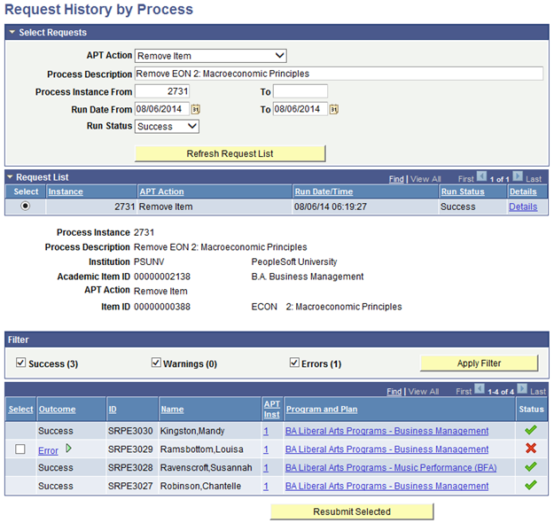

Request History by Process
SSR_APT_REQ_HIST
Records and Enrollment > Program Enrollment > Request History by Process
View APT Action processes, outcomes and statuses.

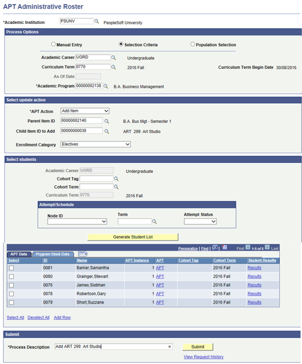

Access the APT Administrative Roster page (Records and Enrollment > Program Enrollment > APT Administrative Roster).
Image: APT (Academic Progress Tracker) Administrative Roster page
This example illustrates the fields and controls on the APT (Academic Progress Tracker) Administrative Roster page. You can find definitions for the fields and controls later on this page.

Select update action: Add Item
Field or Control
Definition
APT Action
Add Item: Add a child academic item from outside the AIR program structure to a parent academic item within the AIR program selected for an individual or group of students in batch. In the APT Administrative Roster page example, ECON 2 does not exist in the B.A Business Management program. This course is being added from outside the AIR program, as a child to the parent B.A. Bus Mgt Semester 1.
The Add Item action also populates the Enrollment Category in the APT Tree (SSR_APT_TREE) if selected or available, and also indicates that this item addition was an administrative addition within the APT. See Using the APT Tree
Parent Item ID

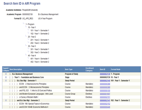

This prompt opens the Search Item ID in AIR Program page which provides a view of the AIR program. Select the parent item to which the child item will be added.
Note: The academic items available for selection are controlled by APT Action Security. See Setting Up APT Action Security
Child Item ID to Add
If the current item is a program format tree node, the Child Item ID to Add prompt lists all academic items that have an academic type specified as a valid child item in the Academic Item Type Matrix.
See Identifying Child Item Types and Syncing Entities
The prompt excludes items that have an item type defined as a program format tree node. This ensures that any changes to the program structure conform to the program format for the item.
Enrollment Category
This field appears only if the Requires Enrollment Category check box has been selected for the academic item type that is being added. Select a value in the Enrollment Category field before submitting the process. See Defining Academic Item Type Attributes
The documentation about the Add Item action and the following documentation about other update actions discusses the Search Item ID in AIR Program page.
Image: Search Item ID in AIR Program page
Here is an example of the Search Item ID in AIR Program page:
Search Item ID in AIR (Academic Item Registry) Program page

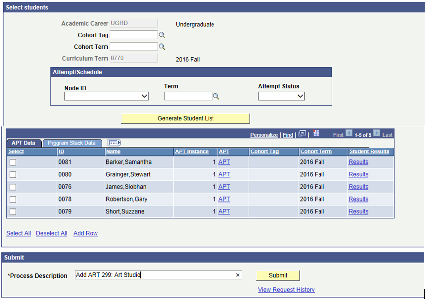

Generate Student List
Click the Generate Student List button after you select criteria using Selection Criteria or Population Selection. When the student data is retrieved, you can access (view or update) the APT Instance or Program Stack data for a student directly from the roster page.
Image: APT (Academic Progress Tracker) Administrative Roster page: Generate Student List grid
This example illustrates the fields and controls on the APT (Academic Progress Tracker) Administrative Roster page: Generate Student List grid. You can find definitions for the fields and controls later on this page.
To process students for an APT Action, select individual students or Select All. Click Add Row to add a student to the list. The Student Results column provides access to the student’s XMLP results page. This is the same view as the student in Program Enrollment Self Service.
See Using BI Publisher and the XMLP Results Template to Display Students’ Results and Outcomes in Program Enrollment Self Service: Sample Template in My Oracle Support (ID 1400723.1).

Submit APT Actions (Add Item, Remove Item, Create Substitution, Enter Results, Enter APT Status)
You can run the APT action Submit as a background process. Alternatively, after submitting, you can view the process using the View Request History link and access the Request History by Process page.
See Monitoring APT Action Processes.
Use the Process Description field on the roster page to provide specific descriptions for each process that you submit, for example, Add Course Econ 2: Macroeconomic Principles. These descriptions are recorded in the process and can also be used when you search for specific processes in the Request History by Process component.

Use the Request History by Process page to monitor the details and outcomes of all APT Action processes submitted on the APT Administrative Roster page. You can monitor the request as it is submitted (the process instance ID is passed to the Request History by Process component), or view later after running the process in the background. You can also use the page to search for previous process instances submitted. If errors are returned during the submit process, you can fix them in the student’s APT or program stack directly from this page, and then resubmit the process.
Although the APT actions Calculate Results and APT Status Evaluation are not submitted to the process scheduler from the roster page, you can still access the results of the rules for these APT actions using the Request History component.
Access the Request History by Process page (Records and Enrollment > Program Enrollment > Request History by Process).
Alternatively, access the page from the APT Administrative Roster page using the View Request History link.
Image: Request History by Process page
This example illustrates the fields and controls on the Request History by Process page. You can find definitions for the fields and controls later on this page.
Filter
Use the Filter grid to filter results based on different outcome statuses. For example, you can display the students that have an error status to resolve the data for those students.
Field or Control
Definition
Select
This check box appears only for those students who have an Error status. You can select student IDs for resubmission.
Outcome
The Outcome status is display only unless the outcome is an error, when a link provides details about the error message.
Resubmit Selected
You can resubmit the APT Action process for an individual or group of students. After the error has been resolved, select the student ID in the grid and click the Resubmit Selected button. You are returned to the APT Administrative Roster page where you can change the Process Description. Submit the process from the APT Administrative Roster page as previously, and then return to the Request by History process using the View Request History link to view the outcome of the process.
Note: For APT actions Calculate Results and APT Status Evaluation, resubmission is not available from the Request History component. The error messages are displayed on the roster page, which allows recalculation directly from the roster.
