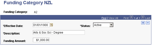

Access the Funding Category NZL page ((Set Up SACR > Foundation Tables > Reporting Codes > Funding Category NZL > Funding Category NZL).
Image: Funding Category NZL page
This example illustrates the fields and controls on the Funding Category NZL page. You can find definitions for the fields and controls later on this page.
Field or Control
Definition
Funding Category
When setting up your funding categories, enter the two-digit alphanumeric code for the funding category.
The first digit is the academic category (A-Z) and the second digit is the degree status (1-5). The degree status variations are:
  • 1: Non-Degree
  • 2: Degree
  • 3: Post Graduate
  • 4: Research
  • 5: Foreign Research
Funding Amount
Enter the MoE funding amount for this funding category.

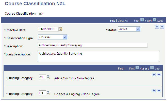

Access the Course Classification NZL page (Set Up SACR > Foundation Tables > Reporting Codes > Course Classification NZL > Course Classification NZL).
Image: Course Classification NZL page
This example illustrates the fields and controls on the Course Classification NZL page. You can find definitions for the fields and controls later on this page.
Field or Control
Definition
When setting up your classification codes, enter the MoE course classification code.
Classification Type
Select Course or Programme.
Funding Category
Enter the funding category for this course classification. You can enter as many funding categories as needed for each classification.
Note: You must assign at least one funding category to each course classification.

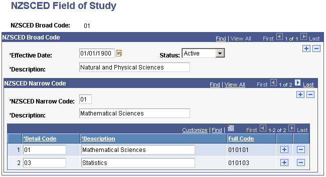

Access the NZSCED Field of Study page (Set Up SACR > Product Related > Student Records > Curriculum Management > NZSCED Field of Study NZL > NZSCED Field of Study).
Important! The NZSCED broad, narrow, and detail codes are defined by the MoE.
Image: NZSCED Field of Study page
This example illustrates the fields and controls on the NZSCED Field of Study page. You can find definitions for the fields and controls later on this page.
Field or Control
Definition
NZSCED Broad Code
When setting up the field of study codes, enter the NZSCED broad code for this field of study.
NZSCED Narrow Code
Enter the NZSCED narrow codes for the broad code.
Insert rows to enter all of the narrow codes for this broad code.
Detail Code
Enter the NZSCED detail codes for the narrow code.
Insert rows in the grid to enter all of the detail codes for this narrow code.
Note: You attach the combination of broad, narrow, and detail code to a course at the catalog level. For example, the code 010103 is the NZSCED code for Statistics.
