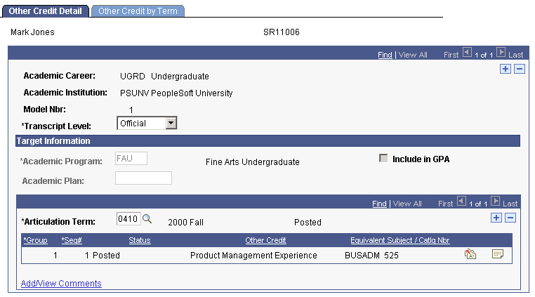

Access the Other Credit Detail page (Records and Enrollment > Transfer Credit Evaluation > Other Credits - Manual > Other Credit Detail).
Image: Other Credit Detail page
This example illustrates the fields and controls on the Other Credit Detail page. You can find definitions for the fields and controls later on this page.
Field or Control
Definition
Other Credit
After you enter other credit on the Equivalent Course Information page for this row of the model, the process displays your selection in this field. You access the Equivalent Course Information page by clicking the Edit Equivalent Course button on the corresponding row of the model.
Save
After you select an articulation term and enter the incoming other credit and internal equivalent course information for this row of the other transfer credit model, click Save.

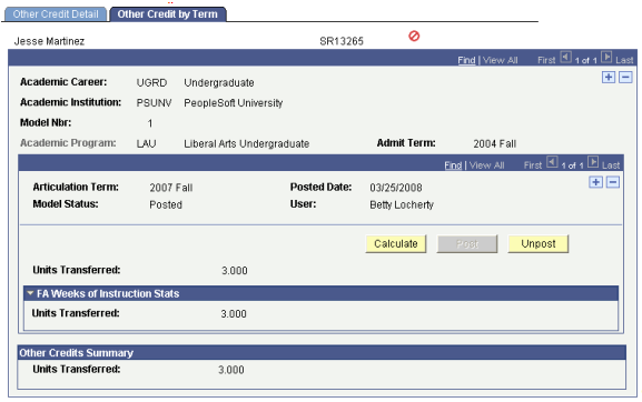

Access the Other Credit by Term page (Records and Enrollment > Transfer Credit Evaluation > Other Credits - Manual > Other Credit by Term).
Image: Other Credit by Term page
This example illustrates the fields and controls on the Other Credit by Term page. You can find definitions for the fields and controls later on this page.
The units of the internal equivalent course appear in Units Transferred field in the FA Weeks of Instruction Stats (financial aid weeks of instruction statistics) group box.
