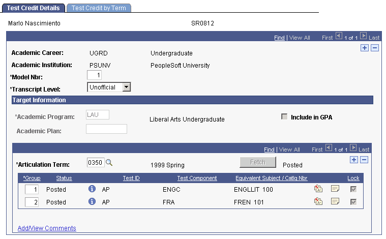

Access the Test Credit Details page (Records and Enrollment > Transfer Credit Evaluation > Test Credits - Automated > Test Credit Details).
Image: Test Credit Details page
This example illustrates the fields and controls on the Test Credit Details page. You can find definitions for the fields and controls later on this page.
Field or Control
Definition
Fetch
After you select an articulation term for this row of the course transfer credit model, click this button to run the Transfer Credit process. The Transfer Credit process COBOL program evaluates the individual's test transfer credit according to the valid test transfer equivalency rules. The process determines valid course transfer equivalency rules, based on whether the rule is active previous to the begin date of the articulation term and based on whether the rule has been attached to the individual's academic program or academic plan. The process then compares the individual's external test information to the valid rules and calculates the results. The tests that the process evaluates appear in the grid at the bottom of the page. Define test transfer equivalency rules on the Test Credit Rule / Component page and attached to academic programs and academic plans for the source on the Test Credit Equivalency page. An individual's external test information is entered on the Test Results component.
Test ID
After you run the Transfer Credit process for this row of the model, the process displays the identification code of each test that it evaluated. The process determines the individual's tests according to the value entered for the test in the corresponding fields on the Test Results component.
Test Component
After you run the Transfer Credit process for this row of the model, the process displays the component of each test that it evaluated. The process determines the individual's test components according to the value that is entered for the test in the corresponding fields on the Test Results component.

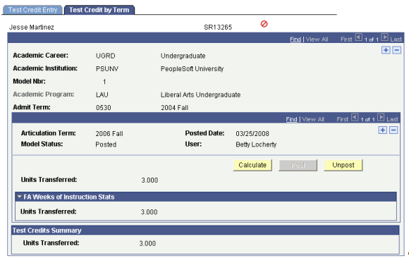

Access the Test Credit by Term page (Records and Enrollment > Transfer Credit Evaluation > Test Credits - Automated > Test Credit by Term).
Image: Test Credit by Term page
This example illustrates the fields and controls on the Test Credit by Term page . You can find definitions for the fields and controls later on this page.
The units of the internal equivalent course appear in the Units Transferred field in the FA Weeks of Instruction Stats (financial aid weeks of instruction statistics) group box.

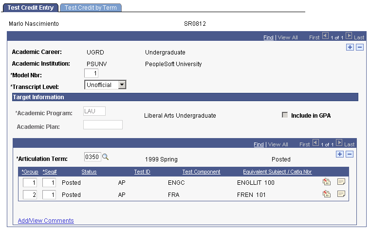

Access the Test Credit Entry page (Records and Enrollment > Transfer Credit Evaluation > Test Credits - Manual > Test Credit Entry).
Image: Test Credit Entry page
This example illustrates the fields and controls on the Test Credit Entry page. You can find definitions for the fields and controls later on this page.
Field or Control
Definition
Test ID
After you select a test ID on the Equivalent Course Information page for this row of the model, the system displays your selection in this field. You access the Equivalent Course Information page by clicking the Edit Equivalent Course button on the corresponding row of the model.
Test Component
After you select a test component on the Equivalent Course Information page for this row of the model, the system displays your selection in this field. You access the Equivalent Course Information page by clicking the Edit Equivalent Course button on the corresponding row of the model.
Save
After you select an articulation term and enter the incoming test credit and internal equivalent course information for this row of the test transfer credit model, click Save to run the Transfer Credit process. The Transfer Credit process COBOL engine evaluates the individual's test transfer credit according to the test credit and internal equivalent information on the Incoming Course information page.

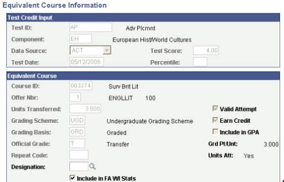

Access the Equivalent Course Information page (click the Edit Equivalent Course button on the Test Credit Entry page).
Image: Equivalent Course Information page
This example illustrates the fields and controls on the Equivalent Course Information page . You can find definitions for the fields and controls later on this page.
Test Credit Input
Use the Test Credit Input group box to enter test information.
Field or Control
Definition
Test ID
The identification number of the test for which you are defining a course equivalency.
Component
The component of the test for which you are defining a course equivalency.
Test Date
The date that the test was taken.
Test Score
The individual's test score.
Data Source
The data source.
Percentile
The percentile of the individual's score.
Equivalent Course
Use the Equivalent Course group box to enter internal equivalent course information.
