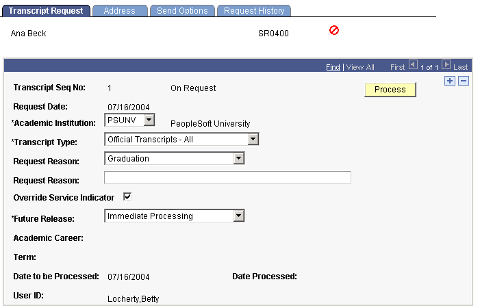

Access the Transcript Request page (Records and Enrollment > Transcripts > Electronic Transcripts > Electronic Transcript Request > Transcript Request).
Image: Transcript Request page
This example illustrates the fields and controls on the Transcript Request page. You can find definitions for the fields and controls later on this page.
Field or Control
Definition
Transcript Seq No (transcript sequence number)
The system assigns a sequential number to each request that you enter for the student.
Request Date
The system displays the date on which you enter the request. When you enter a new request, the system uses the current date by default.
Academic Institution
Select the academic institution for which you want to print the request. By default, the system selects the academic institution defined in the User Defaults component.
Transcript Type
Select a transcript type with the correct detail that you want to report electronically. Only transcript types for which you have user security and that have valid careers for this student are available. Transcript type values are defined on the Transcript Type - Basic Data page.
Request Reason
Select the request reason. Request reason values are delivered with your system as translate values. You can modify these values.
You can enter free-form text to further clarify the request reason in this field.
Override Service Indicator
Select this check box to have the system process the transcript for this student, regardless of whether the student has a service indicator with service impacts that match those specified for this transcript type on the Basic Data page. Service impacts that are listed on the Basic Data page and are attached to the student prevent a student from receiving a transcript. If you do not select this check box, the system enforces the service indicator rules and does not generate transcripts for a student with service impacts that match those on the Basic Data page for this transcript type.
See Viewing, Assigning, or Removing Service Indicators
Future Release
Select a future release to indicate that you want the system to generate the transcript at a later date. Future release values are delivered with your system as translate values. These translate values should not be modified in any way. Any modifications to these values require a substantial programming effort. Values are:
Degree Confer Date: The Career and Term fields become available for entry.
Grades Post: The Career and Term fields become available for entry.
Hold: The system sets the Date to be Processed field to the current date and is available for entry. This option indicates that you are going to process the request at a later and undetermined time. The system saves this request until you change the future release value and enter a specific print date.
Immediate Processing: The system sets the Date to be Processed field to the system date.
Specific Date: The system sets the Date to be Processed field to the current date and it is available for entry. You can enter a specific date for the transcript request to be processed through the Generate Electronic Transcript page.
Transfer Credit Post: The system sets the Date to be Processed field to the current date and it becomes available for entry. You can issue a transcript through the Generate Electronic Transcript page after the system articulates transfer credit to the student's academic record. Because this process is not automatic, you must still generate the electronic transcript on the Generate Electronic Transcript page.
Academic Career and Term
If available for entry, select the appropriate academic career and term values. You can issue a transcript later through the Generate Electronic Transcript page on the fully graded date—future release value of Grades Post—or when the degree confer date arrives for the student—future release value of Degree Confer Date. The system populates the Date to the Processed field with either the fully graded date from the Term Control Dates page in the Term Activation component, or the degree confer date from the Degree page in the Student Degrees component. Term values are defined on the Term Table page.
To create transcripts for future release, enter the request parameters and save the request without processing it. To process and send the future release request later, enter into the Generate Electronic Transcript page a range of dates based on the Dates to be Processed field. The system processes requests for all electronic transcripts that have not yet been generated within the range you specify. After you process a transcript request, the system marks the report request ID as Generated, and the system excludes it from further batch processing.
Entered By
The system displays the user ID and name of the person who entered the request.
Process
Click to process the request immediately and send the report as indicated on the Send Options page. The system takes you to the Request History page.
The Process button calls an Application Engine program that processes the request and creates the flat file. PeopleSoft PeopleCode, using Workflow, will send the resulting file as an email attachment if so requested on the Send Options page.
The process updates the request status to be generated. If you also send the file by email, the process updates the request status to complete.
If the student has a service indicator with an attached service impact that is defined on the transcript type setup, the system displays the Service Indicator page and indicates that it prevented the transcript due to negative service indicators.
