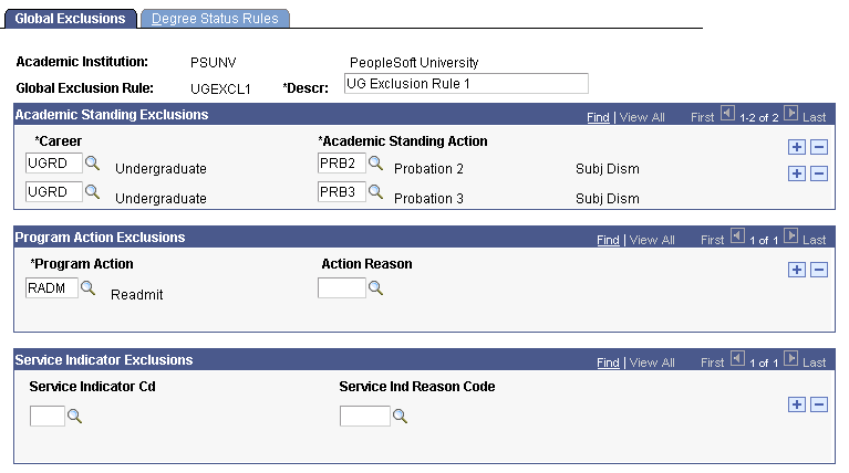

Access the Global Exclusions page (Records and Enrollment > Term Processing > Term Activation > Term Activation Batch Setup > Global Exclusions).
Image: Global Exclusions page
This example illustrates the fields and controls on the Global Exclusions page. You can find definitions for the fields and controls later on this page.
Field or Control
Definition
Academic Institution
The academic institution for which the global exclusion rule applies.
Global Exclusion Rule
A rule that you can define to prevent the Term Activation process from term-activating students that have certain parameters on their student career term records (STNDT_CAR_TERM table).
Academic Standing Exclusions

Select the academic career for which you want to exclude an academic standing action from the Term Activation process (SRTRMAC).
Academic Standing Action
Select the actions (within the academic career) to exclude from the Term Activation process.
The Term Activation process connects each academic standing exclusion using an implied Or statement. For example, in the page above, PSUNV can use the rule to prevent undergraduates that are subject to dismissal (academic standing action equals PRB2 or PRB3) from being activated in regular terms.

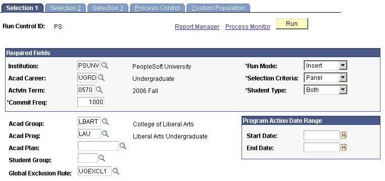

Access the Term Activation - Selection 1 page (Records and Enrollment > Term Processing > Term Activation > Term Activation Batch Process > Selection 1).
Image: Term Activation - Selection 1 page
This example illustrates the fields and controls on the Term Activation - Selection 1 page. You can find definitions for the fields and controls later on this page.
The Term Activation process (SRTRMAC.SQR) provides extensive selection functionality for activating specific student populations into terms by academic career. On the Term Activation setup component you predefine rules of exclusion and inclusion, whereas on the Term Activation process component you define characteristics for the population of students that you want to include in batch term activation. You can also attach a global exclusion rule to a given process instance. All of the selection criteria in this component are additive and meant for you to broaden or narrow the scope of your target population for batch term activation. If you want to perform a basic run of the Term Activation process without specifying inclusions and exclusions, you can select values for all of the fields found in the Required Fields group box on the first page. After you enter values for these fields, you can run the process at any time, ignoring the other fields in the component.
Note: You can only run the Term Activation process for one academic career at a time. If you want to activate students in terms across academic careers, you must run the process for each academic career.
Required Fields
This group box contains all the fields necessary to run the Term Activation process (SRTRMAC). The remaining fields on this page and the other pages in the component are optional. Use them to further restrict who is eligible for term activation on a specific run.
Field or Control
Definition
Institution
Select an academic institution. The Term Activation process considers only students active in that academic institution as eligible for term activation.
Run Mode
Select from the following choices the mode in which you want the Term Activation process to run. To ensure optimal performance, the process only allows you run in one mode at a time.
Insert: The Term Activation process considers for term activation only the students not yet activated in the activation term. If eligible, the process adds a new row of term data to the student's career term record (STDNT_CAR_TERM table).
Update: The Term Activation process considers for record modification only the students who already have been activated in the activation term. If eligible, the process updates the student's existing career term data (found in the STDNT_CAR_TERM table). Use other fields in this component to further control how the update function operates.
Acad Career (academic career)
Select an academic career. The Term Activation process only considers students who are active in that academic career as eligible for term activation. The Term Activation process enables you to activate students in only one academic career per process run. To activate students for multiple academic careers, you must run the process for each academic career.
Selection Criteria
Select from the following choices the type of selection criteria that you want the Term Activation process to use for the run.
Panel: Use the fields available in the component to specify the criteria that determines the students who are eligible for term activation. (Default)
Custom: Activate a custom population of students, or large batches of students, for one term or across multiple terms. For example, use this option when you need criteria beyond what the component provides, or when you want to perform a student records conversion.
By selecting this option, you direct the Term Activation process to look at the delivered PS_TRMAC_CUST_PPLT table to determine who should be term-activated. If desired, you can create your own SQR to populate this table.
The Term Activation process, when run with the Custom option, selects custom populations from the PS_TRMAC_CUST_PPLT table based on run control ID and user ID. If you select the Custom option, you can edit or enter, on the Custom Population page (which is found in this component), the students and the terms for which you want to activate them. Otherwise, the Custom Population page is unavailable to edit.
Actvtn Term (activation term)
Select the term for which you are running the process, known as the activation term. Students that meet all run criteria are activated for this term. If you select a value of Panel in the Selection Criteria field, then this field is required. If you select a value of Custom in the Selection Criteria field, the Term Activation process uses the term for the student on the PS_TRMAC_CUST_PPLT table or on the Custom Population page in this component.
Student Type
Select from the following choices the type of student to activate. Values for this field are delivered with your system as translate values. Do not modify these values in any way. Any modifications to these values require a substantial programming effort.
New: Activate only students newly admitted to your academic institution.
Continuing: Activate only continuing students.
Both: Activate both new and continuing students simultaneously in a single run. (Default)
Note: The Term Activation process defines new and continuing students by comparing the activation term against the admit term. Students that have the same activation term and admit term are new. Students with an admit term prior to the activation term are continuing.
Commit Freq (commit frequency)
Select how many table rows of information (students) you want to process before committing changes to the database. The default is 1,000. Consult your institution's database administrator for the appropriate setting for your institution. If you set the commit value to higher than the number of rows the program processes, then the program commits data only once at the end of the run. The commit logic for this field is platform independent.
Optional Fields
The use of the Acad Prog (academic program), Acad Plan (academic plan), Acad Group (academic group), and the Program Action Date Range group box fields can improve the performance of the Term Activation process. However, excessive use of global exclusions and other selection criteria, such as academic standing actions, service indicator codes, and required enrollment terms might slow the process.
Field or Control
Definition
Select an academic group to narrow the population of students to term-activate.
Select an academic program to narrow the population of students to term-activate.
Select an academic plan to narrow the population of the students to term-activate. You can specify an academic plan independently of an academic program. For example, if you specify both an academic program and plan, then only students active in both the academic program and plan are eligible for term activation. However, if you specify an academic plan alone, then only students active in that academic plan regardless of their academic program are eligible for term activation.
Start Date and End Date
The beginning and end of the program action date range.
Use these fields to narrow the population of students to term-activate to a specific range of program action dates. For example, you can use this date range to limit term activation to only the students that have been activated or matriculated into an academic program since the last run of the Term Activation process. The Term Activation process compares this date range to the Action Date field on the Student Program page. The action date is the transaction date on which the student gets activated into an academic program, not the effective date. If the action date is greater than or equal to the start date and less than or equal to the end date, the student qualifies for term activation.
To use these fields you must enter values for both. By default, the end date equals the start date.
Student Group
Select a student group to narrow the population of students to term-activate. The process only activates students within that student group who also meet the other selection criteria of the component.
If you want to use a global exclusion rule on this run to further narrow the population of students to term-activate, use this field's prompt to select a rule. If you do not want to use global exclusions, leave this field blank. You can specify a different global exclusion rule for each run of the process.

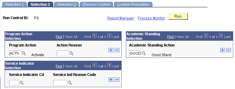

Access the Term Activation - Selection 2 page (Records and Enrollment > Term Processing > Term Activation > Term Activation Batch Process > Selection 2).
Image: Term Activation - Selection 2 page
This example illustrates the fields and controls on the Term Activation - Selection 2 page. You can find definitions for the fields and controls later on this page.
This page enables you to narrow your target population for term activation by selecting the program action, action reason, academic standing action, and service indicator data that you want to include.
Note: The Term Activation process (SRTRMAC) connects academic standing, program action, and service indicator selections with an implied and between each selection type. The process connects the criteria with an implied or within each selection type.
Program Action Selection
Field or Control
Definition
Program Action
Select the program action that you want to include for the Term Activation process. In Insert run mode, the system prompts you only with the actions that are eligible for term activation. In Update run mode, the system prompts you with all available actions. You can enter a program action that conflicts with a global exclusion. However, the global exclusion always takes precedence over the selection criteria.
Action Reason
If you want to include a program action only when a particular reason is attached to that action, select a reason in this field. The system prompts you with only the program action reasons related to the program action you specify. When you specify a reason, list all of the reasons within that program action that you want the Term Activation process to include.
If you leave this field blank, the Term Activation process includes all students that have that program action and meet the other run criteria, regardless of the program action reason.
The Term Activation process evaluates each program action and reason combination using an implied Or statement. Therefore, never indicate a program action and reason combination and then for the same program action leave the action reason blank. In such a case, the process include all actions regardless of the reason you specified. For example, if you list a program action of MATR with an action reason of FDEP, then add another row with an action of MATR and the reason left blank, the Term Activation process ignores the first entry and assumes that any student with the program action of MATR, independent of the reason, is eligible for term activation.
Important! The values you enter in this group box must exist on the student's most current effective-dated academic program row in order for the student to be selected.
Academic Standing Selection
Field or Control
Definition
Select the academic standing action that you want the Term Activation process to include.
The Term Activation process connects each academic standing using an implied Or statement. For example, PSUNV might want to make eligible for term activation only students with GOOD or GREA (great) academic standing that also meet the other run criteria.
Service Indicator Selection
Field or Control
Definition
Service Indicator Cd (service indicator code)
Select the service indicator code that you want to include in the Term Activation process.
Service Indicator Reason Cd (service indicator reason code)
If you want to include a service indicator code only when a particular reason is attached to that code, select a reason. The system prompts you with only the service indicator reasons related to the service indicator you specify. When you specify a reason, you must list all of the reasons within that service indicator that you want the Term Activation process to include.
If you select a service indicator code and leave this field blank, the Term Activation process includes all students that have that service indicator code and meet the other run criteria, regardless of the service indicator reason.
The Term Activation process evaluates each service indicator/reason combination using an implied Or statement. You should therefore never indicate a service indicator/reason combination and then, for the same service indicator, leave the action reason blank. In such a case, the process includes all reasons. For example, if you list a service indicator of ALL with a service indicator reason of BILL, then add another row with a service indicator of ALL and the reason left blank, the Term Activation process ignores the first entry and assumes that any student with the service indicator of ALL, independent of the reason, must be eligible for term activation.
