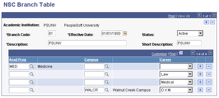

Access the NSC Branch Table page (Set Up SACR > Product Related > Student Records > Enrollment Reporting Codes > NSC Branch Table > NSC Branch Table).
Image: NSC Branch Table page
This example illustrates the fields and controls on the NSC Branch Table page. You can find definitions for the fields and controls later on this page.
NSC (National Student Clearinghouse) Branch Table page
The NSC requires that your institution defines a branch code for each group of students that has its own reporting time line. For example, if you have multiple campuses at your academic institution, and you are reporting each of these campuses separately to the NSC at different times of the year, you might use a different branch code for each campus.
Another example is if your institution has academic programs that are running on different calendars. For instance, your institution has a law program, a medical program, an undergraduate program, and a graduate program. Whereas the undergraduate and graduate programs might run on a semester term type, the law and medical programs might run on quarter term type. In such a case, your institution might use different branch codes for the semester programs and the quarter programs.
