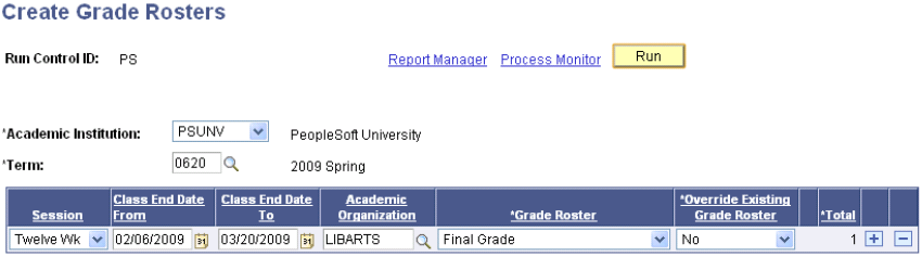

Create Grade Rosters
RUNCTL_GRD_ROSTER
Curriculum Management > Grading > Create Grade Rosters > Create Grade Rosters
Create grade rosters for each term and session by subject area or by academic organization. To print the grade rosters, use the Grade Roster Print page. If you want to use blind grading for this class, select the Use Blind Grading check box on the Class Associations page or select the Use Blind Grading check box on the Course Catalog Offerings page so that the system uses blind grading each time that you schedule the class. The system then populates the Use Blind Grading check box each time that you create a class association.

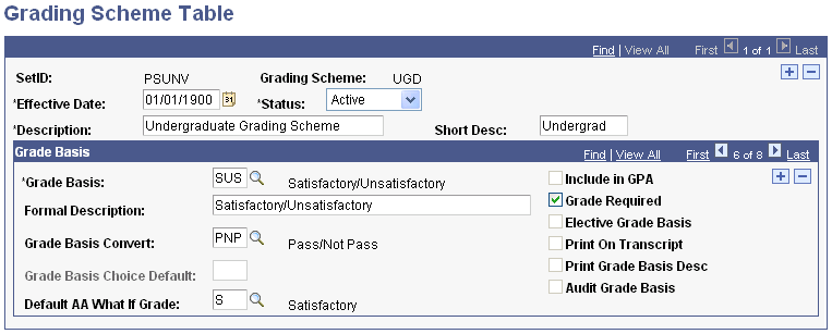

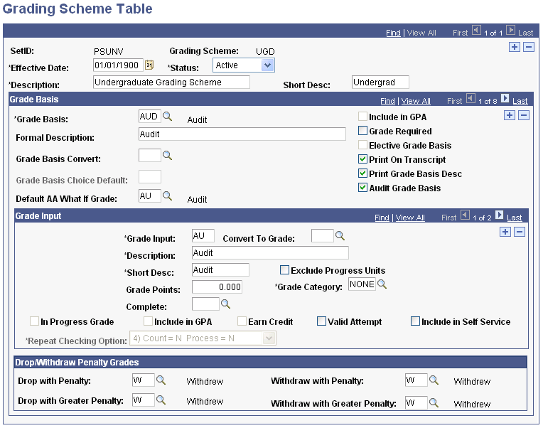

Access the Grading Scheme Table page (Set Up SACR > Foundation Tables > Academic Structure > Grading Scheme Table > Grading Scheme Table).
Image: Grading Scheme Table page
This example illustrates the fields and controls on the Grading Scheme Table page. You can find definitions for the fields and controls later on this page.
Grading schemes are linked to academic careers and academic programs.
Field or Control
Definition
Status
Enter a status for this grading scheme. Enter Active when adding a new grading scheme. Enter Inactive only if your institution no longer uses this grading scheme.
Description
Enter a description for the grading scheme.
Short Desc (short description)
Enter a short description for the grading scheme.
Grade Basis
Enter a grade basis. Grade basis values are entered into your system as translate values, which you can modify.
A Grade Basis of NON (Non-Graded) is required for each grading scheme. This value is assigned for non-graded sections, such as labs associated with a lecture. To activate this grading basis, do not select any of the check boxes and do not enter any grades.
Formal Description
Enter a formal description of the grading basis.
Grade Basis Convert
Enter a grade basis convert value to use grades that are associated with another grading basis. If you enter a value in this field, the Grade Input group box becomes unavailable because the grade basis references the grade input data of another grade basis.
Grade Basis Choice Default
If you select the Elective Grade Basis check box, you can enter a grade basis choice default to specify the default grade basis for this grading scheme. In addition, you can enter all of the possible grading basis choices in the fields that become available in the bottom third of the page. The system uses the default value during enrollment. If students have the option to select other grade bases, they can do so at enrollment time.
Include in GPA (include in grade point average)
Select to include grades from this grading scheme in grade point average (GPA) calculations.
Grade Required
Select to specify this grade basis as required, for the purposes of the Grade Review - Transcript Release process. When you evaluate students using the Grade Review process, those classes in which the students are enrolled with a required grade basis must have all of their grades; otherwise, a transcript is not generated for the student.
Selecting this option can prevent transcripts from printing until all of a student's term grades are posted.
See Processing Batch Transcripts (Application Engine).
Select to enter the grading bases from which the student may select during enrollment.
Print on Transcript
Select to display, on the transcript, classes that are graded with this grade basis. If you do not select this option, all class data for courses that have grades that are from this grade basis do not appear on the transcript.
Print Grade Basis Desc (print grade basis description)
Select to have the formal description of the grade basis appear on the transcript.
Audit Grade Basis
Select to indicate that the grading scheme is audit-only. If you select this check box, the following check boxes in the Grade Input group box become unavailable: In Progress Grade, Include in GPA, and Earn Credit.
Grade Input
If you enter a grade basis and clear the Elective Grade Basis check box, or if you do not enter a value in the Grade Basis Convert field, the Grade Input field becomes available. Enter all of the valid grade values for the grading scheme in the Grade Input field. Add rows as necessary.
Convert To Grade
When you post grades, the system converts the originally entered grade to the convert to grade if a value exists in the Convert to Grade field. This field is optional. The convert to grade must be within the grading scheme that you are currently defining.
Description
Enter a description for the grade input.
Enter a short description for the grade input.
Exclude Progress Units
Select to have the system exclude this grade from progress units. For example, you would select this check box for a W or withdrawal grade.
Grade Points
Enter the grade points for the grade input. The system uses these grade points, in conjunction with the units attempted for the class, when it calculates GPA.
Complete
This field is user-defined. Define complete values on the Complete Grade Flag page. In New Zealand, this field is used for reporting purposes.
Grade Category
Use this field to give a grade additional identity. You can assign a grade category to a particular grade or a group of grades, and then use these assignments for advanced advising analysis purposes, such as requisite checking or academic advising limits. By default, the system populates the Grade Category field with None.
A typical example of a grade category is Pass or Transfer Pass. You can use academic advising to limit the number of classes with grade categories of Transfer Pass that count toward degree requirements. Select from a list of grade categories that are defined by your institution.
Grade categories are defined on the Grade Category Table page.
See Setting Up Grade Category Values.

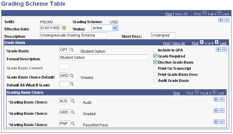

Grade Scheme Example: Using an Elective Grading Basis
Image: Example of elective grade basis, Grading Scheme Table page
Select the Elective Grade Basis check box for grade bases that permit students to choose different modes of grading for a class. Before you select this check box, define all of your grading basis choices
On this page, select:
  • The Elective Grade Basis check box.
    The system displays the Grading Basis Choice scroll area.
  • All valid possible grading basis choices from which a student can choose for a class that is offered with this grade basis of OPT.

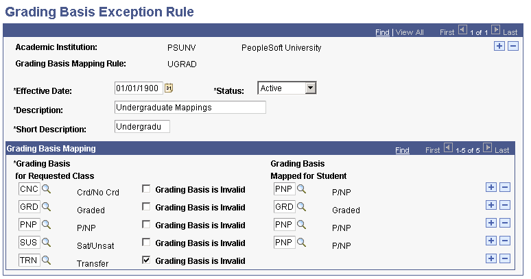

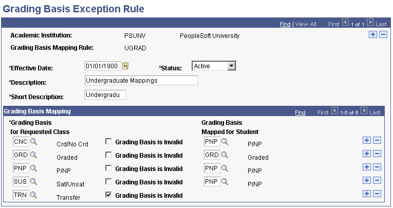

Access the Grading Basis Exception Rule page (Set Up SACR > Product Related > Student Records > Grading > Grading Basis Exception Rule > Grading Basis Exception Rule).
Image: Grading Basis Exception Rule page
This example illustrates the fields and controls on the Grading Basis Exception Rule page. You can find definitions for the fields and controls later on this page.
If grade bases are variable at your institution, you should define grade basis mapping rules. When students in one academic program or career enroll in classes in another program or career (that have a different grade basis), the system uses your grade basis mapping rules to convert grade basis values to those that are appropriate for the students' careers and programs.
Grading basis rules designate any and all schemes for grading, including the grade points for each grade.
You link grading basis exception rules to career pointer exception rules. Career pointer exceptions are linked to academic programs.
Grading basis exception rules are keyed by academic institution.
Field or Control
Definition
Effective Date
Enter an effective date for this mapping rule.
Status
Enter a status for this mapping rule. Enter Active when adding a new mapping rule. Enter Inactive only if your institution no longer uses the mapping rule.
Note: If you inactivate the grading basis mapping rule, you must also remove it from the Career Pointer Exception page.
Description
Enter a description for the mapping rule.
Short Description
Enter a short description for the mapping rule.
Grading Basis for Requested Class
The grading basis from which you are mapping. Grading basis values are defined on the Grading Scheme Table page.
Warning! If a student attempts to enroll in a mapped cross-career course and the student selects a grade basis that you did not specify in the Grading Basis for Requested Class field as eligible for remapping, then the system considers their request invalid and denies the enrollment request.
Grading Basis is Invalid
Select to invalidate the grading basis. In the preceding example, the Transfer grading basis is invalid. Students cannot select the Transfer grading basis for classes with this mapping rule.
Grading Basis Mapped for Student
The grading basis to which you are mapping. In our example, when an undergraduate student enrolls in a graduate class with a grading basis of Satisfactory/Unsatisfactory, the system converts their grade basis to Pass/No Pass. Grading basis values are defined on the Grading Scheme Table page.
Note: When a student enrolls, the mapped values appear prior to posting the enrollment, regardless of whether the student is using Campus Solutions Enrollment Request, Enrollment, Quick Enroll, or Student Self Service Enrollment.
Grade Basis Mapping Example

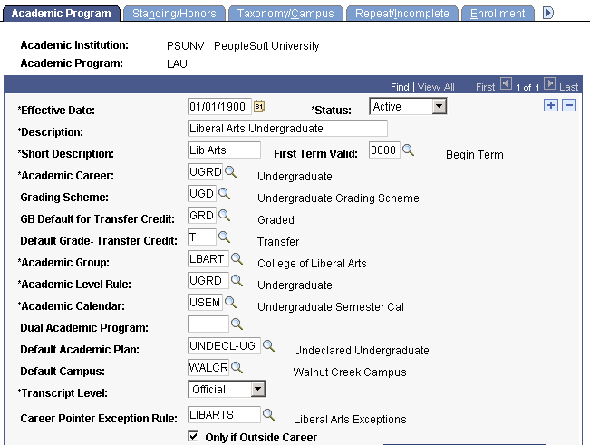

Image: Viewing career pointer exception rules on the Academic Program page (ACADEMIC_PROG_TBL)

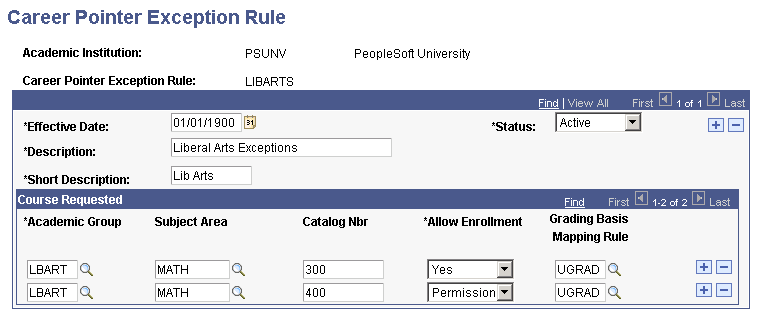

When Michael tries to enroll in Marketing 500, the system first looks at the Career Pointer Exception Rule field on the Academic Program page for Michael's academic program (LAU).
If the field is cleared, grading basis mapping does not occur. Instead, the system looks at the Academic Career Pointers page to determine whether the student is eligible to enroll in the class. If enrollment is allowed, the system pulls from the course grading scheme as determined by the academic career that is noted on the Course Catalog - Offerings page. However, in our example,LIBARTS is selected in the Career Pointer Exception Rule field. Therefore, the system uses the LIBARTS exception rule on the Career Pointer Exception Rule page.
Image: Viewing grading basis mapping rules on the Career Pointer Exception Rule page (CAR_PTR_EXCEPTIONS)
This example illustrates the Career Pointer Exception Rule page as explained above.
The system searches the Course Requested group box for rows that match the class in which the student is enrolling. In our example, Michael Holt is trying to enroll in Marketing 500. The system looks at the Academic Group, Subject Area, and Catalog Nbr (catalog number) fields. The catalog number of the requested course must be equal to or greater than the catalog number on this page. Because Marketing 500 is in the MGMT academic group and the Marketing subject area, and it is greater than or equal to 500, the system allows Michael to enroll in the class with permission. The system then maps the grading basis to the student's career or program using the value in the Grading Basis Mapping Rule field (UGRAD). Grading basis mapping rules are defined on the Grading Basis Exception Rule page.
Image: Viewing grading basis mapping rules on the Grading Basis Exception Rule page (GRD_BASE_EXCEPTION)
This example illustrates the Grading Basis Exception Rule page as explained above.
The system uses the values on this page to determine how to map each grading basis. Because the grading basis for the requested class is SUS (satisfied/unsatisfied), the system maps to PNP (pass/no pass). Therefore, Michael's grading basis appears as PNP on enrollment pages.

Access the Create Grade Rosters page (Curriculum Management > Grading > Create Grade Rosters).
Image: Create Grade Rosters
This example illustrates the fields and controls on the Create Grade Rosters. You can find definitions for the fields and controls later on this page.
Field or Control
Definition
Academic Institution
Enter the academic institution for the grade roster process. This value controls the type of data that is available in the remaining fields.
Term
Enter the term for the grade roster. Term values are defined on the Term Table page.
Session
Enter the session for the grade roster. The session value is optional. Use it to limit your roster production to a single session within the specified term. Session values are defined on the Session Table page.
Class End Date From and Class End Date To
Select the class end date from and to dates. The system selects rosters to create for classes with an end date that is greater than or equal to the value in the Class End Date From field and less than or equal to the value in the Class End Date To field. Both fields are optional and one may be entered without the other.
Academic Organization and Subject Area
Enter the academic organization or subject area for which to produce the rosters. You can enter the academic organization or subject area, but not both. If you enter an academic organization, the Subject Area field is unavailable for entry. Conversely, if you enter a subject area, the Academic Organization field is unavailable for entry. Academic organization values are defined on the Academic Organization Table page. Subject area values are defined on the Academic Subject Table page.
Grade Roster
Enter the type of grade roster that you want to generate. Grade roster values are delivered with your system as translate values. While you should not change the Final Grade value, you can add as many nonfinal grade values as you want.
Override Existing Grade Roster
Available values are:
Yes: Enter to delete and override any preexisting grade rosters when you run the Create Grade Roster process, regardless of whether you selected the Override Grade Roster check box on the Grade Roster Type page.
No: Enter to retain all prior grade rosters when you run the Create Grade Roster process, regardless of whether you selected the Override Grade Roster check box on the Grade Roster Type page. The system produces rosters only for those classes for which rosters have not yet been generated and appends any currently enrolled students who are not on the original roster.
Total
If you selected a grade roster type of MidTerm, this field becomes available. The system enables you to create as many rosters as you need for each class, as long as it is not a Final Grade roster type. Enter the total number of non-final grade rosters that are needed for each class in the Total field.
Run the PSJob SRPCGPR. Results of the Create Grade Rosters process appear on the Grade Roster page.
