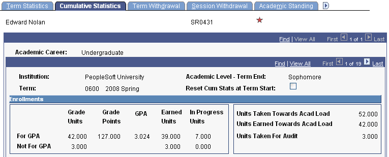

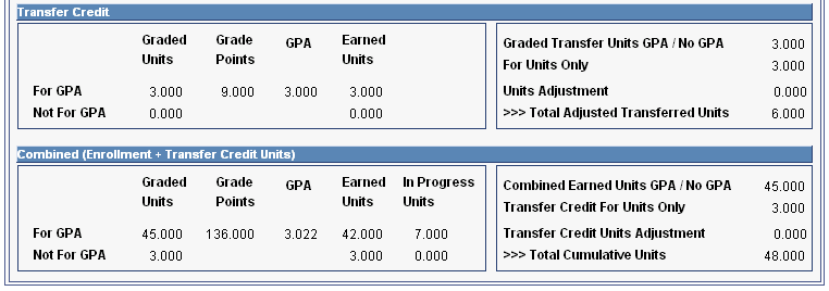

Cumulative Statistics
CUM_STATISTICS
Records and Enrollment > Student Term Information > Term History > Cumulative Statistics
View cumulative statistics for all terms within an academic career. The student must first enroll in classes, have posted transfer credits, or both.

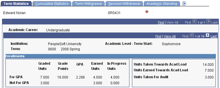

Access the Term History - Term Statistics page (Records and Enrollment > Student Term Information > Term History > Term Statistics).
Image: Term History - Term Statistics page (1 of 2)
This example illustrates the fields and controls on the Term History - Term Statistics page (1 of 2). You can find definitions for the fields and controls later on this page.
Image: Term History - Term Statistics page (2 of 2)
This example illustrates the fields and controls on the Term History - Term Statistics page (2 of 2). You can find definitions for the fields and controls later on this page.
View enrollment and transfer credit statistics for all terms in which the student has been or is enrolled. You can view this information for an individual term in the Enrollment Summary component.
Summary of Student Enrollment for the Term
The following information refers to the example screen shot:
  • 4 Units with Grade A (for GPA) – 16 grade points
  • 3 Units with Grade F (for GPA) – 0 grade points
  • 3 Units with Grade Pass (Not For GPA)
  • 4 Units with no grade (in progress) (class will be For GPA after grading)
  • 3 Units with an Audit grade basis
Enrollments

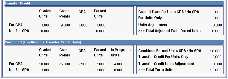

Summary of Student Transfer Credit for Term
  • 3 Units with Grade B (for GPA) for a model where the Include in GPA check box is selected on the Transfer Course Entry page.
  • 3 Units with Grade T for a model where the Include in GPA check box is cleared on the Transfer Course Entry page.
Transfer Credit
The statistics in this group box include both internal and external transfer credits.
Field or Control
Definition
Graded Units - For GPA (graded units - for grade point average )
Displays the total number of units that are transferred for a grade (A, B, C, D, F) and accumulate in the GPA for models where the Include in GPA check box is selected on the Transfer Course Entry page.
Graded Units - Not For GPA (graded units - not for grade point average)
Displays the total number of units that are transferred for a grade (T) and do not accumulate in the GPA for models where the Include in GPA check box is selected on the Transfer Course Entry page.
Grade Points - For GPA (grade points - for grade point average)
Displays a number that is calculated by taking the grade points received for each grade (on a 4-point grading scale, an A equals 4 points), and multiplying that number by the number of units taken for each transferred class for which a grade accumulates in the GPA.
GPA - For GPA (grade point average - for grade point average)
Displays the grade point average which is calculated by dividing the grade points for GPA by the graded units for GPA.
Use the GPA Rounding/Truncating Option field on the Student Records Installation page (Set Up SACR, Install, Student Records Installation) to indicate to how many decimal places you want to round or truncate the grade point average.
Note: No values appear in the Not For GPA row for the Grade Points and GPA fields.
Earned Units - For GPA (earned units - for grade point average)
Displays the total number of transferred units that are passed with an earned credit grade (A, B, C, D) and accumulate in the GPA for models where the Include in GPA check box is selected on the Transfer Course Entry page.
Earned Units - Not For GPA (earned units - not for grade point average)
Displays the total number of transferred units that are passed with an earned credit grade (T) and do not accumulate in the GPA for models where the Include in GPA check box is selected on the Transfer Course Entry page.
Graded Transferred Units GPA / No GPA (graded transferred units for grade point average / not for grade point average)
Displays the sum of transferred units for which received grades both accumulate and do not accumulate in the GPA for models where the Include in GPA check box is selected on the Transfer Course Entry page.
For Units Only
Displays the total number of transferred units that are passed with an earned credit grade and do not accumulate in the GPA for models where the Include in GPA check box is cleared on the Transfer Course Entry page.
Units Adjustment
Displays the total number of units that were manually removed from the student's overall transfer credit units. This field is updated on the Terms in Residence page in the Term Activation component.
Note: This number displays as a positive value, but is stored as a negative value.
Total Adjusted Transferred Units
Displays the sum of graded transfer units (for GPA and not for GPA), plus the value in the Units Only field, minus the value in the Units Adjustment field.
Combined (Enrollment + Transfer Credit Units)
Field or Control
Definition
Displays the sum of all enrollment and transfer credit units that are taken and transferred for a grade (A, B, C, D, F) and accumulate in the GPA.
Displays the sum of all enrollment and transfer credit units that are taken and transferred for a grade (Pass, Fail, Satisfactory, Unsatisfactory, T) and do not accumulate in the GPA.
Displays the sum of all grade points for enrollment and transfer credit units that accumulate in the GPA.
Use the GPA Rounding/Truncating Option field on the Student Records Installation page (Set Up SACR, Install, Student Records Installation) to indicate to how many decimal places you want to round or to truncate the grade point average.
Displays the sum of all enrollment and transfer credit units that are passed with an earned credit grade ( A, B, C, D) and accumulate in the GPA.
Displays the sum of all enrollment and transfer credit units that are passed with an earned credit grade (Pass, Satisfactory, T) and do not accumulate in the GPA.
In Progress Units - For GPA (in progress units - not for grade point average)
Displays the total number of units that are not yet completed and for which the future assigned grade will accumulate in the GPA.
In Progress Units - Not For GPA (in progress units - not for grade point average)
Displays the total number of units that are not yet completed and for which the future assigned grade will not accumulate in the GPA.
Combined Earned Unit GPA/ No GPA (combined earned unit for grade point average / not for grade point average)
Displays the sum of all enrollment and transfer credit units that are passed with an earned credit grade, including both those that accumulate and do not accumulate in the GPA.
Transfer Credit For Units Only
Displays the sum of transferred units that are passed with an earned credit grade and do not accumulate in the GPA for models where the Include in GPA check box is cleared on the Transfer Course Entry page.
Transfer Credit Units Adjustment
Displays the number of units that were manually removed from the student's overall transfer credit units.
Total Term Units
Displays the sum of all enrollment and transfer credit units that are passed with an earned credit grade, including both those that accumulate and do not accumulate in the GPA, plus transfer credit units that are passed with an earned credit grade that do not accumulate in the GPA for models where the Include in GPA check box is cleared, minus the number of units that were manually removed from the student's overall transfer credit units. Units taken for audit are excluded from this total.

Access the Cumulative Statistics page (Records and Enrollment > Student Term Information > Term History > Cumulative Statistics).
Image: Cumulative Statistics page (1 of 2)
This example illustrates the fields and controls on the Cumulative Statistics page (1 of 2). You can find definitions for the fields and controls later on this page.
Image: Cumulative Statistics page (2 of 2)
This example illustrates the fields and controls on the Cumulative Statistics page (2 of 2). You can find definitions for the fields and controls later on this page.
This page displays running cumulative totals by term.
Enrollments
Field or Control
Definition
Units Taken for Audit
Displays the total cumulative audit units taken.
Note: All other field definitions are the same as the definitions for the fields in the Enrollments group box on the Term Statistics page.

Transfer Credit
All field definitions are the same as the definitions for the fields in the Transfer Credit group box on the Term Statistics page.
Field or Control
Definition
Total Cumulative Units
Displays the sum of all enrollment and transfer credit units that are passed with an earned credit grade, including both those accumulated and not accumulated in the GPA, plus transfer credit units that are passed with an earned credit grade and do not accumulate in the GPA for models where Include in GPA check box is cleared, minus the number of units that were manually removed from the student's overall transfer credit units. Units taken for audit are excluded from this total.
All other field definitions are the same as the definitions for the fields in the Combined (Enrollment + Transfer Credit Units) group box on the Term Statistics page.
