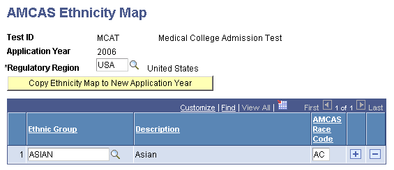

AMCAS Ethnicity Map |
SAD_AMC_ETHNIC_MAP |
For AMCAS and MCAT only, map the race codes provided by testing agency to the corresponding PeopleSoft codes in order to capture ethnicity information on the Add/Update a Person component. Note: This setup is relevant only for posting to Campus Solutions. The system does not support posting AMCAS test scores to CRM therefore this setup is not needed for posting test scores to CRM. |

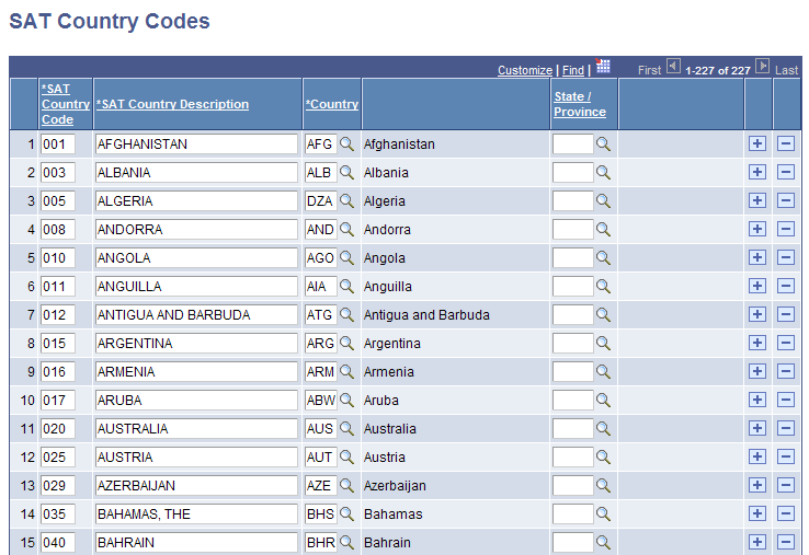

SAT Country Codes |
SAD_SAT_CNTRY_TBL |
Translates the SAT country values to internal PeopleSoft country values during the SAT specific load routine. |

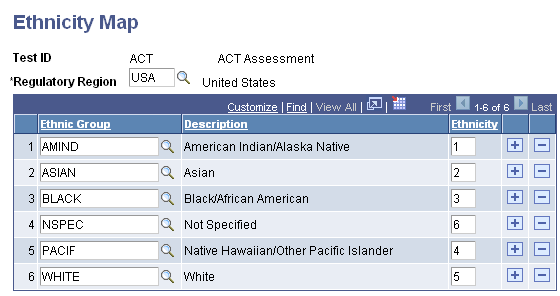

Ethnicity Map |
SAD_ETHNICITY_MAP |
Map the ethnicity codes provided by testing agencies to the corresponding PeopleSoft codes in order to capture ethnicity information on the Bio/Demo Data component. |

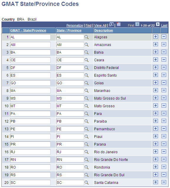

GMAT State/Province Codes |
SAD_GMT_STATE_TBL |
Define or review the mapping of GMAT State/Province codes to PeopleSoft State/Province codes. |
Access the AMCAS Ethnicity Map page ().
Image: AMCAS Ethnicity Map page
This example illustrates the fields and controls on the AMCAS Ethnicity Map page. You can find definitions for the fields and controls later on this page.
Field or Control |
Definition |
| Ethnic Group |
Enter the internal ethnic group value that corresponds to the race code. |
| AMCAS Race Code |
Enter the external AMCAS race code. |
| Copy Ethnicity Map to New Application Year |
Click to copy ethnicity mapping data from one application year to another. The system prompts you for the new year value. |

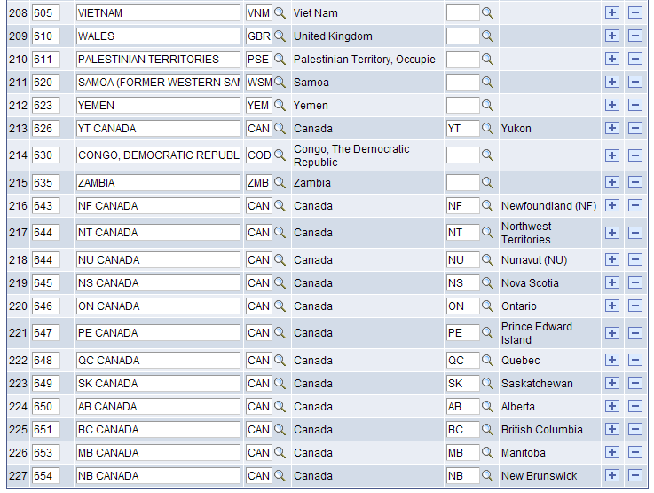

Access the SAT Country Codes page ().
Image: SAT Country Codes page (top of page)
This example illustrates the fields and controls on the SAT Country Codes page (top of page). You can find definitions for the fields and controls later on this page.
Image: SAT Country Codes page (bottom of page)
This example illustrates the fields and controls on the SAT Country Codes page (bottom of page). You can find definitions for the fields and controls later on this page.
The SAT Country Codes table is delivered with known field values set as of the date of this publication. You might need to add, edit, or delete rows to accurately maintain the table in the future.
Field or Control |
Definition |
| SAT Country Code and SAT Country Description |
SAT country codes, descriptions and their corresponding PeopleSoft country codes are delivered in the table. |
| State/Province |
If a state or province is associated with the specific SAT code, that state or province is also delivered in the table. |
Access the Ethnicity Map page ().
Image: Ethnicity Map page
This example illustrates the fields and controls on the Ethnicity Map page. You can find definitions for the fields and controls later on this page.
Field or Control |
Definition |
| Ethnic Group |
Enter the ethnic group code that corresponds to the testing agency code. Ethnicity group codes are defined on the Ethnicity Group Table page. |
| Ethnicity |
Enter the ethnicity code provided by the testing agency. You must contact the testing agency for these codes or refer to the test score layout provided by the testing agency. |
For AMCAS and MCAT ethnicity data, use the AMCAS Ethnicity Map component.
Access the GMAT State/Province Codes page ().
Image: GMAT State/Province Codes page
This example illustrates the fields and controls on the GMAT State/Province Codes page. You can find definitions for the fields and controls later on this page.
Use this page to define or review the mapping of GMAT State/Province codes to PeopleSoft State/Province codes for the following countries: Australia, Brazil, Canada, China, India, Japan, Mexico and the United States.
For the country of Pakistan, State/Province values do not exist in the PeopleSoft State/Province Table. You must therefore map the GMAT State/Province codes for Pakistan to the State/Province codes that you have set up for Pakistan in Campus Solutions.
The GMAT State/Province Codes table is delivered with known field values set as of the date of this publication. You might need to add, edit, or delete rows to accurately maintain the table in the future.
