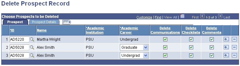

Access the Delete Prospect Record page ().
Image: Delete Prospect Record page: Prospect tab
This example illustrates the fields and controls on the Delete Prospect Record page: Prospect tab. You can find definitions for the fields and controls later on this page.
Enter a value in the ID field. If only one prospect record exists, the institution and career will appear automatically. If a prospect has multiple institution or career records, you must enter a row for each record that you want to delete.
For each prospect record, select the 3Cs, if any, that you want to delete.
Prospect Details

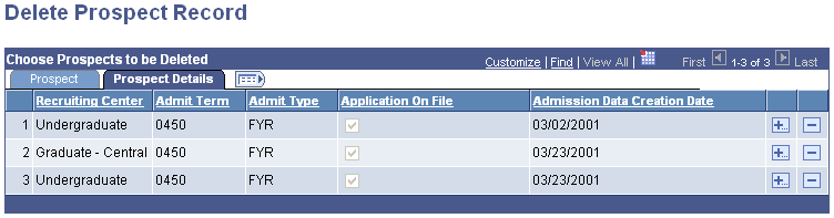

Select the Prospect Details tab.
Image: Delete Prospect Record page: Prospect Details tab
This example illustrates the fields and controls on the Delete Prospect Record page: Prospect Details tab. You can find definitions for the fields and controls later on this page.
View additional information about the records that you have selected on this page.

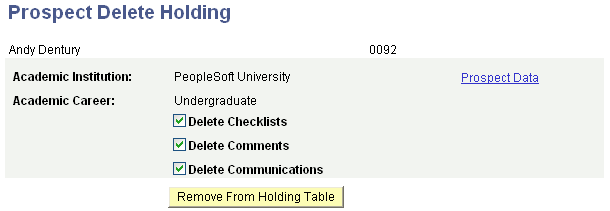

Image: Prospect Delete Holding page
This example illustrates the fields and controls on the Prospect Delete Holding page. You can find definitions for the fields and controls later on this page.
The Prospect Delete Holding table contains all the records that you have selected for deletion, whether individually or in a group. Review these records before you run the Prospect Delete process.
You can:
Use the check boxes to select different 3C options for a prospect.
Click the Remove From Holding Table button to remove a record from the holding table if you no longer want to delete that record.
Click the Prospect Data link to access the Create/Update Prospects component, where you can view additional prospect information and determine whether to remove a record from the holding table.
