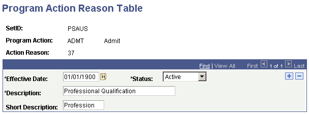

Program Action Reason Table |
PROG_RSN_TBL |
Add program action reasons for the program action of Admit. The TAC Load process assigns these program action reasons to applicants based on the Basis of Admission mapping. |
Basis of Admission Map |
SAD_TAC_MAP_BOA |
Map Admit program action reasons to the Basis of Admission codes provided by the TAC. |

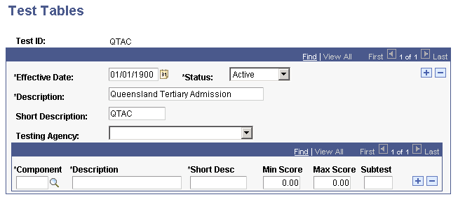

Access the Test Tables page ().
Image: Test Tables page
This example illustrates the fields and controls on the Test Tables page.
Add a test ID for all applicable TACs.

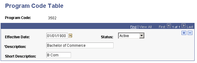

Access the Program Code Table page ().
Image: Program Code Table page
This example illustrates the fields and controls on the Program Code Table page.
Set up program codes that map to course codes in the TAC input files.

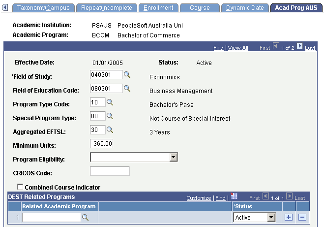

Access the Acad Prog AUS page ().
Image: Acad Prog AUS (academic program Australia) page (1 of 2)
This example illustrates the fields and controls on the Acad Prog AUS (academic program Australia) page (1 of 2). You can find definitions for the fields and controls later on this page.
Image: Acad Prog AUS (academic program Australia) page (2 of 2)
This example illustrates the fields and controls on the Acad Prog AUS (academic program Australia) page (2 of 2). You can find definitions for the fields and controls later on this page.

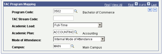

| Program Code |
Associate a TAC program code with an academic program that your institution offers. TAC program codes can be mapped to only one academic program. |
| TAC Stream Code |
Applicable to only SATAC and VTAC. |
| Academic Load |
Enter the academic load that the TAC Load process assigns to the admission applications for the program. |
| Academic Plan |
Enter the academic plan that the TAC Load process assigns to the admission applications for the program. |
| Mode of Attendance |
Enter the mode of attendance that the TAC Load process assigns to the admission applications for the program. |
| Campus |
Enter the campus that the TAC Load process assigns to the admission applications for the program. |

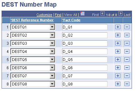

Access the DEST Number Map page ().
Image: DEST Number Map page
This example illustrates the fields and controls on the DEST Number Map page. You can find definitions for the fields and controls later on this page.
DIISRTE - Department of Industry, Innovation, Science, Research and Tertiary - was previously known as DEEWR and before that, as DEST.
For TACs that provide prior education data as FACT codes, associate a FACT code with the applicable DEST Reference Number. The system uses the DEST Reference Number and Fact Code mapping to report highest education attainment so that DIISRTE can track the applicant's prior educational details. The following table lists the DIISRTE (DEST) reference numbers:

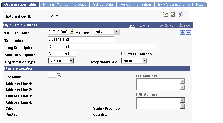

Access the Organization Table page ().
Image: Organization Table page
This example illustrates the fields and controls on the Organization Table page. You can find definitions for the fields and controls later on this page.
Add external organization codes that represent the applicants' schools. The TAC Load process uses the organization codes to post applicant's external education and last school attended data.

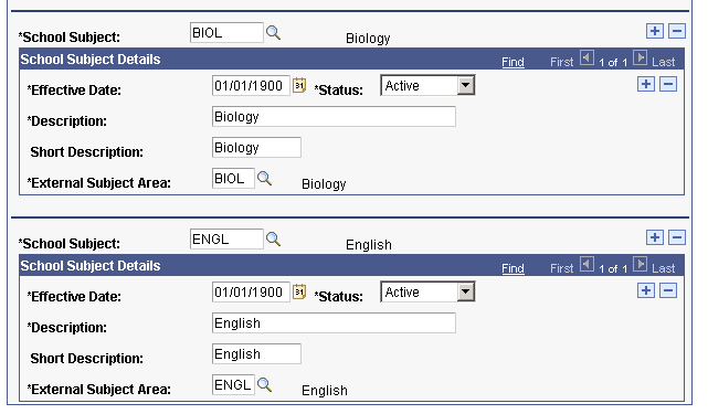

Access the School Subject Maintenance page ().
Image: School Subject Maintenance page (1 of 2)
This example illustrates the fields and controls on the School Subject Maintenance page (1 of 2).
Image: School Subject Maintenance page (2 of 2)
This example illustrates the fields and controls on the School Subject Maintenance page (2 of 2).
Enter the TAC subject codes and subject code details that you want to associate with each external organization.

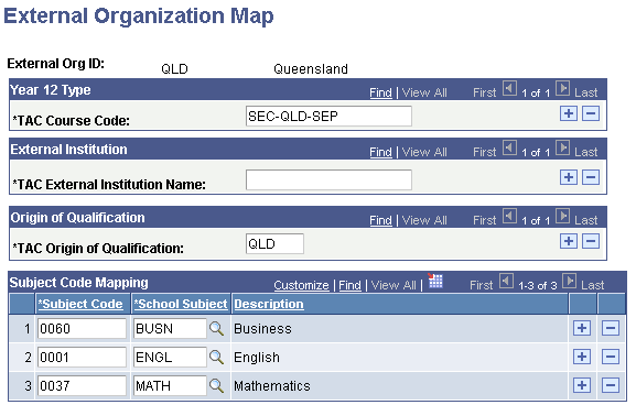

Access the External Organization Map page ().
Image: External Organization Map page
This example illustrates the fields and controls on the External Organization Map page. You can find definitions for the fields and controls later on this page.
Year 12 Type
Enter the valid year 12 course codes for this organization. This data corresponds to the year 12 type in the applicant subject file for QTAC.
External Institution
Use this field for VTAC when you want to map overseas institution names to a specific external organization ID. VTAC data related to the Overseas Post Secondary Qualifications contain only an overseas institution name; this field allows you to map an overseas institution to an external organization ID.
You must set up an organization ID with a value of EXT INSTITN if you do not want to maintain separate organization IDs for the overseas institutions that may exist in the VTAC overseas qualifications data. If the external institution and external organization ID mapping does not exist, the TAC Load process assigns EXT INSTITN as the external organization ID for the overseas qualifications.
Origin of Qualification
Map origin of qualification values to the external organization. The values that you enter here correspond to the origin of qualification values in the application qualification file for QTAC and UAC.
Subject Code Mapping
Map TAC subject codes to the school subjects of the external organization.

Access the Program Action Reason Table page ().
Image: Program Action Reason Table page
This example illustrates the fields and controls on the Program Action Reason Table page.
Map program action reason codes to the program action of Admit.
