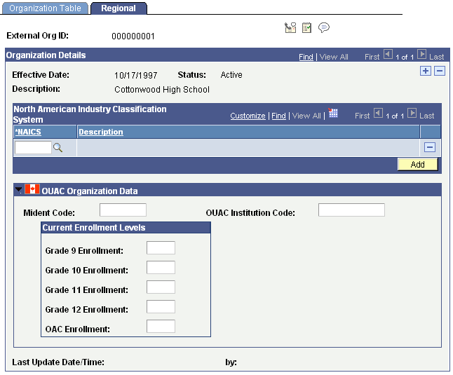

Access the Regional page ().
Image: Regional page
This example illustrates the fields and controls on the Regional page. You can find definitions for the fields and controls later on this page.
Field or Control |
Definition |
| Mident Code |
Enter the Ontario Ministry of Education six-digit school code. |
| OUAC Institution Code |
Enter the code that identifies OUAC institutions. When you post OUAC data, the process looks for this code to populate the EXT_ORG_ID field. |
| Grade 9 (through 12) Enrollment |
Enter the current enrollment levels for the respective grades. |
| OAC Enrollment |
Enter the total OUAC enrollment. |
