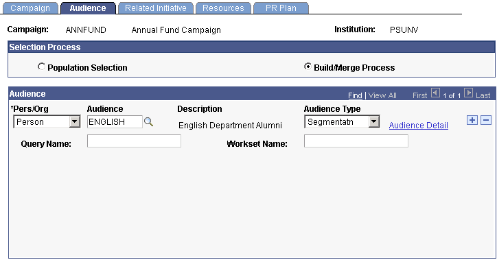

Access the Audience page (Contributor Relations > Initiatives > Campaign Initiatives > Manage Campaigns > Campaign Initiatives > Audience).
Note: Before assigning an audience to an initiative, you must create the audience by defining attribute types, then define audience criteria based on those attribute types.
Image: Audience page
This example illustrates the fields and controls on the Audience page. You can find definitions for the fields and controls later on this page.
Audience page
When you define an audience, you specify which particular group of constituents to reach through the initiative. For example, a reunion event might target all the constituents in the Class of 1990.
Use the audiences that you define to identify who receives particular messages as a result of the public relations plan and to set intermediate goals for the initiative. However, to actually build the audience for the initiative, you must use the Initiative Audience Build page.
Note: Audiences must be linked to an initiative to use Mass Change to assign communications to audience members.
Selection Process
The appearance of this page changes, depending on the selection process you select. If you select Population Selection, you can select audiences built using the Population Selection process on the Audience Criteria page. If you select Build/Merge Process, you can select audiences built using standard audience build/merge functionality.
Audience
Field or Control
Definition
Pers/Org
Select an option: Person, Organization, or Both. The value Both is only available if you selected the Population Selection process.
Audience
Make a selection from the prompt box containing a list of all the audiences for either persons or organizations defined by your institution. This list includes only those defined on the Audience Criteria page.
Audience Type
Select the reason that the audience you entered has been chosen. Values for this field (Segmentation, Reporting, and Administrative) are delivered with the system as translate values. Segmentation is a required value. Do not modify these values in any way. Any modifications to these values will require a substantial programming effort.
Use Reporting to report the progress of the campaign. Use Administrative to create an audience of those responsible for the campaign. Use Segmentation for marketing purposes.
Note: Segmentation is the only type available for setting campaign goals.
Select Segmentation to include this audience for this initiative in the list of Audience Code values on the Initiative Goals page and PR Plan page. Reporting and Administration are not relevant to the Initiative Goals page.
Query Name
If desired for future reference, enter the current query name used in your reporting tool when running reports on the audience. This field is only available if you chose to use the Build/Merge Process.
Workset Name
If you use a workset containing the members of the audience, enter the name. You can enter only those worksets that you have access to. This field is only available if you chose to use the Build/Merge Process.
Audience Detail
Click to open the Audience Detail page. This page displays the criteria that defines the audience. Review this information to ensure that you select the correct audience. This field is only available if you chose to use the Build/Merge Process.
