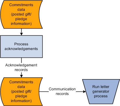

The following diagram represents the way acknowledgement information feeds into the joint letter generation process:
Image: Acknowledgement process into letter generation
This graphic illustrates the flow of information from the Acknowledgement process into letter generation:
The 3Cs Engine generates joint communications for acknowledgement letters and receipts. After the communications record exists, you can run the Letter Generator process (CCLTRGEN). The 3C Engine runs through a series of rules to determine which records are joined and should receive joint communications. Any remaining unjoined records receive individual communications. The Letter Generator creates a Comma Separated Values (.csv) file containing data needed to generate both joint and individual letters. The .csv file can be merged with a Microsoft Word template to produce actual letters.
