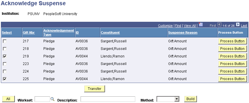

Access the Acknowledge Suspense page (Contributor Relations > Session Management > Acknowledgements > Acknowledge Suspense).
Image: Acknowledgement Suspense page
This example illustrates the fields and controls on the Acknowledgement Suspense page. You can find definitions for the fields and controls later on this page.
Important! Acknowledgements are assigned to suspense if they do not fall into any of the setup parameters established when defining acknowledgement rules. They are also assigned to suspense if they are assigned to a role and there is not a resource assigned to that role.
Field or Control
Definition
Select
Select each record for which to transfer acknowledgements.
Process
Click to process acknowledgement letters on the Acknowledgement Detail Page.
Transfer
Click to assign the acknowledgement to another staff member on the Transfer Page.
If there is a gift level range (such as gifts less than 50 USD) for which only a receipt should be produced, be sure to include a row in the gift level portion of the acknowledgement setup to manage this. To produce only a receipt, set the No Receipt flag to Yes and select the same event ID that is selected for your receipt. The system generates a receipt but does not produce an acknowledgement letter. If you do not do this the acknowledgement process sends everything in the acknowledgement list to the manual acknowledgement suspense process.
You can build a workset from this page.

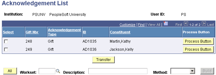

Access the Acknowledgement List page (Contributor Relations > Session Management > Acknowledgements > Acknowledgement List).
Image: Acknowledgement List page
This example illustrates the fields and controls on the Acknowledgement List page. You can find definitions for the fields and controls later on this page.
Note: If more than one person at your institution is assigned to one role, the acknowledgement appears on the acknowledgement lists of each person with that role. When you complete the acknowledgement, it is removed from the acknowledgement lists of all people with that role so a second letter is not accidentally sent.
Field or Control
Definition
Select
Process
Transfer
