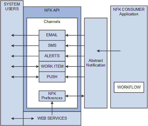

Finally, the items are checked for any errors or warnings, and if the items are found to be eligible for sending, then they are sent using the People Tools Notification Classes provided (PT_WF_NOTIFICATION.Notification App Class). The following diagram illustrates the relationships between the components of the framework:
Image: Notifications Framework High Level Architecture
This example illustrates the Notifications Framework High Level Architecture.

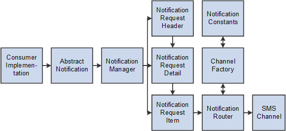

In the diagram above, the AbstractNotification class acts as a layer of encapsulation over the NotificationManager, which is the gateway for all consumers using the Notifications Framework. This is the Abstract Base class that consumers of the Notifications Framework should extend and implement in order to minimize consumer effort in sending notifications. After all processing is completed the NotificationRouter calls the applicable Notification Channel to deliver the notification type item/items created.
Image: Notifications Framework Communications Diagram
This example illustrates Notifications Framework Communications.

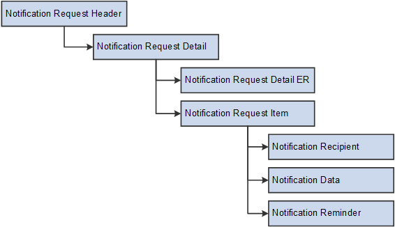

Notifications Framework Entities:
Entity |
Record |
Notes |
Notification Request Header |
SCC_NTFREQ_HDR |
N/A |
Notification Request Detail |
SCC_NTFREQ_DTL |
N/A |
NotificationRequestDetailER |
SCC_NTF_DTL_ER |
The NotificationRequestDetailER Entity is used to support multiple recipients like TO, CC, BCC for Email. This entity allows the framework to:
When an Email notification is to be sent to multiple recipients (TO, CC, BCC), the consumer needs to set the notification context property SCC_NTF_AUDCE to ‘ER’, EMPLID to null, and populate all the below properties as appropriate:
Notification Request Item |
SCC_NTFREQ_ITM |
N/A |
Notification Recipient |
SCC_NTFREQ_RECP |
N/A |
Notification Data |
SCC_NTFREQ_DATA |
N/A |
Notification Reminder |
SCC_NTFREQ_RMDR |
The Notification Reminder Entity is only used when a reminder notification is created for a previously generated notification. The Notification Reminder entity allows the framework to:
