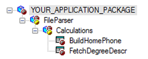

To create an application class:
At the appropriate level within your application package, insert an application class.
Save it with a meaningful name, reflective of what the application class is doing and is intuitive for the end user to select when defining the File Parser Mapping Definitions.
The following shows an example:
Image: Application package example

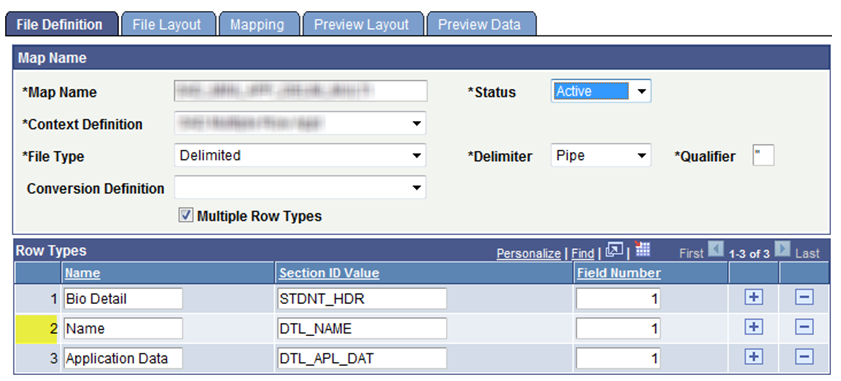

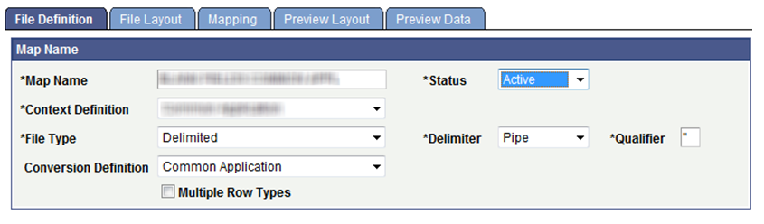

Step 2: Identify the Segment Number. This value is derived based upon the File Definition. If the File Definition does not contain Multiple Row Types (that is, you have not selected the Multiple Row Type check box), then the Segment Number will always be a value of 1 (one).
Image: File Definition page - Multiple Row Types is not selected
This example illustrates the fields and controls on the File Definition page - Multiple Row Types is not selected. You can find definitions for the fields and controls later on this page.
In this example, a Segment Number of 2 (two) would be used if fields contained within DTL_NAME are to be referenced:

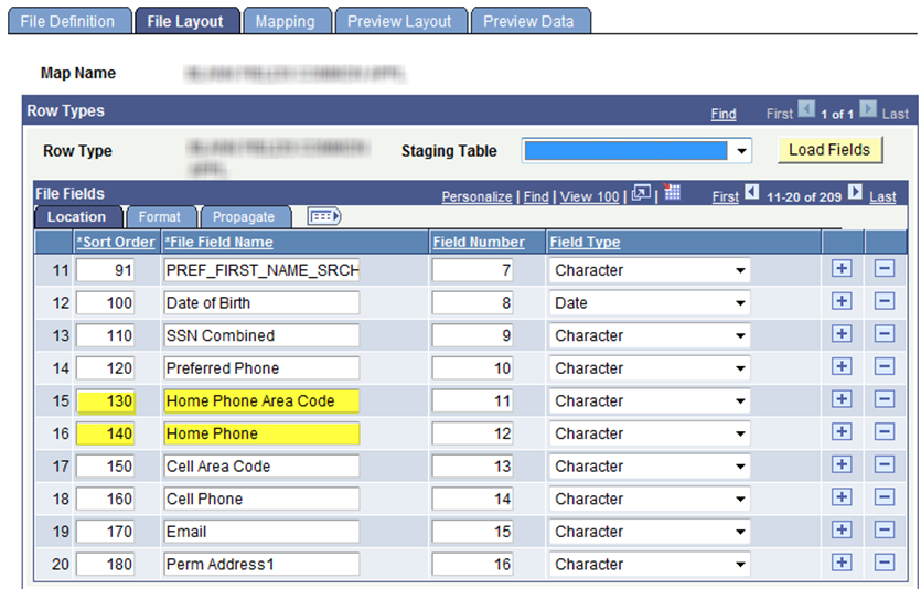

Step 3: Obtain the Sort Order Number(s). The Sort Order Number can be found on the File Layout page:
Image: File Layout - Location tab
This example illustrates the fields and controls on the File Layout - Location tab. You can find definitions for the fields and controls later on this page.
In the graphic we see that Home Phone Area Code has a Sort Order Number of 130, and the Home Phone Sort Order Number is 140.
Step 4: Write these values down to be referenced within your application class.
