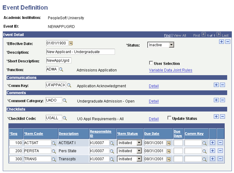

Access the Engine Event Definition page (Campus Community > 3C Engine > Set Up 3C Engine > Event Definition).
Image: Engine Event Definition page
This example illustrates the fields and controls on the Engine Event Definition page. You can find definitions for the fields and controls later on this page.
Event Detail
Field or Control
Definition
Function
Enter the functional area for this 3C engine event.
User Selection
Select this check box to enable users to select the communication, comment, and checklist to assign to transactions for this 3C engine event definition. When selected, the engine assigns only the communication, comment, and checklist specified by the user.
For example, if you license and use the Request Information self-service transaction in PeopleSoft Campus Self Service, you would select the User Selection option when defining a 3C engine event for the web prospects. That way, the prospects can select the communications that they want to receive.
See Setting Up Self-Service Request Information.
When not selected, the engine assigns all communications, checklists, and comments identified in this 3C engine event.
Variable Data Joint Rules
Click this link to access the Joint Rules Compare Fields page, where you can select the variable data fields that you want the system to compare to determine and assign joint communications.
Communications
Field or Control
Definition
Comm Key
Enter the Comm Key to specify the communication to assign as part of this 3C engine event.
Detail
Click this link to access the Event Communication Detail page, where you can view or edit the details of the specified Comm Key.
Comments
Field or Control
Definition
Comment Category
Enter the comment category for the comment to assign as part of this 3C engine event.
Detail
Click this link to access the Event Comment Detail page, where you can view or edit the details of the specific comment category.
Checklists
Field or Control
Definition
Checklist Code
Enter the checklist code for the checklist to assign as part of this 3C engine event.
Update Status
Select this check box for the 3C engine to update each checklist item to the specified status.
For example, you might include an item on the prospects checklist to require the assignment of a recruiter to each new prospect. You can create a 3C engine event definition to have the system automatically update that checklist item when you enter the new prospect into the database and assign the recruiter.
Sequence
The system automatically enters the next sequential number for each checklist item that you add. You can override the number manually to reorder the list of checklist items to be assigned as part of this 3C engine event.
Item Code
Enter the checklist item code for the checklist item to assign as part of this 3C engine event.
Available item codes are from the Checklist Item Functions page.
Responsible ID
Enter the ID of the individual at your institution who is responsible for this checklist item.
Item Status
Select the status of the checklist items to assign as part of this 3C engine event.
Due Days
Enter the number of due days associated with the checklist items to assign as part of this 3C engine event.
Due Date
Enter the due date associated with the checklist item to assign as part of this 3C engine event.
Comm Key
The Comm Key of the checklist to be assigned as part of this 3C engine event.
If the checklist to assign is of the default type that is set on the Installation_CC page (Communications List is the delivered default value), the system displays the Comm Key field. You can override this to select a different Comm Key.
