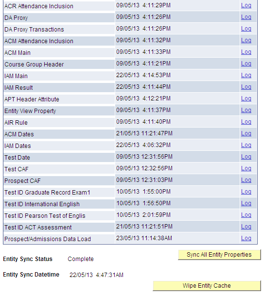

Sync All Entity Properties and Wipe Entity Cache
Click the Sync All Entity Properties button to start a Process Scheduler that performs the sync. The Sync All Entity Properties button is then replaced with a Refresh button so that you can check the status until the process is complete.
Running this process ensures that all the properties on every entity get updated to properly reflect the underlying record objects (stage record when it exists and production record). It does not reset the properties for which you may have manually changed the default setup.

After the sync process is complete, click the Wipe Entity Cache button. The cache wipe process wipes the entity registry cache on the appserver. You should perform a cache wipe each time that you run the sync process – after the process has completed successfully. This cache uses rowset caches to store entity registry meta-data. This avoids unnecessary trips to the databases, bringing significant increases to performance for all entity registry operations.
You should run a sync and wipe in these events:
  • Setting up a new database. This will make sure all your properties match the fields, and all your views match their underlying entity.
  • Importing data via dat/dms. Since dat/dms bypasses all processing logic, this fills in any holes.
  • If changes are made to records that have entities built on top of them via appdesigner. The sync process is the only way to update the entities to match the records. This can also be done on the entity registry component in a one-off manner.

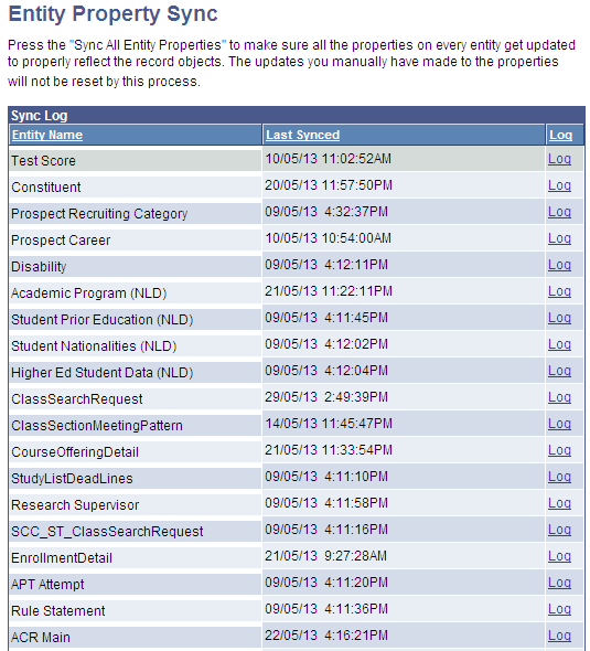

Sync Log
The full sync log grid is always shown on this page, showing all the entities that have been synced. If the sync was performed from the entity, as opposed to the Entity Property Sync page, the changes are also reflected here.

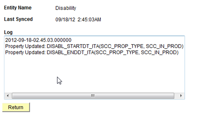

The grid also displays a Log link that enables you to view details of what was changed. Click the Log link to access the Sync Log page that provides a description of the fields that were added, removed, or changed:

The log grows over time, showing timestamped sections specifying the changes made.
