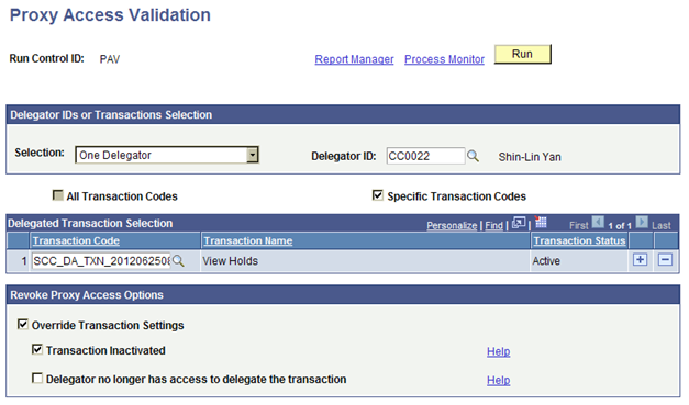

Access the Proxy Access Validation page ().
Image: Proxy Access Validation page
This example illustrates the fields and controls on the Proxy Access Validation page. You can find definitions for the fields and controls later on this page.
The batch process evaluates whether the Transaction Status is set to ‘Access Granted’. It also evaluates the transactions that are flagged as Real-time Updates by the PAV real-time process. This is when the SCC_DA_RLTM_UPD field is set to ‘Y’ in the SCC_DA_PRXY_TXN record.
When you run the batch process against a delegator or specific transactions, the PAV process evaluates only the transactions for the selected delegator or specified transaction codes. This means that transactions that have been updated during PAV real-time processing but do not belong to the selected delegator or transaction codes are not processed.
Delegator IDs or Transactions Selection
Use this group box to select the transactions or delegator EMPLIDs to process.

Select:
| Delegator ID |
Select a delegator ID for which to run the batch process. The field prompt only returns EMPLIDs for existing delegators. This field appears only when you select One Delegator from the Selection list. |
| All Transaction Codes or Specific Transaction Codes |
Select to run the batch process for one or specific transaction codes. When one option is selected, the other one is disabled. When you select Specific Transaction Codes, the Delegated Transaction Selection grid appears. |
Use this grid to add one or more transaction codes for which to run the batch process.
Revoke Proxy Access Options
Use this group box to override the transaction settings that you set up in the Delegation Transaction setup page.
Note: The option ‘Never’ is not applicable for PAV when run in batch.
