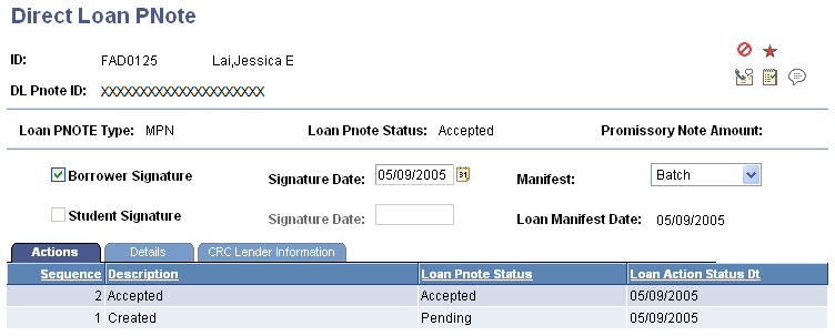

Access the Direct Loan PNote page ().
Note: The Direct Loan Pnote page can only be accessed if a Promissory Note Acknowledgement file is imported or if the school internally creates promissory notes to manage.
Image: Direct Loan PNote page: Actions tab
This example illustrates the fields and controls on the Direct Loan PNote page: Actions tab. You can find definitions for the fields and controls later on this page.
Note: Select the tabs on the page to access multiple views of this page. Fields common to all views are documented first.
Common Page Information
Field or Control |
Definition |
| DL Pnote ID |
Beginning with 2003-2004, direct loan application processing supports master promissory note requirements for the PLUS loan types. The system adds the letter N to the ID to indicate that the loan is PLUS Loan MPN. The system adds the letter M to indicate that the loan is a Stafford (subsidized or unsubsidized) Loan MPN. |
| Loan PNOTE Type (loan promissory note type) |
Displays the type of promissory note used for this loan. |
| Loan PNote Status (loan promissory note status) |
Displays the current status of the loan promissory note.
Note: Closed, Endorser, and Inactive MPN values are reported by COD. For disbursement purposes, the system treats Closed, Endorser, and Inactive MPNs as an Accepted MPN. For more information regarding how COD processes MPN's: See the U.S. Department of Education's Common Origination and Disbursement (COD) Technical Reference |

Actions Tab
Field or Control |
Definition |
| Sequence |
Displays the promissory note action sequence generated from the loan record activity. When multiple sequences exist for a promissory note, they display in reverse chronological order. |
| Description |
Displays a description for the displayed action code. |
| Loan Pnote Status (loan promissory note status) |
Displays the current status of the promissory note. Values are Accepted, Pending, and Rejected. |
| Loan Action Status Dt (loan action status date) |
Indicates the date when the loan action status activity occurred. |

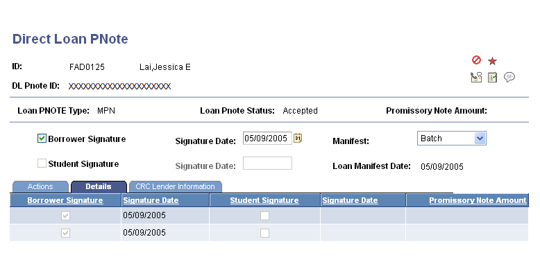

Details Tab
Select the Details tab.
Image: Direct Loan PNote page: Details tab
This example illustrates the fields and controls on the Direct Loan PNote page: Details tab. You can find definitions for the fields and controls later on this page.
Field or Control |
Definition |
| Borrower Signature |
Indicates whether the borrower has signed the promissory note. |
| Signature Date |
Displays the date that the Borrower Signature check box was selected, or the actual date the borrower signed the promissory note if you edited the signature date. |
| Student Signature |
This field is unavailable with PLUS loans when the borrower is not the student. |
| Signature Date |
Displays the date that the Student Signature check box is selected, or the actual date the student signed the promissory note if you edited the signature date. |
| Promissory Note Amount |
Displays the amount printed on the promissory note. |

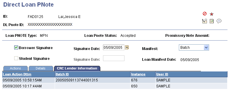

CRC Lender Information Tab
Select the CRC Lender Information tab.
Image: Direct Loan PNote page: CRC Lender Information tab
This example illustrates the fields and controls on the Direct Loan PNote page: CRC Lender Information tab. You can find definitions for the fields and controls later on this page.
Field or Control |
Definition |
| Loan Action Dttm (loan action date and time) |
Displays the date and time the loan promissory note status was posted. |
| Batch ID |
Displays the direct lending batch ID. |
| Instance |
Displays the number that the system assigns incrementally to count the occurrences of the processes you run. You can use this number to select the particular instance of the process for which you want to view the process results. |
| User ID |
Displays the ID of the person who ran the process. |
