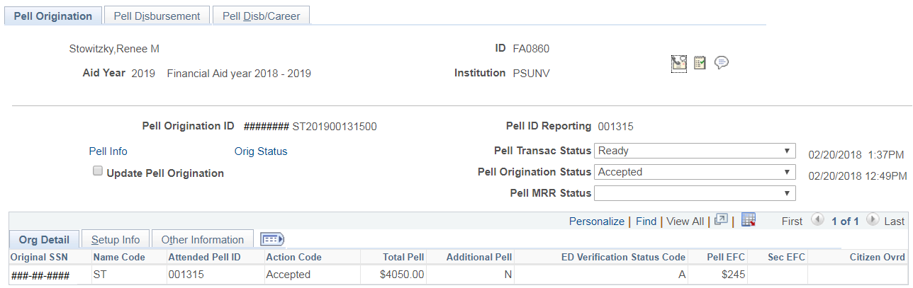

Access the Pell Origination page (Financial Aid > Pell Payment > Manage Pell Payment > Pell Origination).
Image: Pell Origination page, Org Detail tab
This example illustrates the fields and controls on the Pell Origination page, Org Detail tab. You can find definitions for the fields and controls later on this page.
Pell Origination page, Org (Origination) Detail tab
Field or Control
Definition
Pell Info (Pell information)
Click to access the Pell Information page to view or change the Pell processing status.
Orig Status (origination status)
Click to access the Pell Orig Action Detail page to view the Pell origination ID, action sequence, and batch number.
Update Pell Origination
Select to run origination again. This changes the Pell processing status back to pending. The origination process does not pick up anything with a status other than pending. The Pell Trans Status field must be set to Ready to run origination again.
Pell Transac Status (Pell transaction status)
Select a value to reset the status. Values are: Review, On Hold, Ready, Transmitted, and Cancel.
For example, if you receive a rejected record, the Pell transaction status is set to On Hold. You can correct the record, change the status to Ready, and resend the origination. After the system has transmitted the record, this field is unavailable until you receive an acknowledgment of the process.
Pell Origination Status
Displays the Pell origination status when the system transmits records. Values are:
Accepted: Indicates an accepted acknowledgment record.
Canceled: Indicates a canceled Pell award from the system. Run origination again to resend.
Change to Origination: Indicates that a change was made to the student's origination record. The origination build program sets this status after you run origination. This occurs if you cancel an award or if you select the student's record using the Update Pell Origination check box.
Corrected: Indicates an accepted record with corrections.
Originated: Indicates that the origination process ran successfully.
Rejected: Indicates a rejected record. If the record is rejected, the system sets the processing status to Review and the transmitted status to On Hold.
Transmitted: Indicates that a transmit record has been built and can be exported. A corresponding response record for the student must be received before you can run another process for the student. This includes running the origination build program, requesting an outbound of a subsequent origination record, or running the outbound disbursement process.
Pell MRR Status (multiple reporting record status)
Displays originations and disbursements reported by more than one institution for the same student. Use this information to identify and resolve potential over award payments and concurrent enrollments before they occur. When you request multiple reporting records and load them into the system, the status of the data updates this field.
Values are:
Blocked Institution
Blocked and Concurrent
Blocker Institution
Blocker/Concurrent Enrlm (blocker and concurrent enrollment)
Concurrent Enrollment Institution
Disbursed Institution
None Found
Originated Institution
Shared SAR ID (shared student aid report ID)
Unblocked Institution
Verification W (verification without documentation)
Org Detail
Field or Control
Definition
Original SSN (original social security number)
Displays the student's social security number from the original Free Application for Federal Student Aid (FAFSA).
Name Code
Displays the student's name code from the original FAFSA. If the social security number and name code do not match the origination ID, the system rejects the record.
Attended Pell ID
Displays the Pell ID of the campus that the student is attending.
Action Code
Displays a code to indicate the status of an acknowledgment record. Values are:
A: Accepted—all fields accepted.
C: Corrected—one or more fields corrected.
D: Duplicate.
E: Rejected—record was rejected.
Total Pell
Displays the student's total award amount for the school year.
Additional Pell
Displays Y if the student has been awarded Pell Grant in an amount greater than 100% of their Scheduled Federal Pell Grant amount for the year. In the Pell outbound file, the Additional Eligibility Indicator displays as TRUE.
Displays N if the student has not been awarded Pell Grant in an amount greater than 100% of their Scheduled Federal Pell Grant amount for the year or if the Pell Grant award has been canceled in its entirety for the year. In the Pell outbound file, the Additional Eligibility Indicator displays as FALSE.
Only displayed for Aid Years 2010 through 2012 and 2018 and beyond.
ED Verfication Status Code (department of education verification status code)
Displays the verification status of the applicant's data. Values are:
A: Accurate
C: Calculated
T: Tolerance
R: Reprocessed
V: Verified
W: Without documentation
S: Selected but not verified
Blank.
Note: When the system builds origination, it builds the value defined on the student aid attribute record or Packaging Status Summary. When you outbound the data, the system sets the value to that required by the technical reference record layout. The system sets the values V, W, S, or Blank.
Enroll Stat (enrollment status)
Note: This field is hidden beginning with the 2018 Aid Year. Enrollment status information is available via the Pell Disbursement page.
Not required to be reported. Displays the code that applies to the student's expected enrollment status for the award year. Values are:
  • 1: Full-time
  • 2: Three-quarter-time
  • 3: Half-time
  • 4: Less than half-time
  • 5: No Load. This value is not evaluated for 2017 and earlier aid years.
Pell EFC (Pell expected family contribution)
Not required to be reported. Displays the student's EFC from the Institutional Student Information Record (ISIR) or Student Aid Report (SAR).
Sec EFC (secondary expected family contribution)
Displays a code to indicate which expected family contribution value is used to determine the award amount. Values are:
0: Pell award was reported previously based on the secondary EFC. Award is now based on the original EFC.
S: The Pell Grant award is based on the secondary EFC.
Citizen Ovrd (citizenship override)
Select to report a local override of the student's citizenship status. This field is display only when the record is transmitted, corrected, or acknowledged or when a Multiple Reporting Record file is loaded. Valid values are Ineligible, NonCitizen and, US Citizen.

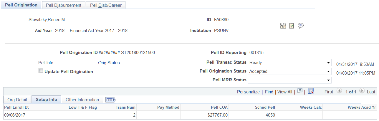

Setup Info
Select the Setup Info tab.
Image: Pell Origination page: Setup Info tab
This example illustrates the fields and controls on the Pell Origination page: Setup Info tab. You can find definitions for the fields and controls later on this page.
Pell Origination page: Setup Info (information) tab
Field or Control
Definition
Pell Enroll Dt (Pell enrollment date)
Displays the first date on which the student was enrolled in an eligible program for the designated school year.
Low T&F Flag (low tuition and fees flag)
The system uses this field to identify tuition ranges when the annual tuition falls into the low tuition category as mandated by the Department of Education for each award year. Values are: (none), O, Range 1, Range 2, Range 3, and Range 4.
Trans Num (transaction number)
Displays the transaction number from an eligible ISIR or SAR used to calculate the award.
Pay Method
Not required to be reported. Displays the payment method formula.
Pell COA (Pell cost of attendance)
Displays the cost of attendance used to calculate the Pell award amount. It must equal the COA calculated by the institution following the Pell Grant payment regulations.
Sched Pell (schedule Pell)
Displays the maximum amount of the Pell award for which a student is eligible based on full-time enrollment. The student cannot exceed the scheduled Pell award amount.
Weeks Calc (weeks calculated)
Not required to be reported. Displays the number of weeks of instructional time in which the student is enrolled and paid, as part of the academic year or program as defined for each payment methodology.
Weeks Acad Yr (weeks academic year)
Not required to be reported. Displays the number of weeks of instructional time in the program's academic year.
Other Information

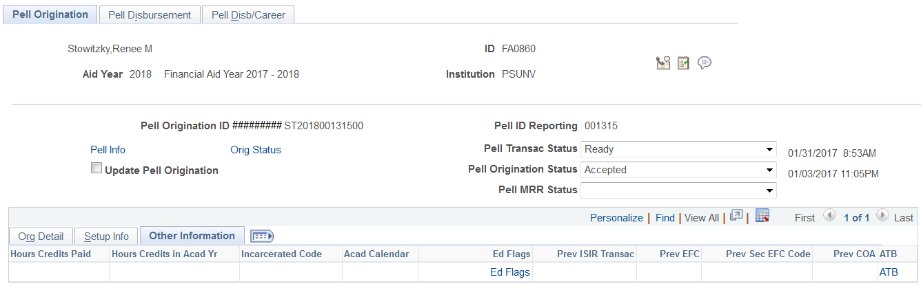

Select the Other Information tab.
Image: Pell Origination page: Other Information tab
This example illustrates the fields and controls on the Pell Origination page: Other Information tab. You can find definitions for the fields and controls later on this page.
Field or Control
Definition
Hours Credits Paid
Not required to be reported. Displays the number of credit or clock hours that the student is expected to complete and receive payment.
Hours Credits in Acad Yr (hours credits in academic year)
Not required to be reported. Displays the number of hours or credits in the program’s academic year.
Incarcerated Code
Displays one of these values:
N: No longer incarcerated
Y: Incarcerated
(blank): Not incarcerated.
Acad Calender (academic calendar)
Not required to be reported. Indicates the calendar that applies to the student's educational program and determines which payment methodology is accepted. Credit hours with standard terms of quarters or credit hours with standard terms of semesters or trimesters are examples of academic calendars.
Ed Flags (department of education flags)
The system activates this link when a record is inbound. Click to view the education use flags from the inbound record. These are set to inform you of modifications that were made to your database. Education use flags are also activated when the record is rejected, and they require immediate action.
Prev ISIR Transac (previous institutional student information record transaction)
Displays the previous ISIR transaction, if a change has been made.
Prev EFC (previous expected family contribution)
Displays the previous expected family contribution, if a change has been made.
Prev Sec EFC Cd (previous secondary expected family contribution code)
Displays the previous secondary expected family contribution.
Prev COA (previous cost of attendance)
Displays the previous cost of attendance based on a change to the student's cost of attendance.
ATB (ability to benefit)
Displays a link to Ability to Benefit information if present. Click the link to view Ability to Benefit data.
See Managing Ability to Benefit.
