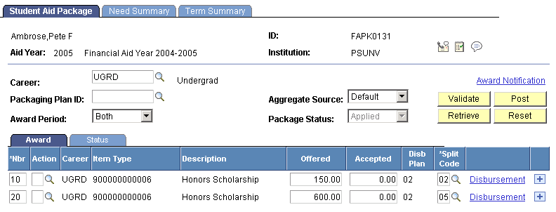

The following screen shots illustrate how the Award Posting process handles the two instances of the University Grant. In the first shot, both instances of the Financial Aid Item Type are visible.
The navigation path to the page is
Image: Student Aid Package page with two instances of Honors Scholarship
This example illustrates the Student Aid Package page with two instances of Honors Scholarship.

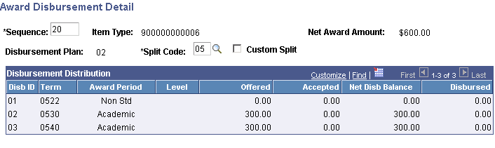

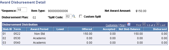

The next two screen shots show the disbursement detail for each instance of the Honor Scholarship.
Image: Award Disbursement Detail page for the first instance of the Honors Scholarship
This example illustrates the Award Disbursement Detail page for the first instance of the Honors Scholarship.
Image: Award Disbursement Detail page for the second instance of the Honors Scholarship
This example illustrates the Award Disbursement Detail page for the second instance of the Honors Scholarship.

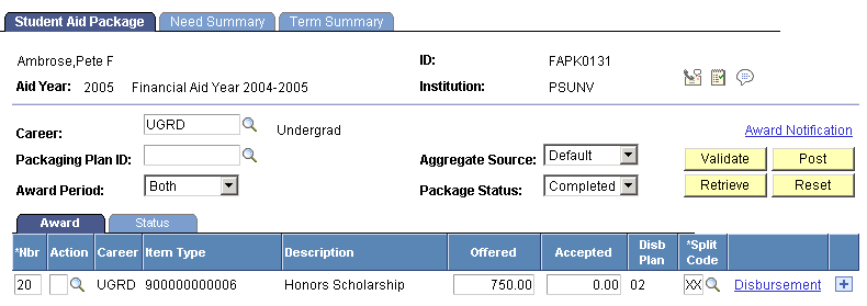

The next screen shot shows how the two instances of the University Grant Financial Aid Item Type are combined after posting. Notice that the Split field contains XX, indicating a custom split:
Image: Student Aid Package page after posting—the two separate instances are combined, with a custom split
This example illustrates the Student Aid Package page after posting—the two separate instances are combined, with a custom split.
When you look at the disbursement detail for the University Grant, you can see that Packaging has retained the disbursements dictated by the two separate instances of the University Grant
Image: Award Disbursement Detail page for the combined Honors Scholarship
This example illustrates the Award Disbursement Detail page for the combined Honors Scholarship.

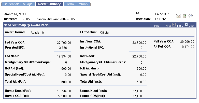

The Need Summary page also retains the separate disbursements:
Image: Need Summary page displaying AAP information and disbursements
This example illustrates the Need Summary page displaying AAP information and disbursements.

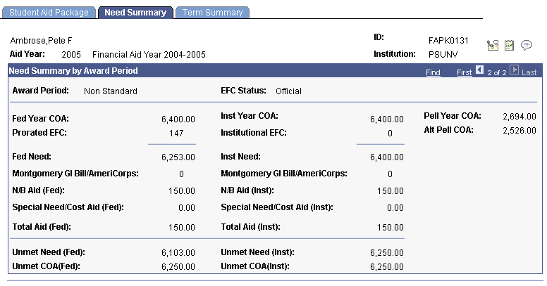

Image: Need Summary page displaying NSAP information and disbursements
This example illustrates the Need Summary page displaying NSAP information and disbursements.
