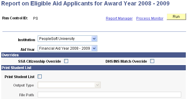

Access the Report on Eligible Aid Applicants for Award Year 20nn - 20nn page ().
Image: Report on Eligible Aid Applicants for Award Year 20nn - 20nn page
This example illustrates the fields and controls on the Report on Eligible Aid Applicants for Award Year 20nn - 20nn page. You can find definitions for the fields and controls later on this page.
The system populates, by default, the run controls set up on the Financial Aid Run Controls page. The file name for reports that are generated by this SQR is FAPFSPnn_XX.PDF, where nn is the aid year and XX is the processing instance.
Field or Control |
Definition |
| Institution |
Select the institution for which you want to generate the FISAP report. This list reflects those institutions or satellite campuses that you have previously identified. |
| Aid Year |
Select the aid year for which you are reporting, not the aid year for which you are applying. |
| SSA Citizenship Override |
Select if you want the report to include students with an SSA Citizenship Indicator override on the Database Matches page as eligible citizens on the FISAP. |
| DHS/INS Match Override |
Select if you want the report to include students with a DHS/INS Match override on the Database Matches page as eligible citizens on the FISAP. |
| Print Student List |
When you select this check box, the system prints an itemized list of all students in these two sections: Part II Section F and Part VI Section A. |
| Output Type |
Select from: Both Paper and CSV File, CSV File, and Paper. When you select Both Paper and CSV File, the system creates five separate and distinct comma delimited files in the location entered in the File Path field. The details are described as follows: ELIGAPPL: Eligible Applicant Detail: This file is an itemized list of the student data counted in Part II Section F. The file is sorted in the following order: by report column letter, by FISAP Total Income, and then by EMPLID. After the system prints the details of each report column letter, it prints a row with the totals for that column letter. The remaining four files are itemized details of Part VI Section A by fund. DISTFWSP: Federal Work Study Distribution Detail DISTPERK: Perkins Distribution Detail DISTSEOG: SEOG Distribution Detail DISTUNDP: Unduplicated Count Detail The four distribution files are sorted in the following order: by Student Type, by FISAP Total Income, and then by EMPLID. Student Type is defined as follows: 1DUG: Dependent Undergraduate Students 2IUG: Independent Undergraduate Students 3GRAD: Graduate Students 4LTFT: Less Than Full Time Students 50EFC: Automatic Zero EFC Students |
| File Path |
Enter the file path and directory name where the CSV file should be written. The process scheduler server must be able to read and write to this path. |
