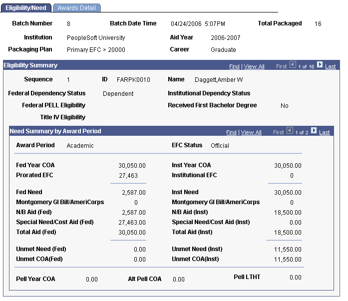

Access the Eligibility/Need page ().
Image: Eligibility/Need page
This example illustrates the fields and controls on the Eligibility/Need page. You can find definitions for the fields and controls later on this page.
This page displays information for a single packaging plan. To see other students packaged using the selected packaging plan, use the top set of scroll arrows. Use the bottom set of scroll arrows to view the information for each student by award period.
Field or Control |
Definition |
| Sequence |
The sequence number indicates the order in which students were packaged during Mass Packaging. |
| Federal Dependency Status |
Indicates whether the student is dependent or independent under federal methodology. |
| Institutional Dependency Status |
Indicates whether the student is dependent or independent under institutional methodology. |
| Federal PELL Eligibility |
Indicates whether the student is eligible to receive a Pell Grant. |
| Received First Bachelor Degree |
Indicates whether the student has already received his or her first bachelor's degree. |
| Title IV Eligibility |
Indicates whether the student is eligible to receive federal Title IV aid. |
