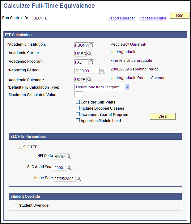

Access the Calculate Full-Time Equivalence page ().
Image: Calculate Full-Time Equivalence page
This example illustrates the fields and controls on the Calculate Full-Time Equivalence page. You can find definitions for the fields and controls later on this page.
This process uses the same FTE logic as the FTE process for student records with the addition of the SLC FTE Parameters to determine if there is an ACR record which requires a response. For more information about calculating FTE for HESA and SLC:
See Calculating Full-Time Equivalence for Students.
For this process to calculate the FTE for SLC ACR reporting properly, you should follow the set up guidelines in the (GBR) Setting Up Student Loans Company.
In the SCL FTE Parameters group box, all 3 parameters, HEI Code, SLC Acad Year, and Issue Date are required.
