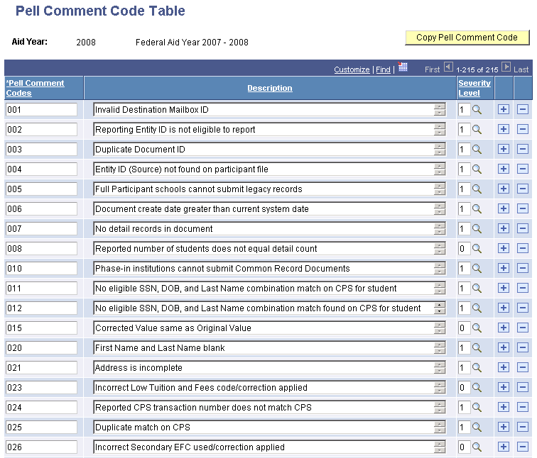

Access the Pell Comment Code Table page ().
Image: Pell Comment Code Table page
This example illustrates the fields and controls on the Pell Comment Code Table page. You can find definitions for the fields and controls later on this page.
This page defines the Pell Comment Codes from the Department of Education.
Field or Control |
Definition |
| Pell Comment Codes |
Lists the identification number assigned to a specific Pell comment. |
| Description |
Describes the Pell comment code. |
| Severity Level |
Select one of the following severity levels to indicate the action that you want the system to take. 0 - Ignore: The system disregards the message. 1 - Action Required: The institution's Pell processor is required to take action to resolve the issue. |
| Copy Pell Command Code |
Click this button to access the Copy Pell Comment Codes page, where you can copy the setup data from one aid year to another. |

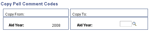

Access the Copy Pell Comment Codes page (click the Copy Pell Comment Code button on the Pell Comment Code Table page).
Image: Copy Pell Comment Codes page
This example illustrates the fields and controls on the Copy Pell Comment Codes page.
Select an aid year from the values in the Copy To group box.
