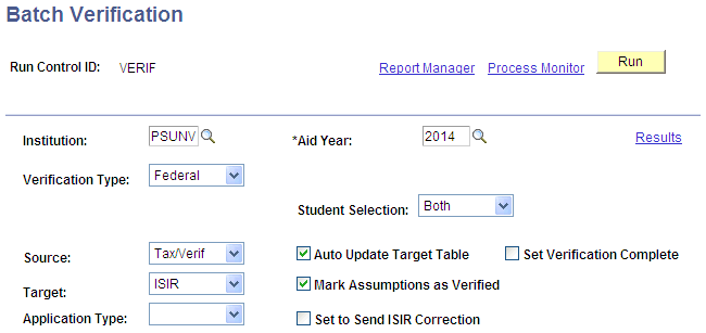

Access the Batch Verification page ().
Image: Batch Verification page
This example illustrates the fields and controls on the Batch Verification page. You can find definitions for the fields and controls later on this page.
Use the Batch Verification page to run verification for all students selected, according to the criteria that you establish.
Field or Control |
Definition |
| Verification Type |
Select from these values: Federal: Select to apply federal setup rules to this verification. Institutional: Select to apply institutional setup rules to this verification. |
| Source |
Verification is the process of comparing source data to a target set of data. This is a translate field, and translate values should not be adjusted. Select from these values: Inst App: Data from the Maintain Institutional Application tables ISIR: Data from the ISIR Data Corrections tables Tax/Verif: Selected data from the Application Data Verification pages created from the Consolidate routine |
| Target |
This is a translate field, and translate values should not be adjusted. Select from these values: Inst App: Data from the Maintain Institutional Application tables ISIR: Data from the ISIR Data Corrections tables |
| Application Type |
Values are valid with a source or target of Inst App only and include the following: Inst App: Institutional application PROFILE: PROFILE application FT – CSL: Full-time Canadian student loan PT – CSL: Part-time Canadian student loan |
| Student Selection |
Select from the following values: Both: Processes records with a verification status of either pending or required. Pending: Processes records with a verification status of pending only. Required: Processes records with a verification status of required only. |
| Auto Update Target Table |
Automatically updates the target table with verified data identified with a variance. |
| Mark Assumptions as Verified |
Use this check box only when the Source value is Tax/Verif and the Target value is ISIR. Select to tag fields originally identified as Assumption fields with a field status of Verified. Assumed ISIR data fields that result from the federal methodology calculation are maintained on secondary pages of the ISIR Data Corrections pages. |
| Set to Send ISIR Correction |
Select to set the Correction Status to Send on ISIR Corrections when the Auto Update Target Table is used. |
| Set Verification Complete |
Select to automatically set the Verification Status to Complete. This field is enabled only when the Auto Update Target table is activated. |
