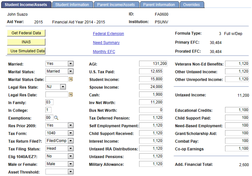

Access the Student Income/Assets page ().
Image: Student Income/Assets page
This example illustrates the fields and controls on the Student Income/Assets page.
ISIR edits are not used in the simulation pages. Changes used should not conflict with data in ISIR corrections.

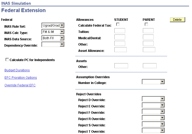

Access the INAS Simulation Federal Extension page (click the Federal Extension link on the Student Income/Assets page).
Image: INAS Simulation Federal Extension page
This example illustrates the fields and controls on the INAS Simulation Federal Extension page. You can find definitions for the fields and controls later on this page.
Field or Control |
Definition |
| Budget Durations |
Click this link to access the INAS Simulation Budget Durations page. You can enter any value for FM budget duration. Federal rules allow whole numbers only for budget duration. If the total allocation for the budget duration is greater than 12 months, a 9–month EFC is calculated and used in the academic award period, and no EFC is calculated for the non-standard award period. |
| EFC Proration Options |
Click this link to access the INAS Simulation EFC Proration Options page to determine how to prorate EFC. |
| Override Federal EFC |
Click this link to access the INAS Simulation EFC Override page to override the academic or non-standard parent contribution or student contribution. |

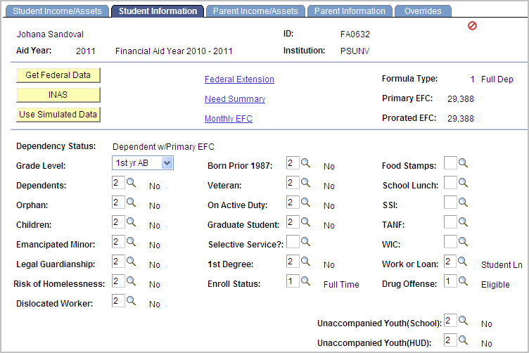

Access the Student Information page ().
Image: Student Information page
This example illustrates the fields and controls on the Student Information page. You can find definitions for the fields and controls later on this page.
Field or Control |
Definition |
| Grade Level |
Select from: 1st yr AB (attended before) 1st yr GP (graduate professional) 1st yr NA (never attended) 2nd yr Sph (sophomore) 3rd yr Jnr (junior) 4th yr Snr (senior) 5th yr UG (undergraduate) Grad/Prof + (graduate/professional beyond 1st year) |
Field Name Abbreviations and Explanations
On Active Duty (active duty status for US Armed Forces)
School Lunch (free or reduced price lunch)
SSI (Supplemental Security Income)
TANF (Temporary Assistance for Needy Families)
WIC (Women, Infants and Children)
Unaccompanied Youth (HUD) (Unaccompanied Youth – Housing and Urban Development)

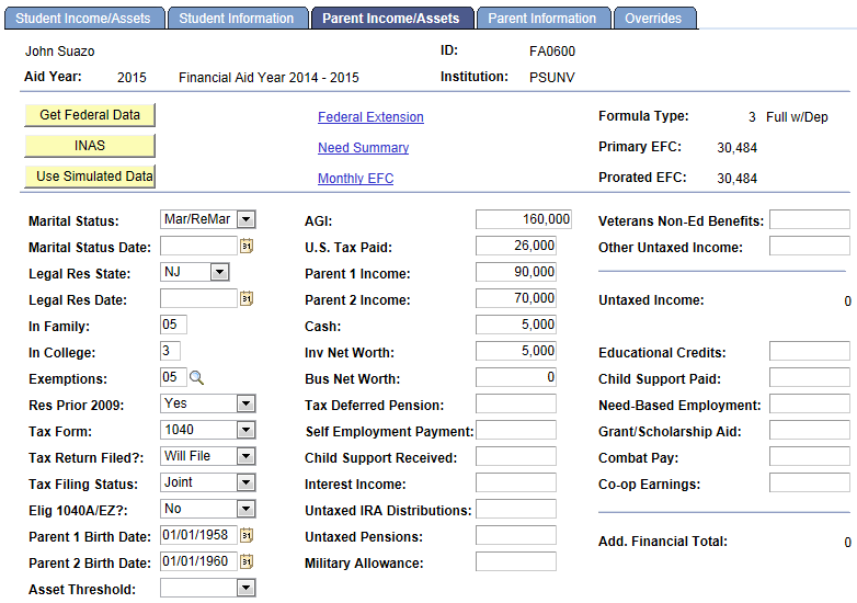

Access the Parent Income/Assets page ().
Image: Parent Income/Assets page
This example illustrates the fields and controls on the Parent Income/Assets page.

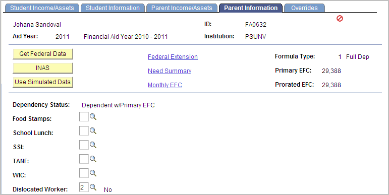

Access the Parent Information page ().
Image: Parent Information page
This example illustrates the fields and controls on the Parent Information page. You can find definitions for the fields and controls later on this page.

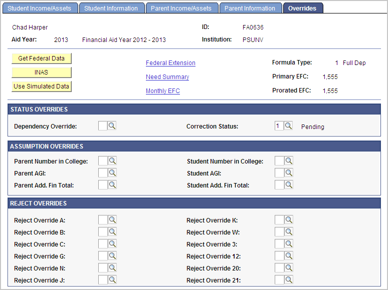

Access the Overrides page ().
Image: Overrides page
This example illustrates the fields and controls on the Overrides page. You can find definitions for the fields and controls later on this page.
STATUS OVERRIDES
Field or Control |
Definition |
| Dependency Override: |
Values include: 1: Dependent to Independent. You can select this value. 2: Cancel Dep Override – Corr Only. You can select this value. 3: Override Failed. The correction process sets this value. |
| Correction Status: |
Values include: 1: Correction(s) Pending. You can select this value. 2: Send Correction(s). You can select this value. 3: Correction(s) Sent. The correction process sets this value. 4: Correction(s) Accepted. The correction process sets this value. 5: Corrections Rejected. The correction process sets this value. 6: Do Not Send Correction(s). You can select this value. |
ASSUMPTION OVERRIDES
Field or Control |
Definition |
| Parent Number In College |
Select 1:Yes. |
| Parent AGI (parent adjusted gross income) |
Select 1:Yes. |
| Parent WKC Assumed Zero (parent income from worksheet C assumed 0) |
Select 1:Yes. |
| Student Number In college |
Select 1:Yes. |
| Student AGI (student adjusted gross income) |
Select 1:Yes. |
| Student WKC Assumed Zero (student income from worksheet C assumed 0) |
Select 1:Yes. |
REJECT OVERRIDES
Select 1: Yes to override a listed reject.
