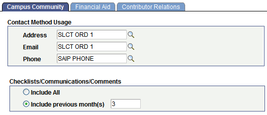

Access the Campus Community page ().
Image: Campus Community page
This example illustrates the fields and controls on the Campus Community page. You can find definitions for the fields and controls later on this page.
The fields on this page enable you to define the data that should be included in the EIPs that populate the Summary portion of the CRM 360-degree view.
Contact Method Usage
The Address, Email, and Phone fields define the order in which the system searches for and uses the associated data. Address and phone usage settings are defined on the Address Usage and Phone Usage pages in PeopleSoft Campus Community.
Checklists/Communications/Comments
A large volume of data pertaining to 3Cs may be available. Use these options to limit the data that should be sent to populate the CRM 360-degree view. You can either Include All data or data for the past few months. By entering a value for Include previous month(s), such as 3, you limit the 3C data to the past 3 months. Three months is the recommended 3C period to avoid potential data relevance and performance issues; however, your institution should adjust this period according to its business processes.

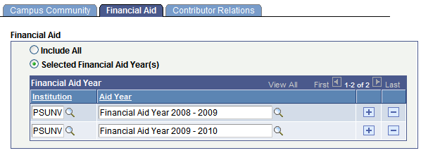

Access the Financial Aid page ().
Image: Financial Aid page
This example illustrates the fields and controls on the Financial Aid page. You can find definitions for the fields and controls later on this page.
The fields on this page enable you to define the data that should be included in the EIPs that populate the Financial Aid portion of the CRM 360-degree view. That page displays one aid year at a time in the grid, and lists the current aid year first.
Select the option to Include All financial aid year data for a person in the message sent to CRM 360-degree view, or only data from Selected Financial Aid Year(s).

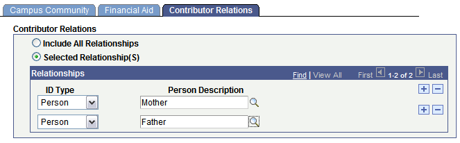

Access the Contributor Relations page ().
Image: Contributor Relations page
This example illustrates the fields and controls on the Contributor Relations page. You can find definitions for the fields and controls later on this page.
The fields on this page enable you to define Person/Org Relationship data that should be included in the EIPs that populate the Contributor Relations portion of the CRM 360-degree view. That part of the 360-degree view displays all summarized giving information for the relationship.
It is possible that a constituent may have relationships with other persons and organizations, and the default value on this page is to Include All Relationships. However, your institution may not want to include every relationship in the CRM 360-degree view. So, select a relationship option to define what relationships are applicable to be sent to CRM. If you choose Selected Relationship(s), then you must select the ID Type and Person Description for each selected relationship. Only those relationships selected here will be applicable for sending across to CRM 360-degree view. Selecting pertinent relationships only, such as parents or spouse, is recommended.

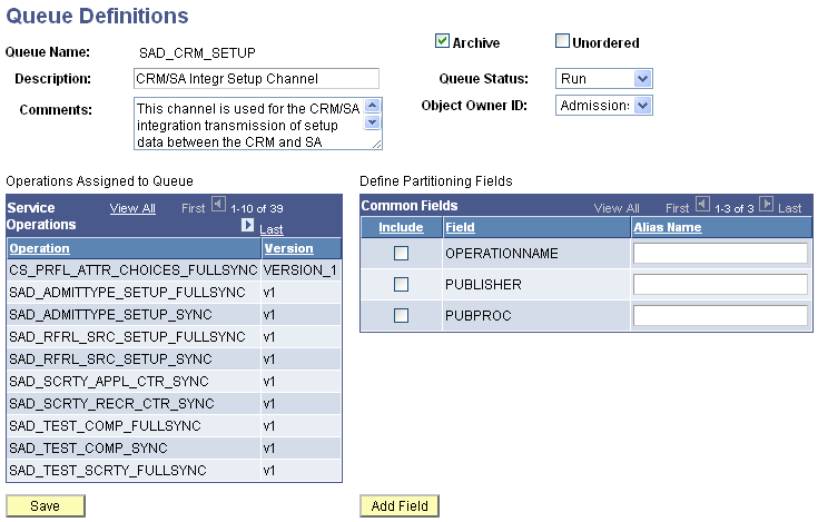

To set up queues:
Select
Change the Queue Status to Run for the following queues, if they are not already set: SAD_CRM_SETUP, SAD_CRM_DATA, PERSON_DATA.
Image: Example of setup on Queue Definitions page
This example illustrates the fields and controls on the Example of setup on Queue Definitions page. You can find definitions for the fields and controls later on this page.

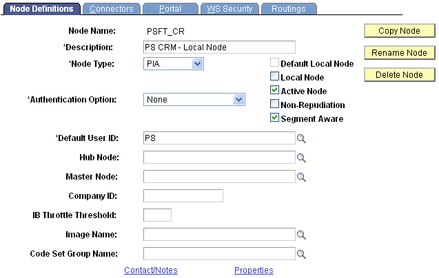

To manually set a node as segment aware and configure a node to handle segmented messages:
Select
Select the CRM node (PSFT_CR) with which to work and click the Search button.
The Node Definitions page appears.
Select the Segment Aware check box.
Click the Save button.
Image: Example of setup on Node Definitions page
This example illustrates the fields and controls on the Example of setup on Node Definitions page. You can find definitions for the fields and controls later on this page.
