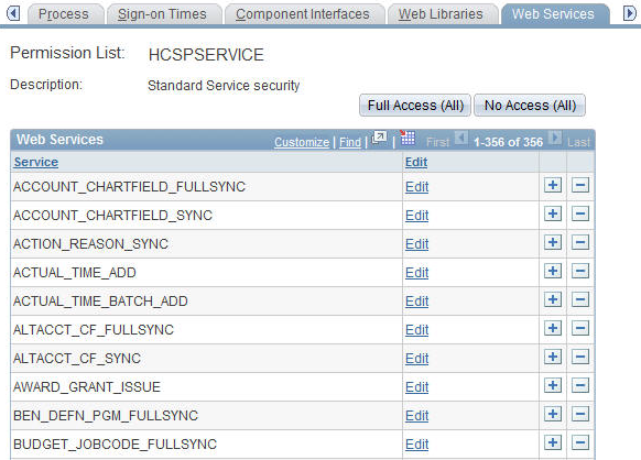

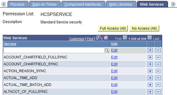

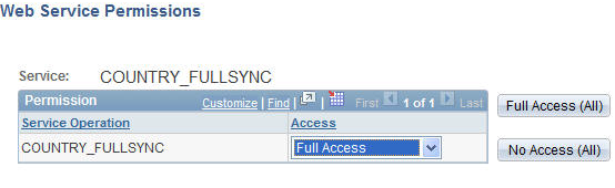

Update security by adding the Service Operation(s) to your primary permission list:
Navigate to
Select the relevant permission list from the search dialog box.
Select the Web Services tab.
Enter the corresponding Service(s) for the Service Operation(s) you wish to use.

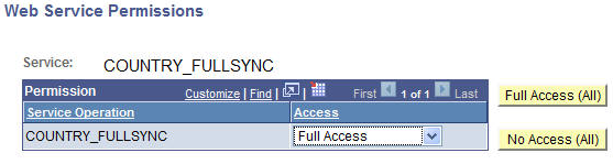

Click the Edit link. On the Web Service Permissions secondary page, add access to the relevant Service Operation(s) listed by selecting the Full Access option for the Access column.
Image: Web Services page-Permission List
This example illustrates the fields and controls on the Web Services page-Permission List.
Image: Web Services Permissions page
This example illustrates the fields and controls on the Web Services Permissions page for HCM.

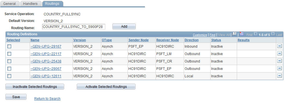

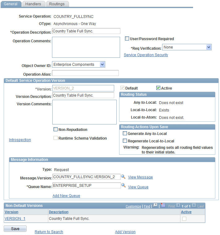

Activate Service Operations and create Routings.
Navigate to
Select the relevant Service Operation(s) from the search dialog box.
Check the Active check box on the General tab.
Make note of the Queue Name field, as you need to verify later that the Queue status is Running.

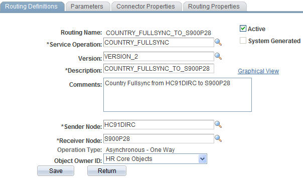

Select the Routings tab and add a new routing for the Service Operation by entering a value in the Routing Name field and clicking the Add button.
Image: General page
This example illustrates the fields and controls on the General page for the COUNTRY_FULLSYNC service operation.
Image: Routings page
This example illustrates the fields and controls on the Routings page for the COUNTRY_FULLSYNC service operation.

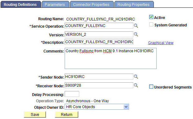

Enter a Sender Node and a Receiver Node on the Routings Definition page of the Routings component.
Verify that the Active check box is checked.
Save the routing.
Click the Return button at the bottom of the Routings Definition page to return to the Service Operation setup component.
Click Save at the bottom of any page in the Service Operations component to save the Service Operation.
Image: Routing Definitions page
This example illustrates the fields and controls on the Routing Definitions page for the COUNTRY_FULLSYNC service operation.

Click the Edit link and add access to the relevant Service Operation(s) listed on the Web Service Permissions secondary page.

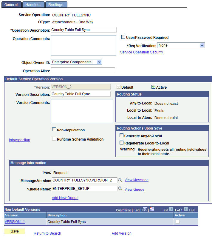

Activate Service Operation and Create Routing.
Navigate to .
Select the Active check box on the General tab.
Image: General page

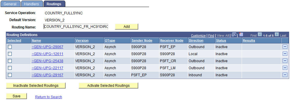

Select the Routings tab and add a new routing for the Service Operation.
Click Save at the bottom of the Routings Definition page to save the routing.
Click the Return at the bottom of the Routings Definition page to return to the Service Operation setup component.

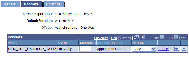

Activate or create the required Service Operations OnNotify handler.
Click the Handlers tab of the Service Operations component and set up the following:
Image: Handlers page
This example illustrates the fields and controls on the Handlers page for the COUNTRY_FULLSYNC service operation.
Field or Control
Definition
Name Enter a Handler Name if one does not exist. For example, BusUnitHRFullSync.
See the Full Sync Service Operations table (Application Package Name/ Class/ Method column) for the required value for this field.
Type OnNotify
Implementation Application Class
Status Active

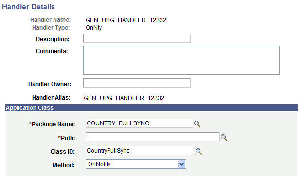

Click the Details link and set up the following:
Image: Handler Details page
This example illustrates the fields and controls on the Handler Details page.
Field or Control
Definition
Package Name For example, GEN_UPG_HANDLER_12332. See the FullSync Service Operations table (Application Package Name/ Class/ Method column) for the required value for this field.
Path :
Class ID For example, CountryFullSync. See the FullSync Service Operations table (Application Package Name/ Class/ Method column) for the required value for this field.
Method OnNotify
Click OK to return to the Handlers setup page.
Click Save at the bottom of the Handlers page to save your changes.

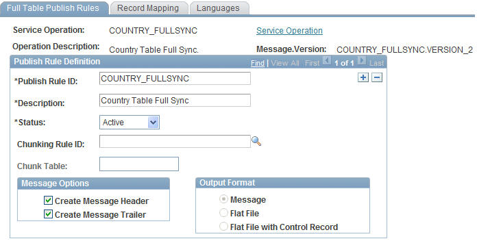

Define Full Data Publish Rules.
Navigate toand set up the following:
Image: Full Table Publish Rules page
This example illustrates the fields and controls on the Full Table Publish Rules page for the COUNTRY_FULLSYNC service operation.
Field or Control
Definition
Message Name Name of the Service Operation.
Publish Rule ID Enter a publish rule ID.
Description Enter a description of the Publish Rule.
Status Set to Active.
Check the Create Message Header and Create Message Trailer check boxes.
Save the page.

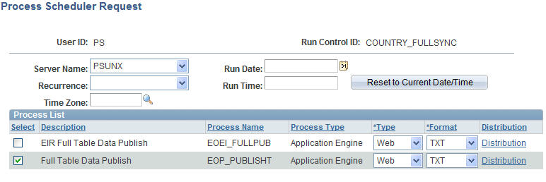

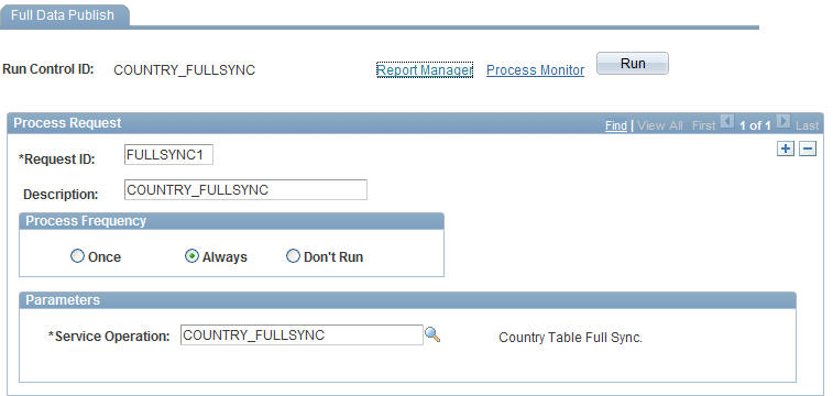

Execute the Full Data Publish Process.
Navigate to and set up the following:
Image: Full Data Publish page
This example illustrates the fields and controls on the Full Data Publish page.
Field or Control
Definition
Run Control ID Create a new Run Control ID.
Request ID Enter a Request ID.
Process Frequency Select Always.
Parameters Select the existing Service Operation, for example, COUNTRY_FULLSYNC.
Save the page and click Run.
Select the Full Table Data Publish process from the Process Scheduler Request page and verify that the process runs successfully.
Image: Process Scheduler Request
This example illustrates the fields and controls on the Process Scheduler Request page where the Full Table Data Publish process is selected.

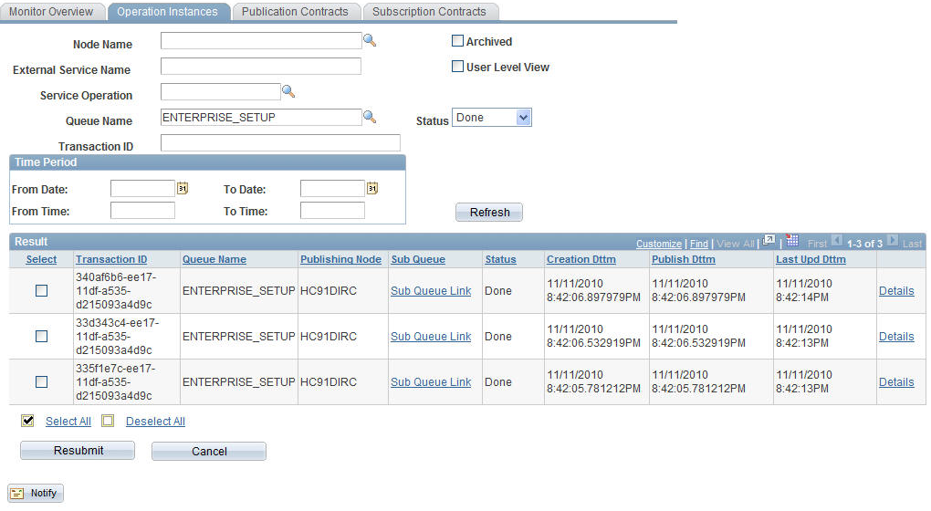

Navigate to to review the status of the Full Sync messages created by the Full Data Publish process.
Image: Operation Instances page
This example illustrates the fields and controls on the Operation Instances page to monitor asynchronous service operations.
