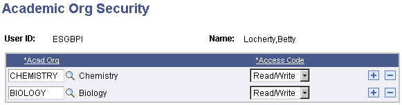

Example 1
This security setup grants the user ID access to all academic organizations under the Biology and the Chemistry nodes in the security tree:
Image: Permission for specific academic organizations (SCRTY_TABL_ACAD)
This example illustrates the fields and controls on the Permission for specific academic organizations (SCRTY_TABL_ACAD). You can find definitions for the fields and controls later on this page.

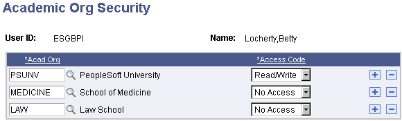

Example 2
This security setup grants this user ID access to all academic organizations under the PeopleSoft University node except any that fall under the School of Medicine or Law School node:
Image: Permission with restrictions for academic organizations (SCRTY_TABL_ACAD)
This example illustrates the fields and controls on the Permission with restrictions for academic organizations (SCRTY_TABL_ACAD). You can find definitions for the fields and controls later on this page.
The School of Medicine and Law School are excluded because the access code is set to No Access.
