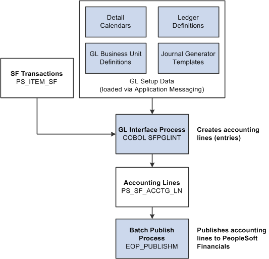

This diagram illustrates how the PeopleSoft Financials GL Interface process creates accounting lines for Student Financials transactions:
Image: GL Interface process with PeopleSoft Financials integration

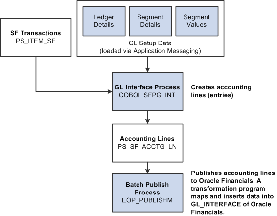

This diagram illustrates how the Oracle Financials GL Interface process creates accounting lines for Student Financials transactions:
Image: GL Interface process with Oracle Financials integration
If you interact with PeopleSoft or Oracle Financials, the system uses application messaging to share accounting line information with PeopleSoft or Oracle General Ledger.
