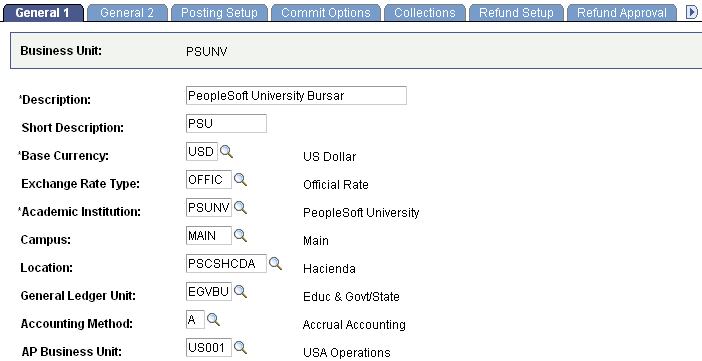

Access the General 1 page ().
Image: General 1 page
This example illustrates the fields and controls on the General 1 page. You can find definitions for the fields and controls later on this page.
Field or Control |
Definition |
| Base Currency |
Confirm or select the base currency that you want this business unit to use. The default value is the base currency selected for the institution in . You can override the base currency for each business unit. |
| Exchange Rate Type |
Select the exchange rate type that you use to convert other currency types to the base currency. The exchange rate type is necessary for the posting of charges. Note: You define exchange rate types on the Currency Rate Type field (same navigation as above). |
| Academic Institution |
Identify the academic institution that contains the SF business unit. |
| Campus |
Enter the appropriate campus for the SF business unit. |
| Location |
Enter the appropriate location for the SF business unit. |
| General Ledger Unit |
If your institution uses PeopleSoft Financials, select the general ledger unit that receives information from the SF business unit. Otherwise, leave this field blank. |
| Accounting Method |
Select your institution's accounting method: Accrual, Cash, or Modified Cash accounting. |
| AP Business Unit |
Select the business unit with which your system interacts when processing refunds through the accounts payable department. |

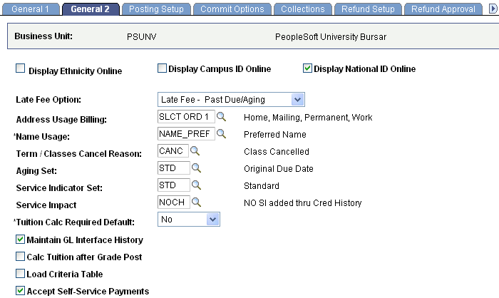

Access the General 2 page ().
Image: General 2 page
This example illustrates the fields and controls on the General 2 page. You can find definitions for the fields and controls later on this page.
Field or Control |
Definition |
| Display Ethnicity Online |
Select this option if you want the student's ethnicity to appear on the Academic Information page. |
| Display Campus ID Online |
Select this option if you want the campus ID to appear on the Academic Information page. The campus ID identifies the campus, not the student. |
| Display National ID Online |
Select this option if you want the student's national ID (for example, social security number) to appear on the Academic Information page. |
| Late Fee Option |
Select one of two Late Fee - Billing methods: Late Fees - Bill Request Nbr or Late Fees - Past Due/Aging. Late Fees run control pages use this option to verify that the correct process is used before processing. You can use two distinct processes to calculate late fees. One method is based on the account aging or the due date. The other method is based on a billing request number using the amount billed as a basis. |
| Address Usage Billing |
Select a default address usage type to use when you generate customer bills. |
| Name Usage |
Select a default name usage type. |
| Term/Class Cancel Reason |
Select a term/class cancellation code that you want to use as the default reason when you run the Term/Class Cancellation process. |
| Aging Set |
Select the aging set that the system uses by default for the Assign Collector process. |
| Service Indicator Set |
Select the service indicator set to use. This service indicator set must include all service indicators that you want to use for credit history processing. |
| Service Impact |
Select the service impact to use to stop a service indicator from being placed by the credit history process. This is a default value that isx used when credit history is called from the self-service pages. |
| Tuition Calc Required Default (tuition calculation required default) |
Select Yes if you want the Tuition Calc Required flag set automatically when a student is activated in a term. Use this option if you want tuition to be calculated on Anticipated Units. Select No if you do not want the Tuition Calc Required flag set automatically when a student is activated in a term. Use this option if you want tuition fees calculated only after enrollment activity (Bill Units). |
| Maintain GL Interface History |
Select this option if you want the system to maintain general ledger interface history. This selection is required for you to use the Back Out GL Interface functionality. |
| Calc Tuition after Grade Post (calculate tuition after grade post) |
Select this option if you want the Tuition Calc Required flag to be set to Yes whenever student grades are posted or changed through the Grade Roster page. Note: This check box does not affect the Tuition Calc Required flag being set to Yes when grades are posted or changed through the Enrollment pages. |
| Load Criteria Table |
Select this option if you want the criteria tables (for example, Career, Program, Fee Triggers, and so on) to be loaded into working storage at the beginning of the Tuition Calculation process. If you are using a large number of waiver criteria, fee triggers, and criteria for tuition groups, selecting this option can improve Tuition Calculation process performance. Note: If more than 1000 total criteria values exist, this option must not be selected. Working storage is currently limited to 1000 maximum values. |
| Accept Self-Service Payments |
Per SF business unit, select this option to allow students to make payments through self service. When you select this option, it appears on the page. |

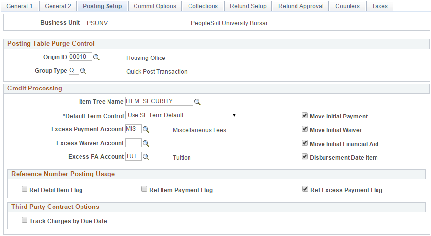

Access the Posting Setup page ().
Image: Posting Setup page
This example illustrates the fields and controls on the Posting Setup page. You can find definitions for the fields and controls later on this page.
Field or Control |
Definition |
| Default Term Control |
Select a value on which to base the term. The values are:
QUICK_POST_TBL Purge Control
Student Post (Quick Post) and Corp Post transactions are recorded in the Quick Post table. These entries can be consolidated into posting groups using the Purge QUICK_POST_TBL process. The options in this group box create entries in the Group Control record that enable you to easily track Student Post transactions.
Field or Control |
Definition |
| Origin ID |
Select the origin ID that you want the system to use when consolidating transactions into posting groups. |
| Group Type |
Select the group type that you want the system to use when consolidating transactions into posting groups. |
Credit Processing
Set the conditions that you want the system to use when credits (payments) are posted on an account.
Field or Control |
Definition |
| Item Tree Name |
Select the name of the item type tree that contains all of the item types that you use for transactions. This tree also controls item type security. |
Select how you want to determine the term that the system uses as the default if a charge or payment is entered without specifying a term. Note: Values for this field are delivered with your system as translate values. Do not modify these values in any way. Any modifications to these values require a substantial programming effort. Warning! Your selection of a default term control can affect how payments are processed. When either of the enrollment term selections are used, the actual term value may vary from student to student. The actual term value used becomes the value of the current term for payment processing. Values are: Last Enrollment Term: Select if you want the default term to be based on the student's most recent completed term of enrollment. Most Current Enrollment Term: Select if you want the default term to be based on the student's most recent term of enrollment, whether completed or not. Use SF Term Default: Select if you want the default term to be based on the term value that you defined in SF Term Default setup. |
| Move Initial Payment |
Select to move all payments in excess of charges to the account specified for excess payments. If the option is not selected, excess payments show as a credit balance on the charge account. |
| Excess Payment Account |
Select a default account that you want to use for payments that are received in excess of charges. |
| Move Initial Waiver |
Select to move all waivers in excess of charges to the account specified for excess waivers. If this option is not selected, excess waivers show as a credit balance on the charge account. |
| Excess Waiver Account |
Select a default account that you want to use for waivers that are posted to an account in advance of charges. This feature can also be used as an option for waivers that are posted in excess of charges. Warning! Waivers should rarely, if ever, be applied to a student's account other than through the tuition calculation process. Waivers posted using the Student Post or Group Post processes may not be able to be adjusted properly. |
| Move Initial Financial Aid |
Select to move all financial aid payments in excess of eligible charges to the account specified for excess financial aid. If this option is not selected, excess financial aid payments show as a credit balance on the charge account. |
| Excess FA Account (excess financial aid account) |
Select a default account that you want to use for financial aid that is posted to an account in excess of eligible charges. |
| Disbursement Date Item |
Select if you want the system to display each disbursement of a financial aid award in a single term (same item type) as a separate line item on a student's account. Also, selecting this option enables the system to identify specific disbursements in the event that an adjustment is required. For example, if a direct loan requires more than one disbursement in one term, selecting this check box identifies each disbursement with a unique date causing the system to recognize each as a separate entry. Clear this option to have all disbursements in a term roll into one line item. Note: After you begin posting financial aid awards, you should not change this setting. Warning! Financial aid disbursement does not correctly reverse disbursements when multiple disbursements exist within a term and you do not select the Disbursement Date Item check box. This can occur, for example, if multiple disbursements are in a single term and one or more of them is reduced. If you use batch disbursement to post the new disbursement amount, the posting process reverses the entire disbursement total for the term and then reposts only one of the disbursements in the term. In PeopleSoft Financial Aid, the disbursements look like they have been disbursed properly, but in Student Financials only one of the disbursements is properly posted, so the two applications are out of sync. If you use online disbursement to update the newly reduced disbursement amount, the same problem occurs. The online disbursement process reverses the entire award amount for the term and posts only the new reduced single disbursement amount. |
Reference Number Posting Usage
This group box provides additional options for the posting of debits and payments.
Field or Control |
Definition |
| Ref Debit Item Flag (reference debit item flag) |
Select to have the option of associating a reference number with charge items. For example, you could use a parking ticket number as a reference on a parking fine charge. Each charge item with a reference number is displayed separately on the Charge Detail page. |
| Ref Item Payment Flag (reference item payment flag) |
Select to have the option of associating a payment with a particular charge by using the reference number. For example, if you use a parking ticket number as a reference number on a parking fine charge, you can use that same ticket number to tie the payment to the specific charge. Note: The Ref Debit Item Flag check box must be selected for you to use the Ref Item Payment Flag option. |
| Ref Excess Payment Flag (reference excess payment flag) |
Select this option to have payments made in excess of a particular charge applied to other charges with the same reference ID. Note: The Move Initial Payment check box must be selected for you to use the Ref Excess Payment Flag. |
Third Party Contract Options
This group box provides an additional option for Third Party Contract functionality.
Field or Control |
Definition |
| Track Charges by Due Date |
Select this check box if you want to be able to track the student's due and billing date in the Third Party Contract process. The check box is cleared by default. |

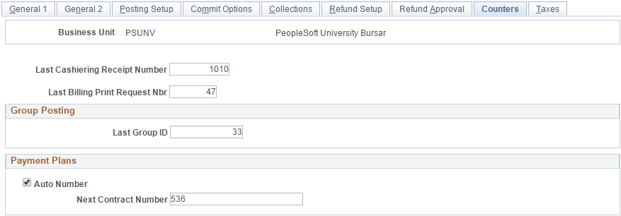

Access the Counters page ().
Image: Counters page
This example illustrates the fields and controls on the Counters page. You can find definitions for the fields and controls later on this page.
With the exception of payment plans, the counter number fields on this page automatically display the last number used. You can specify a number with which you would like the sequence numbering to begin. For example, if you want cashiering receipt numbers to begin at 1,000, enter the number 999 in the Last Cashiering Receipt Number field. The system automatically assigns the number 1,000 to the first receipt produced and increments all receipts by 1 thereafter.
Field or Control |
Definition |
| Last Cashiering Receipt Number |
If you want to change the starting point of the numbering sequence for cashiering receipts, enter a number that is one less than the number that you want to begin with. |
| Last Billing Print Request Nbr (last billing print request number) |
If you want to change the starting point of the numbering sequence for billing requests, enter a number that is one less than the number that you want to begin with. |
Group Posting
Field or Control |
Definition |
| Last Group ID |
If you want to change the starting point of the numbering sequence for posting group ID numbers, enter a number that is one less than the number that you want to begin with. |
Payment Plans
Field or Control |
Definition |
| Auto Number |
Select if you want the system to automatically generate sequential contract numbers for payment plan contracts. |
| Next Contract Number |
If you want to change the starting point of the numbering sequence for payment plan contract numbers, enter the contract number that you want to begin with. Unlike the previous counters, the Next Contract Number field displays the next number in the sequence. |

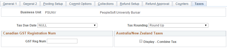

Access the Taxes page ().
Image: Taxes page
This example illustrates the fields and controls on the Taxes page. You can find definitions for the fields and controls later on this page.
Field or Control |
Definition |
| Tax Due Date |
Select a Tax Due Date option to control when taxes that are associated with charges are considered due. Options are: Charge Due Date: Select to make taxes due on the same date as the corresponding charge. Charge Effective Date: Select to make taxes due on the date that the corresponding charge becomes effective. This date may be different from the due date of the charge. Null: Select if you do not want the system to automatically assign a due date. This setting leaves open the option of assigning a due date at a later point (for example, through the Billing process). This is the default setting. Posting Date: Select to make tax charges due immediately on the date that the corresponding charge is posted. |

| Tax Rounding |
This option controls how taxes are adjusted at the half-cent point. Different taxing authorities have different rules for how adjustments must be made. Determine the requirements for your institution before selecting an option. Rounding affects only tax amounts that are calculated to the exact half-cent point. Options are: No Rounding: Select to truncate the calculated tax amount to the full-cent value. This option effectively eliminates any fraction of a cent. For example, 3.769 USD would be truncated to 3.76 USD. Fractions are never rounded up. Round Down: Select if you want taxes that calculate to the half-cent point or less to be reduced to the nearest full-cent value. For example, 3.765 USD would be reduced to 3.76 USD. Round Up: Select if you want taxes that calculate to the half-cent point or more to be increased to the nearest full-cent value. For example, 3.765 USD would be increased to 3.77 USD. Student Financials rounds based on the third decimal place of a number. |
Canadian GST Registration Num
Field or Control |
Definition |
| GST Reg Num |
Enter the GST (Goods and Services Tax) registration number that is assigned to this business unit. The system uses this value for any receipts and invoices that are specifically designed to include the GST registration number when GST is assessed. |
Australia/New Zealand Taxes
Field or Control |
Definition |
| Display − Combine Tax |
Select to display transactions with tax included (summed). The default setting (check box cleared) displays taxes as a separate line item. |
