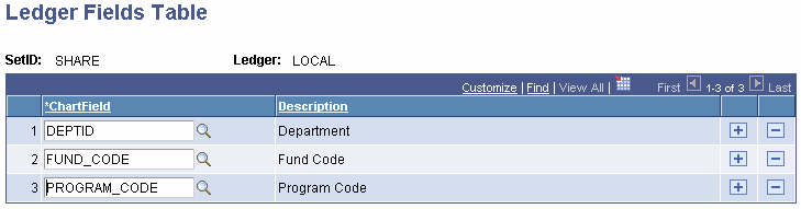

Access the Ledger Fields Table page ().
Image: Ledger Fields Table page
This example illustrates the fields and controls on the Ledger Fields Table page. You can find definitions for the fields and controls later on this page.
This page is not available if Oracle Financials is selected in the Financial System group box on the SF Installation page.

| ChartField |
Select the database field name that represents a valid ChartField. |
