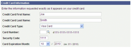

Image: Electronic Payment Test page (1 of 4)
This example illustrates the fields and controls on the Electronic Payment Test page (1 of 4). You can find definitions for the fields and controls later on this page.

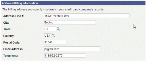

Image: Electronic Payment Test page (2 of 4)
This example illustrates the fields and controls on the Electronic Payment Test page (2 of 4). You can find definitions for the fields and controls later on this page.

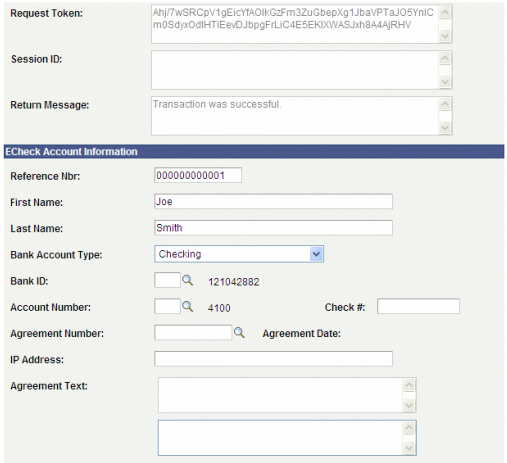

Image: Electronic Payment Test page (3 of 4)
This example illustrates the fields and controls on the Electronic Payment Test page (3 of 4). You can find definitions for the fields and controls later on this page.
