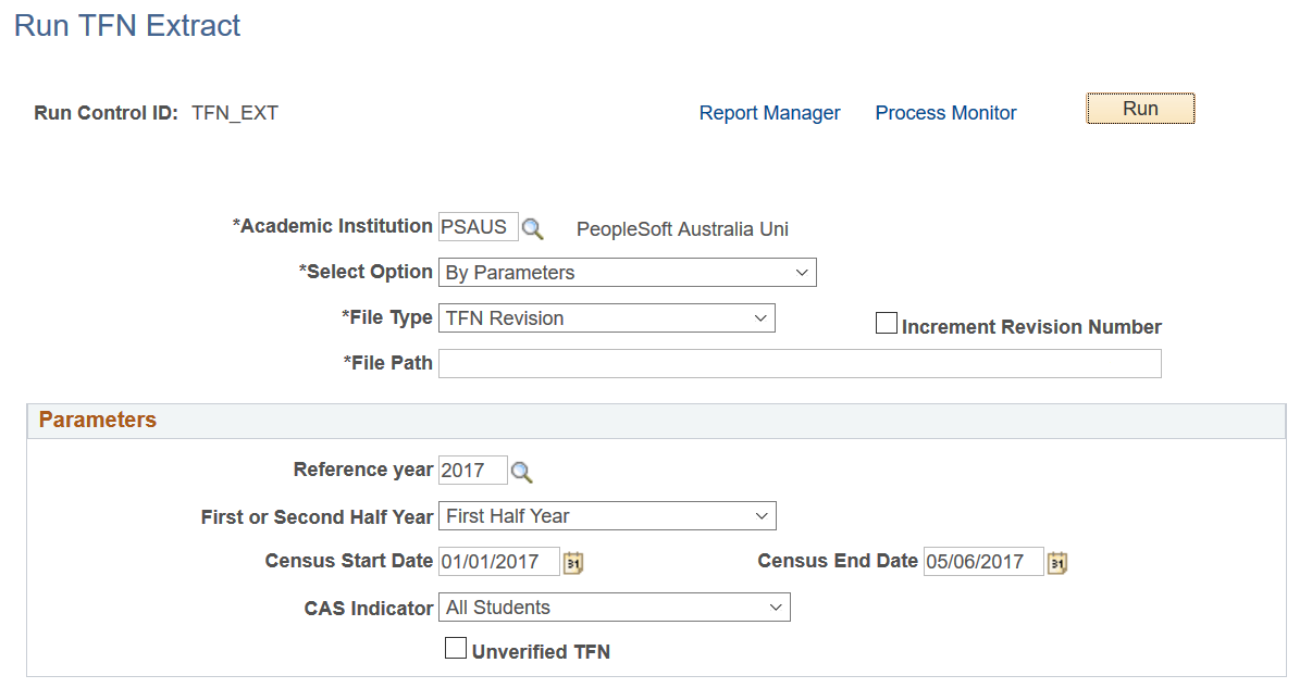

Access the Run TFN Extract page ().
Image: Run TFN Extract page
Extract student TFN data using parameters, population selection or student IDs.
Field or Control |
Definition |
| Select Option |
Select an option by which to extract the TFN data—parameters, population selection, or student ID. Based on the selected option, the system prompts you for further details.
| File Type |
Select whether to generate a TFN Revision (TR) or TFN Lookup (TL) file. |
| File Path |
Enter a location to save the generated TFN file. |
| Increment Revision Number |
Select to increment the Revisions Submission Number on the Reporting Setup page after the process completes successfully. |
| Unverified TFN |
Select the check box to extract information only for unverified TFN numbers. |
