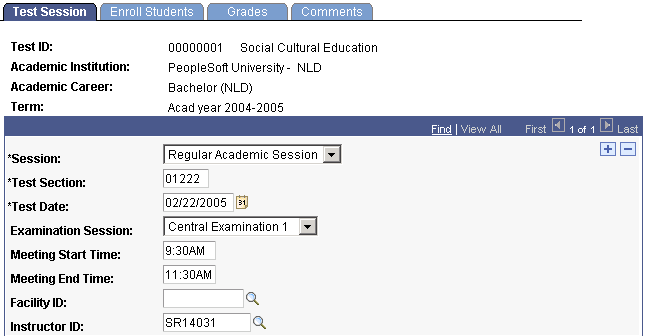

Access the Test Session page ().
Image: Test Session page
This example illustrates the fields and controls on the Test Session page. You can find definitions for the fields and controls later on this page.
Field or Control |
Definition |
| Test Section |
Enter the test section code. This field is alphanumeric and can be up to 5 characters long. |
| Test Date |
Enter the date of the test session. |
| Examination Session |
Select the examination type. |
| Meeting Start Time and Meeting End Time |
Enter the start and end times for the test session. |
| Facility ID |
Enter a facility ID. Facility IDs are defined on the Facility Table page. |
| Instructor ID |
Enter the ID for the instructor facilitating the test session. |
