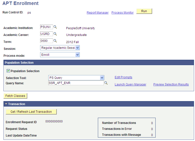

Access the APT Enrollment page ().
Image: APT Enrollment page
This example illustrates the fields and controls on the APT Enrollment page. You can find definitions for the fields and controls later on this page.
The following values determine the keys that are used to fetch rows from the CLASS_TBL for this run and also determine the values that are used as prompts when defining the student population. If the run control values are Institution: PSUNV, Term: 0690, then the Population Selection query (or a manually entered list of students) must use the same values to select rows from APT (SSR_APT_SCHD).
Field or Control |
Definition |
| Academic Institution |
Select an Institution value. |
| Academic Career |
Select an Academic Career value. This value is required for prompting against the TERM_TBL (which is keyed by INSTITUTION, ACAD_CAREER and STRM). |
| Term and Session |
Select a Term and Session value. These values, along with the Institution value are used to fetch rows from the CLASS_TBL. |
APT Enrollment can be used to create (and process) enrollment requests or to save classes so that they are accessible for the student to enroll in, using Self Service.
Field or Control |
Definition |
| Process Mode |
Enroll: Select this mode to create an Enrollment Request (one request per run) which can be processed directly from this component, or retrieved, adjusted if necessary and posted using the Block Enroll component. Schedule Builder: If you select this mode, classes are saved directly to the SSR_REGFORM table where the student can retrieve them using the self-service Schedule Builder component to complete the enrollment process. |

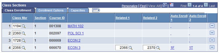

Image: APT Enrollment Class Sections grid
Here is an example of the Class Sections grid:
Results are ordered by CLASS_SECTION. The process returns the lowest CLASS_SECTION value when multiple sections of a class exist. The process also evaluates the CLASS_COMPONENT parts of the selected section for required related components and returns any related sections (related 1 and 2). Here again the lowest section number is used for each related component.
Class Enrollment tab:
Field or Control |
Definition |
| Class Nbr |
Displays the CLASS_NBR value for the lowest CLASS_SECTION value with a CLASS_TYPE of E. You can select a different value if other sections are available. |
| Class Description |
Click the Class Description link (SUBJECT and CATALOG_NBR) to access the Class Detail page and view enrollment capacity and totals. |
| Related 1 and Related 2 |
Displays the CLASS_NBR value for the lowest CLASS_SECTION value for related components (a maximum of two, neither of which is auto-enroll). You can select different values if they are available. |
| Auto Enroll 1 and Auto Enroll 2 |
Click the links to access the Class Detail page and view enrollment capacity and totals. |

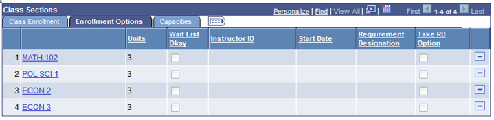

Enrollment Options tab:
Image: APT Enrollment Class Sections grid – Enrollment Options tab
This example illustrates the fields and controls on the APT Enrollment Class Sections grid – Enrollment Options tab.
Field or Control |
Definition |
| Units |
Displays the unit value for the class. The value is editable for variable unit/credit classes. |
| Wait List OK |
When this check box is selected, the enrollment engine attempts to wait list students in this class if the class is closed at the time when enrollment is processed. When the class(es) are processed by the enrollment engine, the User ID that creates the Run Control is checked for access to the Wait List OK function. If the User ID does not have this access, the wait list option is ignored and a closed class error is returned. |
| Instructor ID |
You can edit this field if the class allows a choice of instructor. |
| Start Date |
You can edit this field if the class is scheduled in the OEE session. |
| Take RD Option |
You can edit this field if the Requirement Designation is optional. |

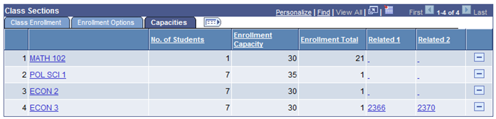

Capacities tab:
Image: APT Enrollment Class Sections grid – Capacities tab
This example illustrates the fields and controls on the APT Enrollment Class Sections grid – Capacities tab.
Field or Control |
Definition |
| No. of Students |
Displays the total number of students in the selected population that need to be enrolled in the section of this course. |
| Enrollment Capacity |
Displays the enrollment capacity of the selected enrollment section. |
| Enrollment Total |
Displays the current enrollment total for the selected enrollment section. |

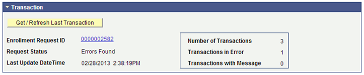

Viewing Transaction Data
View APT Enrollment transaction data in the Transaction group box:
Image: APT Enrollment Transaction group box
This example illustrates the fields and controls on the APT Enrollment Transaction group box. You can find definitions for the fields and controls later on this page.
Field or Control |
Definition |
| Get / Refresh Last Transaction |
Click to retrieve the last enrollment request generated for this Run Control/User ID (can be used when the same Run Control is used for multiple runs). |
| Enrollment Request ID |
Displays the last enrollment request generated for this Run Control/User ID. An enrollment request is generated only when the Process Mode is Enroll. |
| Request Status |
Displays the status of the Enrollment Request (ENRL_REQ_HEADER.ENRL_REQ_PROC_ST). |
| Last Update Date Time |
Displays the time stamp value for the enrollment request (ENRL_REQ_HEADER.DTTM_STAMP_SEC). |
| Number of Transactions |
Displays the number of Enrollment Request detail rows (the number of Student/Class number combinations within the request). |
| Transactions in Error |
Displays the number of Enrollment Request detail rows that resulted in error (ENRL_REQ_DETAIL.ENRL_REQ_DETL_STAT = E). |
| Transactions with Message |
Displays the number of Enrollment Request detail rows that were processed successfully but for which an informational message was returned (ENRL_REQ_DETAIL.ENRL_REQ_DETL_STAT = M): for example, a student was added to a wait list or a student was enrolled in a class but the repeat check process returned a repeat warning. |

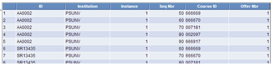

The Population Selection (or Manual Entry) populates a result table (SSR_APT_ENR_TGT) with the following values returned from the APT Item Attempt table for items where the item type is COURSE and where the APT Item Schedule (SSR_APT_SCHD) term (and session if the enrollment cohort uses session level) match the run control term value:
Image: APT Enrollment Result Table example
This example illustrates the fields and controls on the APT Enrollment Result Table. You can find definitions for the fields and controls later on this page.
Field or Control |
Definition |
| Institution and Instance |
Displays the Institution and Instance values for the selected instance. |
| Seq Nbr |
Displays the SSR_APT_ATT.SSR_APT_ITEM_SEQ value. |
| Offer Nbr |
Displays the Course Offering value if it exists (not required). |
