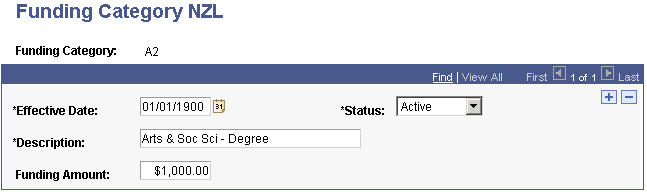

Access the Funding Category NZL page ().
Image: Funding Category NZL page
This example illustrates the fields and controls on the Funding Category NZL page. You can find definitions for the fields and controls later on this page.
Field or Control |
Definition |
| Funding Category |
When setting up your funding categories, enter the two-digit alphanumeric code for the funding category. The first digit is the academic category (A-Z) and the second digit is the degree status (1-5). The degree status variations are:
| Funding Amount |
Enter the MoE funding amount for this funding category. |

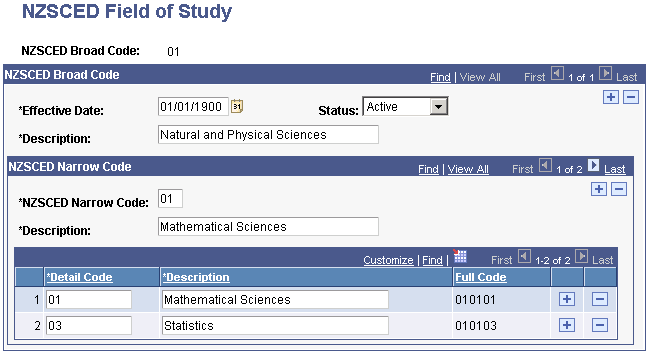

Access the NZSCED Field of Study page ().
Important! The NZSCED broad, narrow, and detail codes are defined by the MoE.
Image: NZSCED Field of Study page
This example illustrates the fields and controls on the NZSCED Field of Study page. You can find definitions for the fields and controls later on this page.
Field or Control |
Definition |
| NZSCED Broad Code |
When setting up the field of study codes, enter the NZSCED broad code for this field of study. |
| NZSCED Narrow Code |
Enter the NZSCED narrow codes for the broad code. Insert rows to enter all of the narrow codes for this broad code. |
| Detail Code |
Enter the NZSCED detail codes for the narrow code. Insert rows in the grid to enter all of the detail codes for this narrow code. |
Note: You attach the combination of broad, narrow, and detail code to a course at the catalog level. For example, the code 010103 is the NZSCED code for Statistics.
