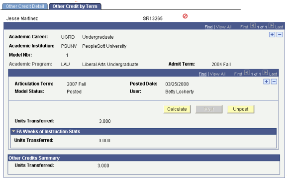

Access the Other Credit by Term page ().
Image: Other Credit by Term page
This example illustrates the fields and controls on the Other Credit by Term page. You can find definitions for the fields and controls later on this page.
The units of the internal equivalent course appear in Units Transferred field in the FA Weeks of Instruction Stats (financial aid weeks of instruction statistics) group box.

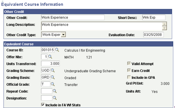

Access the Equivalent Course Information page (click the Edit Equivalent Course button on the Other Credit Detail page).
Image: Equivalent Course Information page
This example illustrates the fields and controls on the Equivalent Course Information page. You can find definitions for the fields and controls later on this page.
Other Credit
Use the Other Credit group box to enter information about other credit.
Field or Control |
Definition |
| Other Credit |
Enter a description of the other credit. |
| Short Desc (short description) |
Enter a short description of the other credit. |
| Long Description |
Enter a long description of the other credit. |
| Other Credit Type |
Select the type of other credit. Values for this field are delivered with your system as translate values. You can modify these values. |
| Evaluation Date |
Enter the evaluation date of the other credit. |
| Clear Credit |
Click to clear the fields in the Other Credit group box. This button works for new data that you are entering and data that you have previously saved in the fields. |
Equivalent Course
Use the Equivalent Course group box to enter internal equivalent course information.
