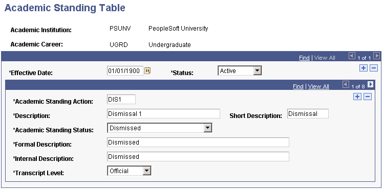

Access the Academic Standing Table page ().
Image: Academic Standing Table page
This example illustrates the fields and controls on the Academic Standing Table page. You can find definitions for the fields and controls later on this page.
Creating academic standing action codes is a precursor to defining academic standing rules. Therefore, to define academic standing action codes, you must think about how they can be used in the rule sets for the academic standing process.
For example, suppose that students at your institution receive two warnings before being placed on probation and the warnings are of different degrees. That is, if students receive a second warning it is more severe. In this case you would define two different academic standing action codes for warnings because you want to distinguish them. Later, you define rule details for these codes, and for all other academic standing action codes defined on this page.
Note: If you want to inactivate an academic standing action code that is attached to an academic standing rule, delete the code where it is attached to the rule on the Academic Standing Rule page and enter a status of Inactive on the Academic Standing Table page.
Field or Control |
Definition |
| Academic Standing Action |
Enter an academic standing action code. |
| Academic Standing Status |
Select an academic standing status. Values for this field are delivered with your system as translate values. You can modify these values. The delivered values are Dismissed, Good Standing, Probation, and Subject to Dismissal. You can have many academic standing action codes that contain the same academic standing status. For example, DIS1, DIS2, and DIS3 can all contain a status of Dismissed. |
| Formal Description |
Enter a formal description. If you choose to have the academic standing action appear on a student's transcript, the system displays the formal description. |
| Internal Description |
Enter a description to be used for internal purposes only. |
| Transcript Level |
Select the transcript level on which you want the academic stranding to print. Values for this field are delivered with your system as translate values. These translate values can be modified. The delivered values are Deg Prog (degree progress), Not Print, Official, Stdnt Life (student life), and Unofficial. |

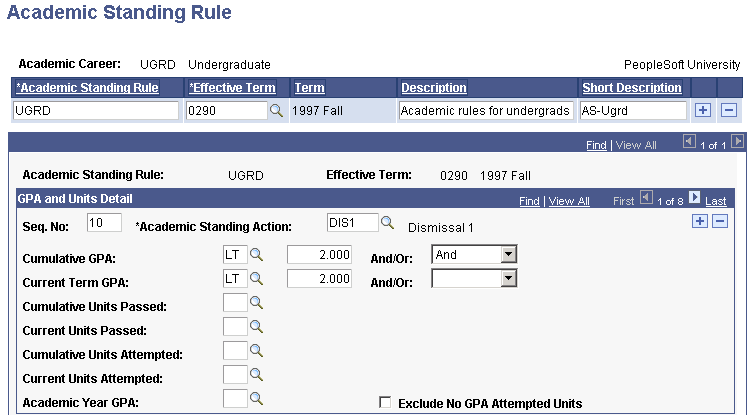

Access the Academic Standing Rule page ().
Image: Academic Standing Rule page (1 of 2)
This example illustrates the fields and controls on the Academic Standing Rule page (1 of 2). You can find definitions for the fields and controls later on this page.
Image: Academic Standing Rule page (2 of 2)
This example illustrates the fields and controls on the Academic Standing Rule page (2 of 2). You can find definitions for the fields and controls later on this page.
Field or Control |
Definition |
| Academic Standing Rule |
Enter an alphanumeric code that identifies this academic standing rule code. |
| Effective Term |
Select the effective term of the rule. When the system uses the rules that you define here in the Academic Standing process, it verifies that the rule is effective within the term for which the process is running. |
| Seq No (sequence number) |
Enter the sequence number order in which the system evaluates the rule. Sequence your rules from the most severe academic standing action to the least severe. After a student's academic standing matches one academic standing rule, the Academic Standing process applies the academic standing action code to the student's record and moves on to the next student. |
Enter the academic standing action code that you want the system to post to students' records if the rule is satisfied. The system populates the Academic Standing page with the appropriate code once you run the academic standing process. |
| Cumulative GPA, Current Term GPA, Cumulative Units Passed, Current Units Passed, Cumulative Units Attempted, Current Units Attempted, and Academic Year GPA |

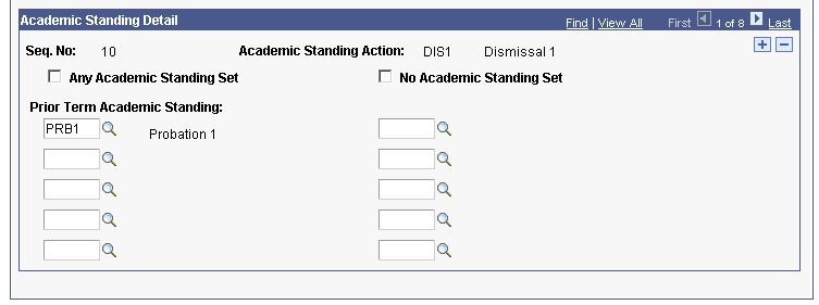

| Any Academic Standing Set |
Select if it does not matter what academic standing action codes students can have on their records prior to this rule evaluation. The other fields on the page become unavailable for input. |
| No Academic Standing Set |
Select if the student's record should possess no academic standing action code. |
| Prior Term Academic Standing |
Select any academic standing code that the student must possess in a prior term to satisfy the rule. For example, in the preceding page shot, the student must possess the PRB1 (probation 1) code in addition to meeting the grade point average requirements. |
Note: By selecting the No Academic Standing Set check box and selecting prior academic standing values, the academic standing rule reads as an OR statement. For this rule to apply, the student's record must either possess the academic standing values for the prior term that you select, possess no academic standing action code, or have no prior term for comparison.

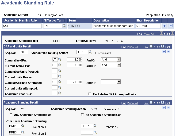

The Sequencing of Rule Details
Image: Example of academic standing rules (1 of 4)
This example illustrates the Academic Standing Rule page for the Dismissal 2 action:
On this page:
The system evaluates this rule second because the sequence number is 20, and one other rule detail line with a lower sequence number exists.
The cumulative grade point average and current grade point average requirements are higher than that of the sequence number 10 rule, but can be the same or less than that of subsequent rules.
You can have the same grade point average requirement, for instance, for probation and dismissal. Differentiate these actions by the prior academic standing codes students must possess.
Students must possess one of the academic standing action codes listed in the Prior Term Academic Standing Value field in addition to satisfying the grade point average rules, to satisfy the Dismissal 2 rule detail.

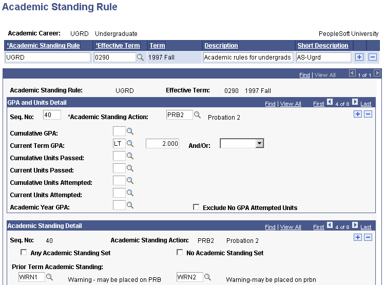

Image: Example of academic standing rules (2 of 4)
This example illustrates the Academic Standing Rule page for the Probation 2 academic standing action code:
On this page:
The rule detail line is evaluated fourth by the system because the sequence number is 40, and three other detail lines with lower sequence numbers precede it.
The system posts the Probation 2 academic standing action code on student records when they possess a current term grade point average less than 2.000 in conjunction with one of the academic standing action codes selected.
Students must possess one of the academic standing action codes listed in the Prior Term Academic Standing Value field in addition to satisfying the grade point average rules, to satisfy the Probation 2 rule detail.

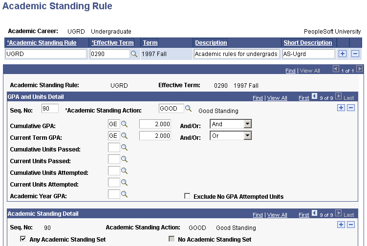

Image: Example of academic standing rules (4 of 4)
In your rules, the last rule detail line is one for Good Standing.
This example illustrates the Academic Standing Rule page for this rule:
On this page:
This detail line is evaluated last because the sequence number is 90, and all other rule detail lines precede it possessing lower sequence numbers.
Students must possess a cumulative grade point average and a current-term grade point average that is greater than or equal to 2.000.
In addition, the student may possess any academic standing action codes stipulated on the Academic Standing Rule page.

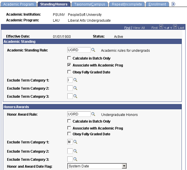

Access the Standing/Honors page ().
Image: Standing/Honors page
This example illustrates the fields and controls on the Standing/Honors page. You can find definitions for the fields and controls later on this page.
Academic Standing
Field or Control |
Definition |
Select the academic standing rule for this academic program. |
| Calculate in Batch Only |
Select to calculate academic standing through a background process using the Academic Standing/Honors Awards page. If you select this check box, the system does not calculate academic standing dynamically, such as when you post grades. Clear to have the system call the academic standing process when posting or changing a grade on the Quick Enrollment or Enrollment Request pages, and when posting a grade on the Grade Roster page. The academic standing process inserts an updated academic standing row, viewable on the Academic Standing page of the Term History component, except when a student's class is graded with a grade that count towards GPA and then later changed to a non-GPA grade. In such a scenario, you must manually update the student's academic standing on the Academic Standing page. |
| Obey Fully Graded Date |
Select to calculate academic standing only when grades are posted on or later than the fully graded date. The system does not calculate academic standing if this check box is selected and grades are posted before the student's fully graded date. You define the default fully graded date on the Academic Term Calendar 3 page in the Academic Calendar component and an individual student's fully graded date on Term Control Dates page in the Term Activation component. |
| Associate with Academic Prog (associate with academic program) |
Select to associate the academic standing rule only with students in this academic program. This is especially useful for students who might be in multiple academic programs; you might want to apply different academic standing rules with different academic programs. If you do not select this check box, the system associates the academic standing rule with the student's academic career. |
| Exclude Term Category 1, Exclude Term Category 2, and Exclude Term Category 3 |
Select the terms in which the system does not calculate academic standing. Values for this field are delivered with your system as translate values. You can modify these values. |
Honors/Awards
Field or Control |
Definition |
| Honor Award Rule |
Select the honor award rule for this academic program. |
Select to calculate the honors and awards in batch through the Academic Standing/Honors Awards page. If you select this check box, the system does not calculate honors and awards dynamically, such as when you post grades. |
Select to calculate honors and awards only when grades are posted on or later than the fully graded date. The system does not calculate honors and awards if the Obey Fully Graded Date check box is selected and grades are posted before the student's fully graded date. You define the default fully graded date on the Academic Term Calendar 3 page in the Academic Calendar component and an individual student's fully graded date on Term Control Dates page in the Term Activation component. |
Select to associate the honor/award rule only with students in this academic program. This is especially useful for students who might be in multiple academic programs; you might want to apply different honor/award rules with different academic programs. If you do not select this check box, the system associates the honor/award rule with the student's academic career. |
Select the terms in which the system does not calculate honors/awards. Values for this field are delivered with your system as translate values. You can modify these values. |
| Honor and Award Date Flag |
Select the date type that the system posts to students' records for their honors and awards. Values for this field are delivered with your system as translate values. You can modify these values with some programming effort. Values are System Date and Fully Graded Date. |
