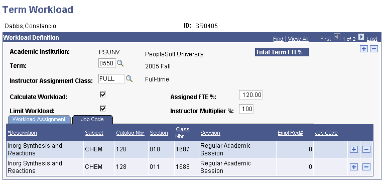

Job Code Tab
Select the Job Code tab.
Image: Term Workload page: Job Code tab
This example illustrates the fields and controls on the Term Workload page: Job Code tab. You can find definitions for the fields and controls later on this page.
Field or Control |
Definition |
| Session |
Displays the session name (if applicable) and is derived from the Meetings page. Sessions are a simple way to divide a term into multiple periods for offering courses. |
| Empl Rcd# (employee record number) |
Relates job information to instructors for reporting purposes. The system displays a warning message if the FULL_PART_TIME value on the job does not coincide with that same field value on the instructor assignment class record related to the instructor assignment class on the Term Workload page. |
| Job Code |
Displays the value specified on the Accommodations page for a particular employee record. |
