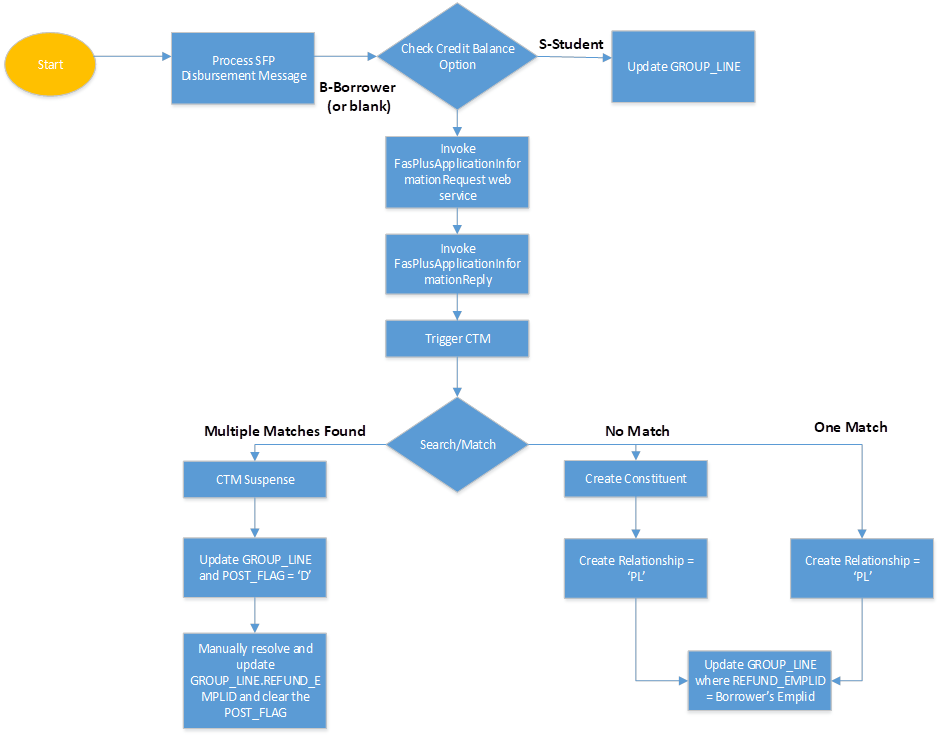

The CS-SFP pull process
for FasDisbursementInformationEvent looks at the refund indicator and if a borrower exists, the FasPlusApplicationInformationRequest web service is invoked to retrieve the biographic and demographic
information of the borrower. The FasPlusApplicationInformationReply service provides the information to CS. The Constituent Transaction
Management (CTM) framework is triggered. After the borrower has been
found or created, a relationship between the student and borrower
is created where the Relationship value is PL (PLUS loan
borrower).
Image: Plus loan disbursement process

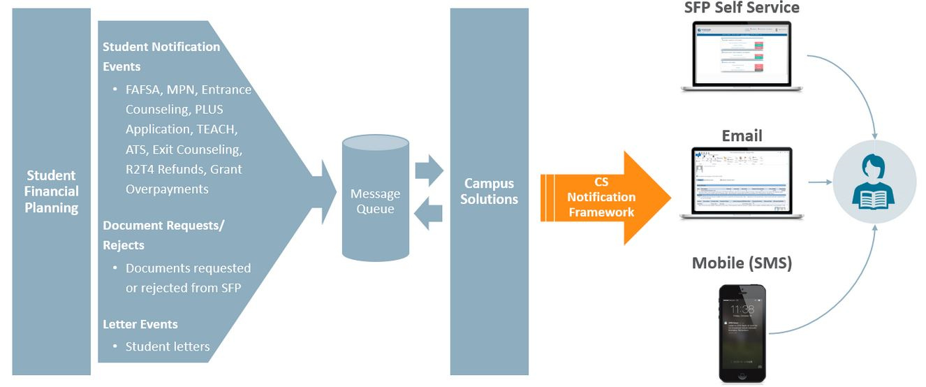

SFP Notification Events will be pushed to the CS Notification Framework and CS Batch Notification will generate the email, as shown in this diagram.
Image: SFP Notifications through the CS Notification Framework

These SFP message events contain notification data:
FasStudentNotificationEvent
FasDocumentRequestEvent
FasDocumentRejectedEvent
FasLetterInformationRequest (web service)
FasLetterInformationReply (web service)
FasStudentLetterListRequest (web service)
